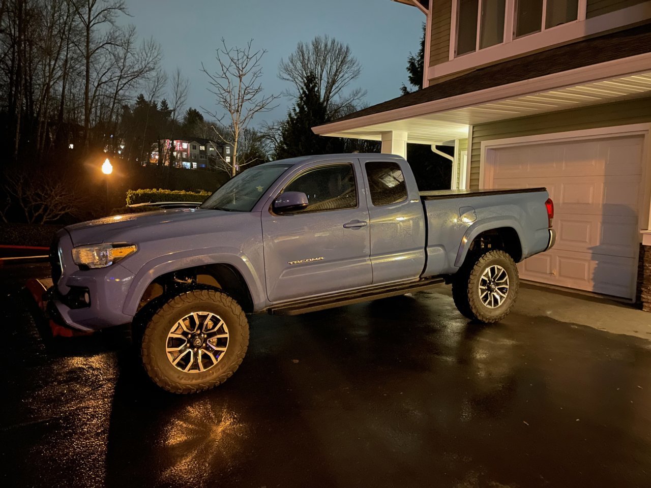

    I installed mine over the summer and this is how the rear shocks look in mid November with the cover making contact with the body. The mounting is a bit strange in regards to how they’re angled and tried orienting them different ways too. I have a second gen and this is driver side looking from back to front.

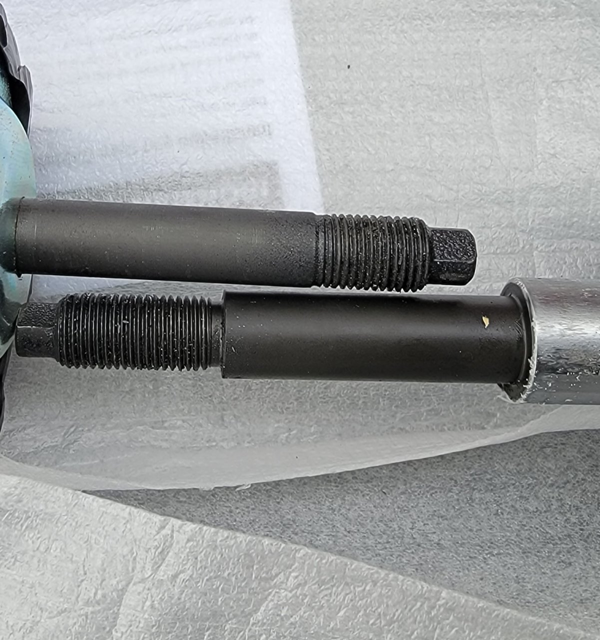

    I was planning to install mine tomorrow and started going through pieces to make sure it was all good, but came across this issue. These are the shafts on the top of my two rear shocks they sent me. It's as if they didn't finish machining one of them. The rock/chip guard, bushings, and washers will not slide over the larger diameter. The model stamped on the tubes of both are the same.
    Since I have free helpers lined up for tomorrow, do you more knowledgeable folks think I would be alright to install the leaf springs with factory shocks until this is rectified by them? It won't be too difficult for me to replace just the rear shocks on my own. I have the Constant load front shocks and constant load leafs.
    I already called and emailed them, but I know due to the holidays and the weekend I am probably a few days out from their response.

    Now that’s a new one… maybe try their Instagram too? I think they’re usually active on there.
    With it being constant in the back, I wouldn’t recommend it. Mainly because I don’t think the stock shock will have enough up and down movement for the leafs.

    Took me a minute to see it. That effing sucks. :(

    That's a bummer, my front bumper, rock sliders, and skid plates were supposed to arrive Thursday so I wanted my suspension taken care of before then. I currently ride around with a bed cover and a bed rack so it sits a hair below level as it is. If I installed just the front suspension I'd be riding around with a Carolina squat. I considered giving it a shot with some leafs pulled so it would act more like the performance load.
    I sent them a message on Instagram like you suggested, but I dont expect anything back until Monday. I'm not faulting them for enjoying the holidays/weekend. I'm also not considering it anything more than a product that slipped through the cracks for the time being.

    I rode around with just the front for about a week or two. UPS lost one of the leaf packs and I went ahead and did the front anyway. I didn’t have any issues and it wasn’t too bad. Depending on what it’s set at, it might look more level than squatted, or barely.

    So I just wanted to give a status update now that the holidays are over. I reached out to Ironman multiple ways, but found the best to be the chat on their website that pops up after you've been there a few minutes. After asking me to verify a few things, they agreed to ship out another rear shock to me 2nd day air. They also let me know I don't need to send the wrong one back so I can use all the other pieces as spare parts.
    I went ahead and installed everything else this past weekend since I had my help and my alignement scheduled. The lift definitely came out higher than 2.5" especially in the rear since I have some weight there with the bed cover and bed rack and the old springs were sagging. It shouldn't take me very long to install the rear shocks at this point.
    Complications I personally came across - removing the UCA bolts of course. Had to bend the pinch welds a little on both sides, passenger side more. On the passenger side I had to remove a bracket for one of the AC lines and I wouldn't have been able to get it without a 2nd set of hands.
