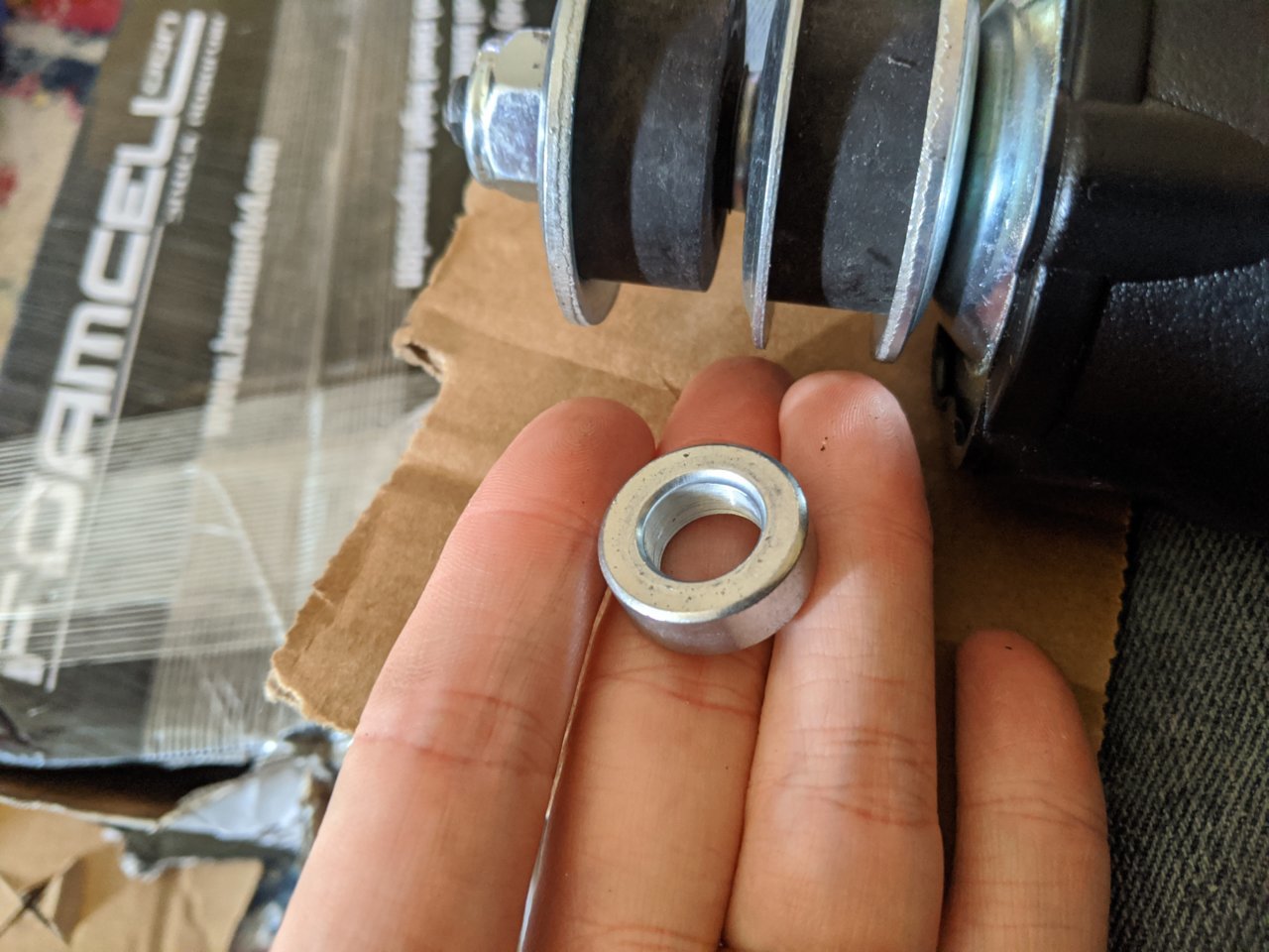

    Maybe for another vehicle? That’s the only thing I can think of…

    22
    Jonathan
    2021 Silver Sky Tacoma DBCB
    Nothing yet
    The bushing kit they use is for several different vehicles and it is probably for one of those.

    While not meant for it, they might fit the bolt on the carrier bearing, if you need an extra spacer in there. Though, if you need the spacer kit and those as spacers you’ll need longer bolts.
