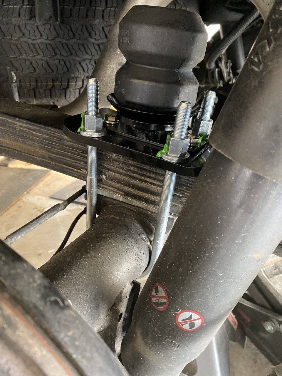

    Has anybody gotten the Timbren U-bolt flip kit with the Constant load leaf springs? Is the ubolt kit it comes with long enough?
    hyrule_trd likes this.

    I do but not with the constant. Here is what mine looks like though
    LizardTacoma[QUOTED] likes this.

    Looks like there is enough thread leftover to cover any extra thickness on the constant load springs.

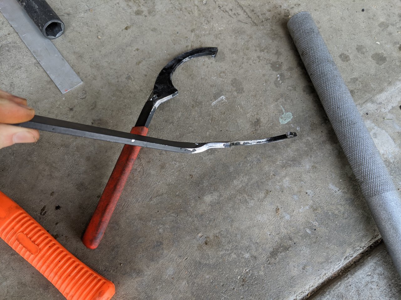

    So here's how she looks once all is said and done:

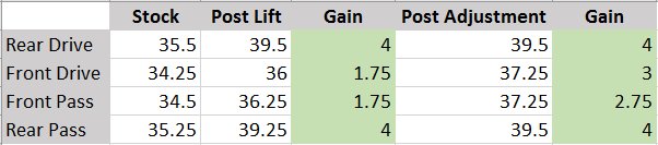

    I went with constant load front and rear. I removed one (third) leaf from the leaf pack. Current weight worth mentioning: Plate steel front bumper & reinforced camper shell. I initially ended up with exactly 4" of lift in the rear and 1.75" in the front. (after driving home ~100 miles with a ton of tools and the old suspension in the rear plus ~20 minutes of light wheeling at Hungry Valley on the way home for funsies :taco:)

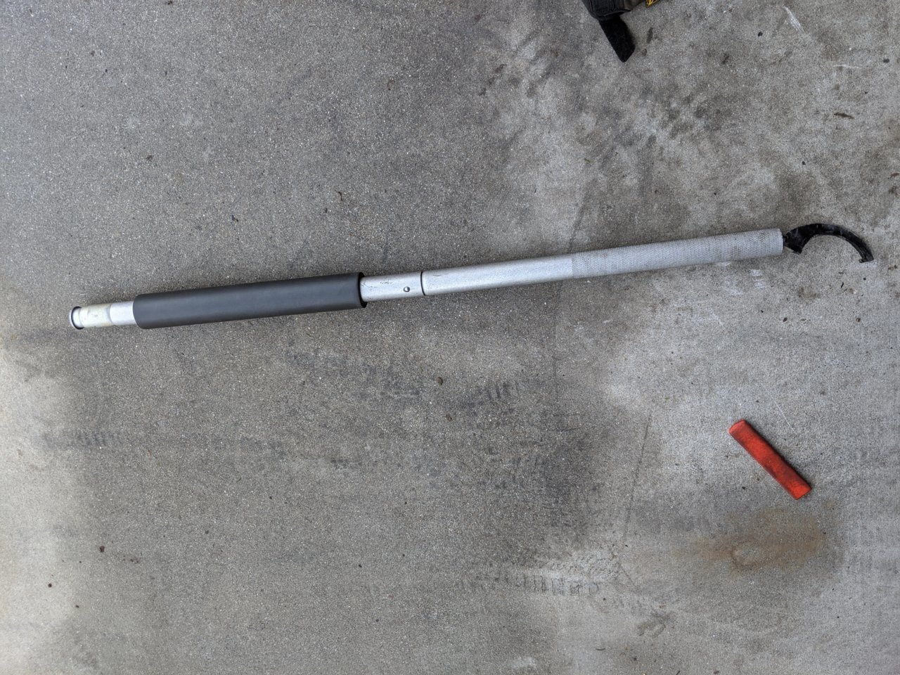

    I wanted to get the front up higher but obviously didn't want to take the shocks off and the compression tool from AutoZone doesn't fit these coils anyhow. I found if you unlink and swing the sway bar all the way forward you can use the spanner wrenches linked earlier in the thread to make adjustments on the truck.... albeit far from ideal and your mileage may vary. After dousing everything with a liberal coat of silicone spray, I was able to use to use a big persuader bar to get them to budge, and you can see what the spanner wrenches thought of my mechanical advantage. I had to keep stopping every couple turns to hammer the spanner back into shape. This system wouldn't be nearly as bad with a beefier spanner.
    But the important part is: It worked! :rofl:
    Once all was said and done I was able to get her level (I guess not level... but sans Taco lean) with a lift of 3" in the front and 4" in the rear -- pretty much exactly what I was after.
