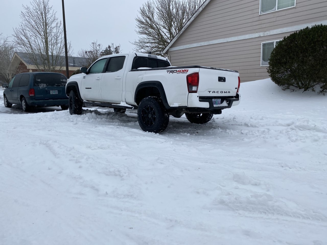

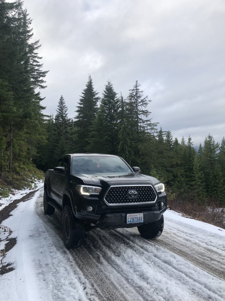

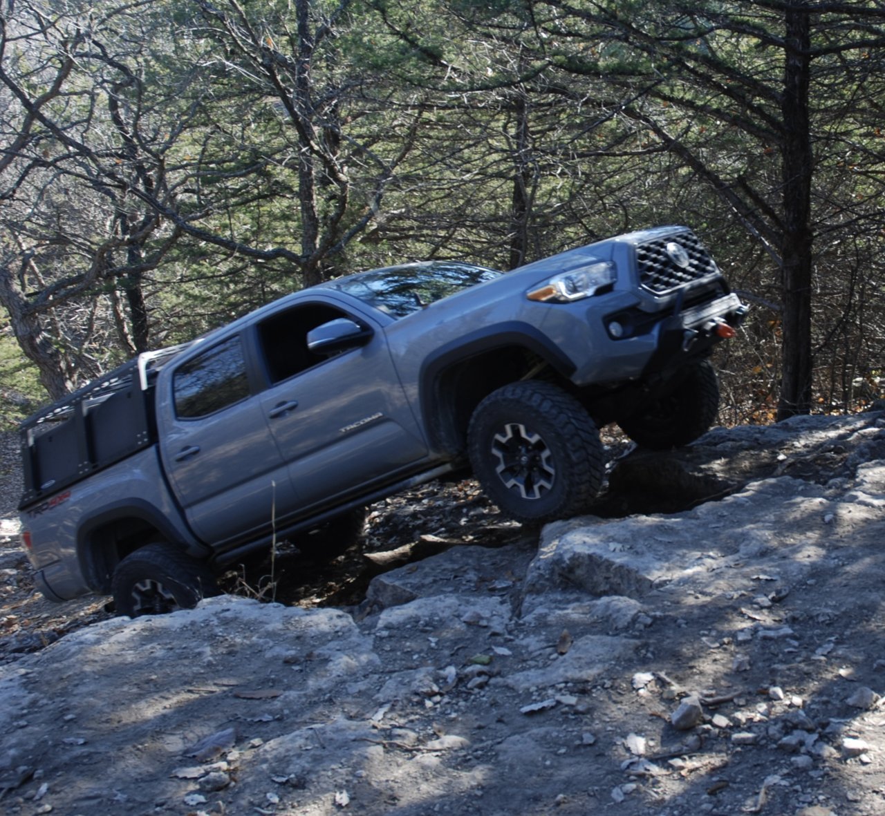

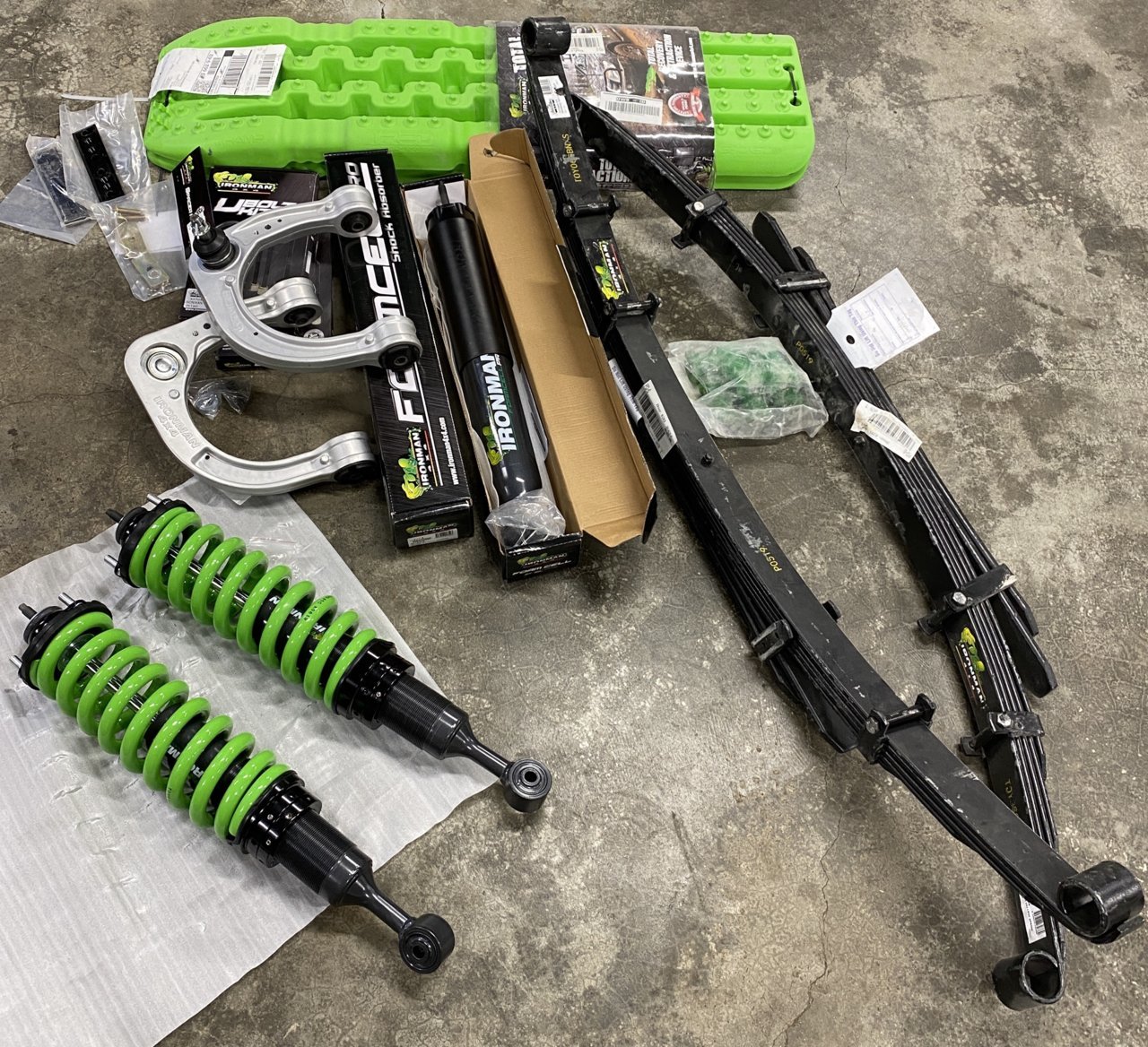

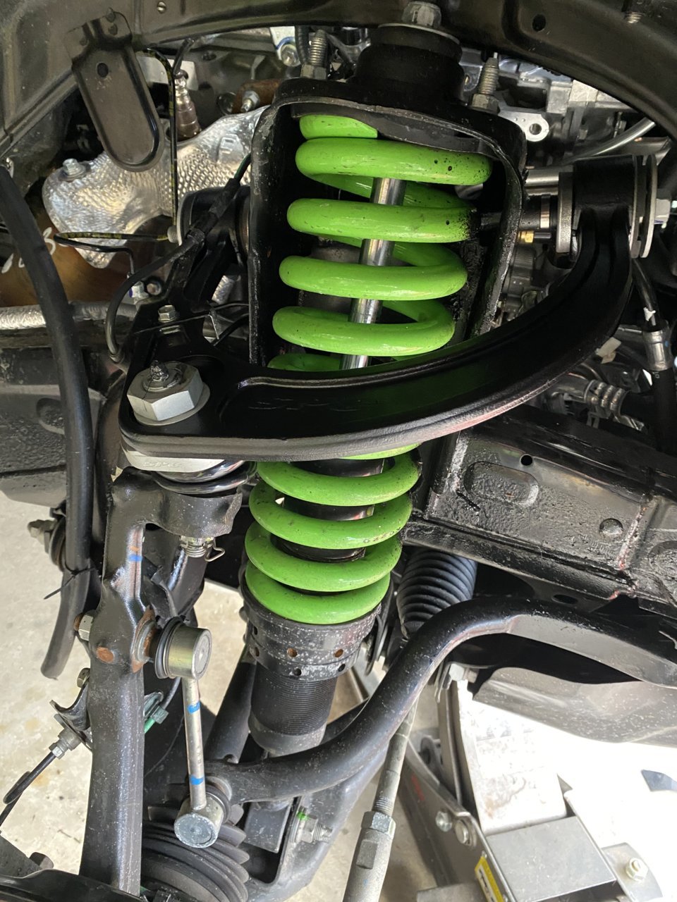

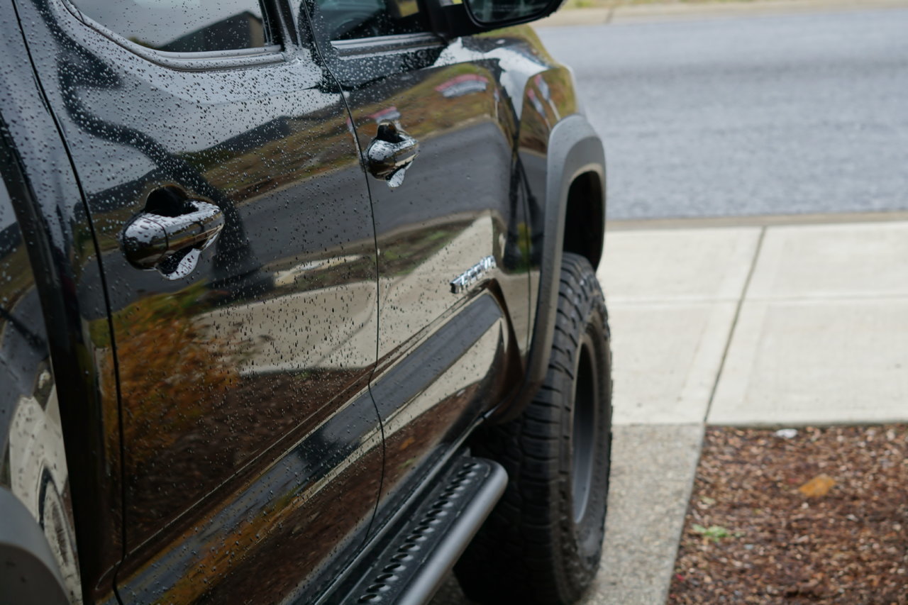

    The ironman 4x4 doesn't have a huge presence and when I did the research there was little to no content available with this brand. So, I decided to take my chances and hopefully lend a little bit of input for those considering.
    I've been holding out a little bit to review these as I wanted to get to test them out for about 1K miles, I have to say that I'm pretty pleased with the results to this point.
    I was able to settle in with a 2.8-3 in lift overall with the kit. Thus far, I have tested the suspension on forest roads at high speeds/situations with significant articulation and the ironman4x4 handled it flawlessly. I typically do quite a bit of camping, mountain biking and rock climbing....so as far as investing in a capable suspension I wasn't looking to break the bank and knew I wasn't going to need a super high performance set-up (king's, icon's or fox with res). So, this was a good mediation + I'm local to the ironman 4x4 HQ.
    Overall, it's given me exactly what I have asked of it and I'm very happy with the ride since it's my daily driver. It's stiffer than the OEM but in a better way. It's the right amount of cushy for me and feels better than (bilsteins 5100 i had on my '07 tacoma and trd pro suspension I had on my 2015 4runner).
    The only thing I was not crazy about was rusting on the leaf pack after a couple months, but upon further research I found to be normal, especially with the conditions I have been putting my truck through.
    Overall, I hope my experience continues to go well and will continue to document if my opinion changes. 9F6D1ED7-AAD4-4B08-93F0-0C854243FC9F.jpg4D25FA14-67A6-4848-8A7F-9D97743445B6.jpg85106B32-DB3A-4963-A22B-0607FA306395.jpgDSC01236.jpgDSC01237.jpgDSC01238.jpgIMG-2822.jpgIMG-3094.jpg9F6D1ED7-AAD4-4B08-93F0-0C854243FC9F.jpg 4D25FA14-67A6-4848-8A7F-9D97743445B6.jpg 85106B32-DB3A-4963-A22B-0607FA306395.jpg DSC01236.jpg DSC01237.jpg DSC01238.jpg IMG-2822.jpg IMG-3094.jpg

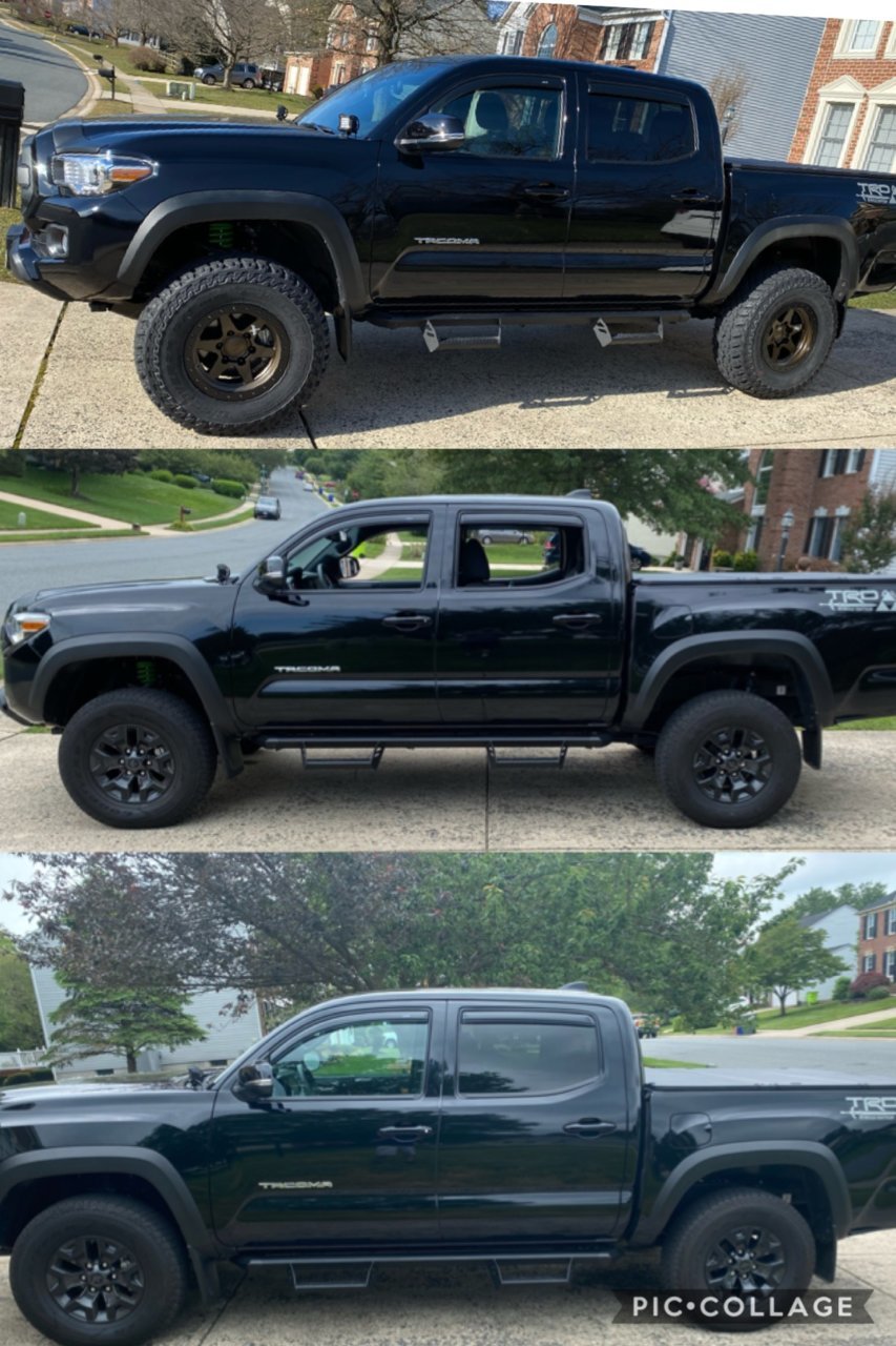

    Ironman Stage 1 Foam Cell Pro lift kit, 255/85/16 Cooper ST Maxx, SCS BR6 Wheels, SPC UCA, Heated seats, MESO TRD start button, Meso Total Tail v1, Meso V5 mirror white DRL turns, bed decal, ditch and hidden bumper lights, screen protech, RAV4 radio knobs, steering wheel anytime camera kit, dash cam, ECGS bushing, Timbren Active Off Road bump stops with Wheelers flip kit. 35% Xpel CS Ceramic Tint, KD Max Tune, SumoSprings front bump stops, RRW Sliders ‌ ‌ ▲ ▲‌ ▲
    The kit has treated me pretty well so far! A little stiff for the mall crawling around here but still much better than the OEM. I went with SPC uppers as well.

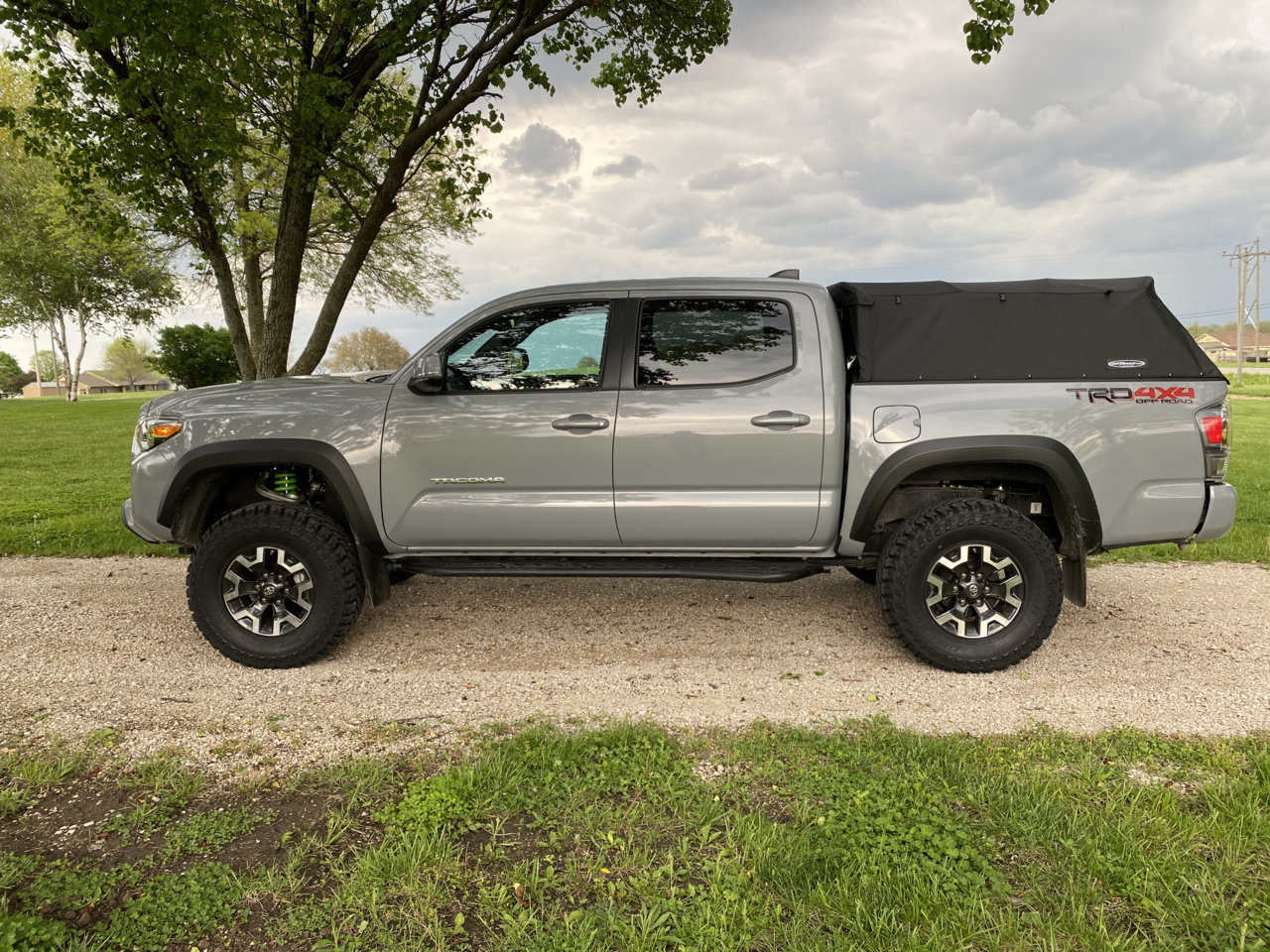

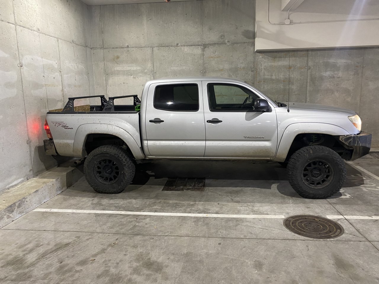

    I’ve had the Ironman FoamCell Pros Stage 2 with their UCAs for about a 12k miles. I opted for the performance front coils and standard leafs. As other have mentioned it netted me about 3” of lift and have performed great. Well above my expectations for the price point. Especially if you can get in on a 25% off sale plus their free shipping.
    53526819-0BD9-40A1-A252-04C6F8568DCB.jpg E7745E50-4E52-40A1-A732-8BE977E3773D.jpg 366BCEC4-8A35-431B-9893-322AE7E158D2.jpg

    What tires are you running in these pics? I ordered a 2.5” stage 2 foam cell pro and was just hoping a 265/75/16 ko2 won’t look too small in there. Whatever you have looks great. Thanks man
