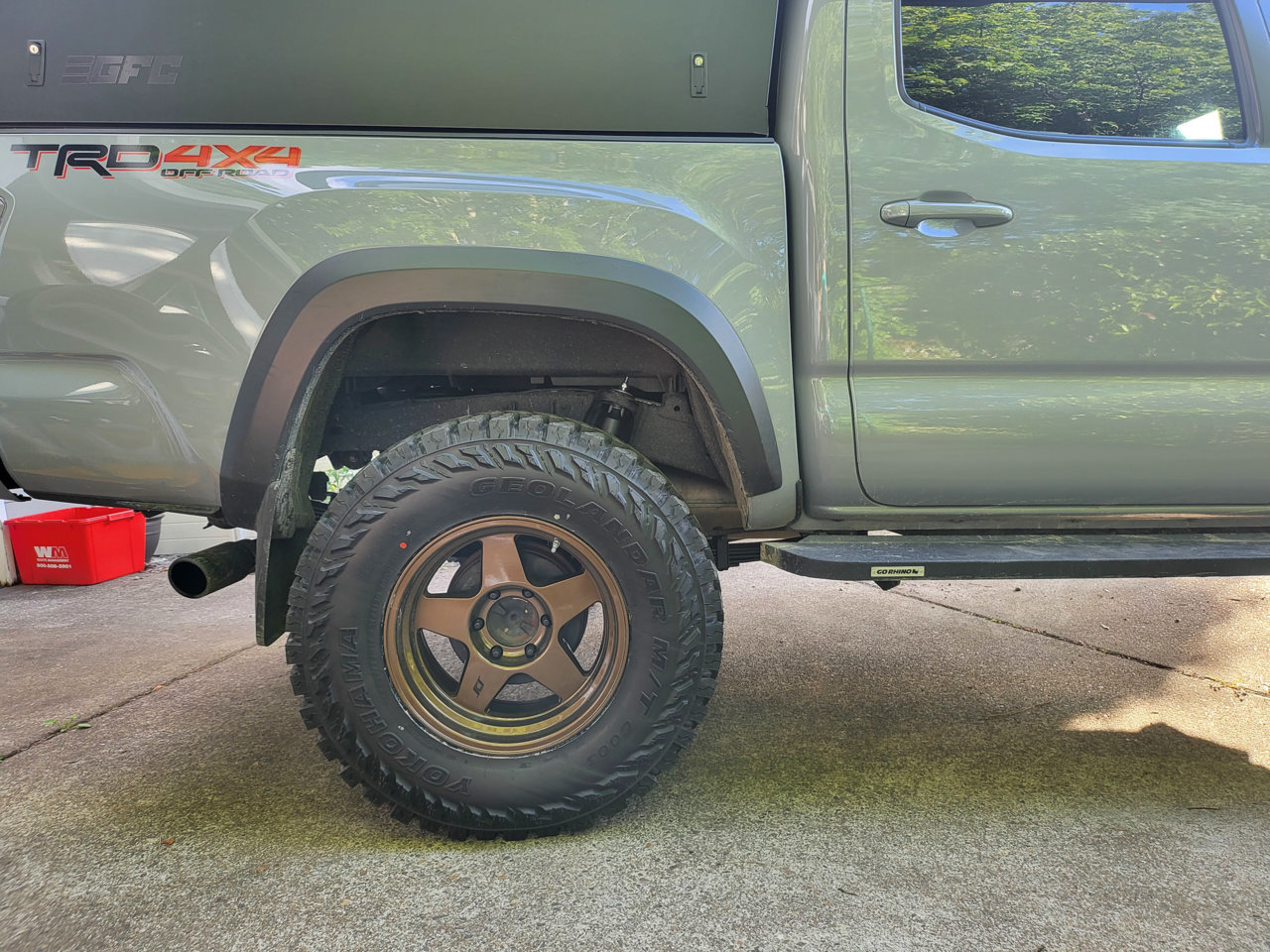

    Ironman constants, the heavy ones are very underrated. Some real world examples have them running at over 1,000 lbs with all leafs. I am running 600 lbs to the back, and I had to pull the 3rd leaf out from them. I researched the crap out of deavers 2,3 as well as other packs. These are the best bang for your buck, esp with 25% off sales and bundles.
    I'll be pushing around your weight as well and will keep the 3rd leaf off until I find a need. First pic is with 600lbs, second pic is with 300lbs.
    Edit, front suspension is set at 3", so 600lbs is pretty leveled (prob 3.2") so it looks like 600-800lbs at around 3", meaning with the 3rd leaf.....yeah.
