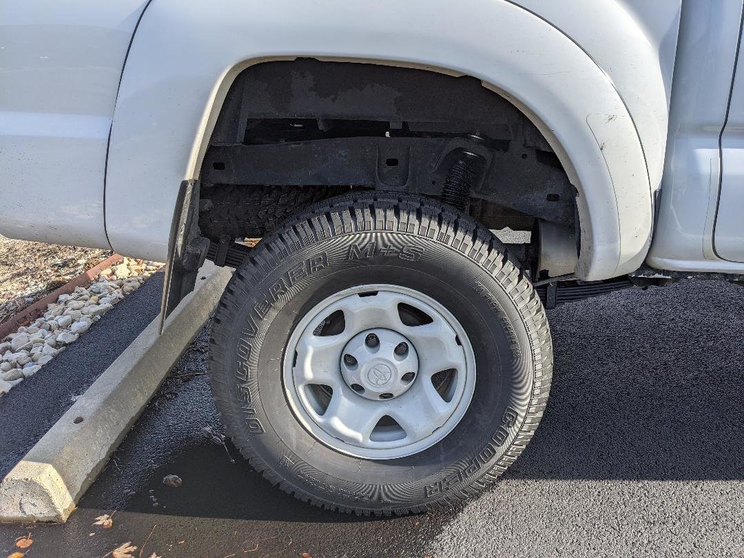

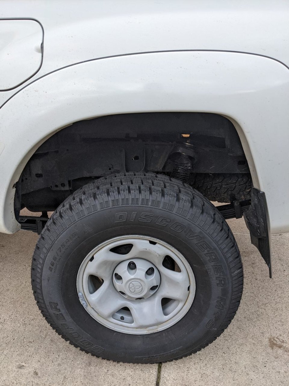

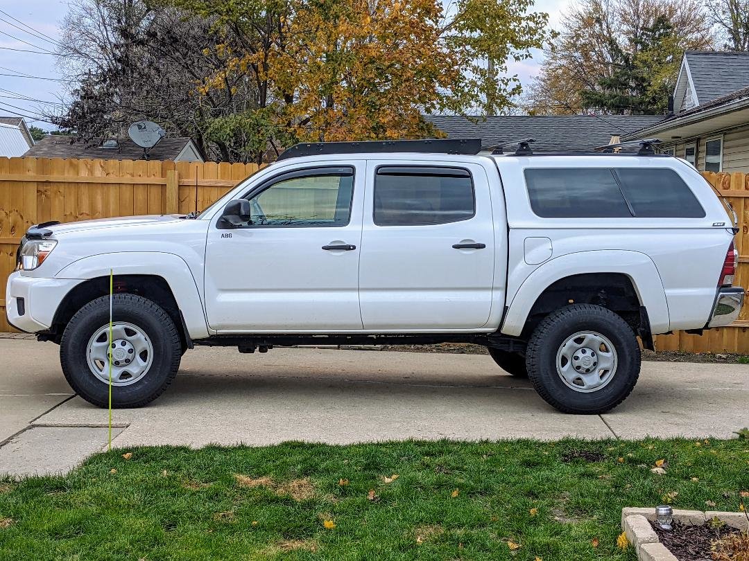

    After immediate install of this pack, the truck sat up almost 6 or more inches higher in the rear. Center cap to fender was 29". Disgusting driveline vibrations. It was unsafe to drive, although the rear ride was VERY nice and soft for my 10 miles of testing.

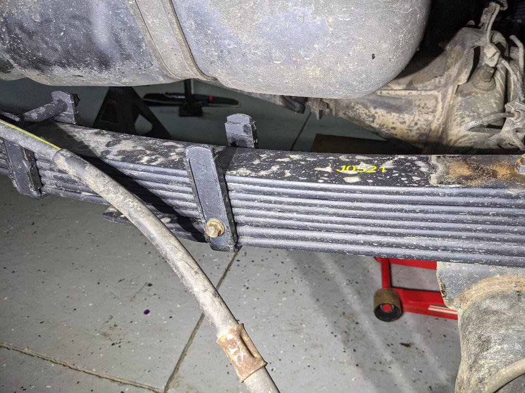

    After a very long weekend of frustration, research, math, and a chat with Ironman- we decided to remove the 3rd and 7th (overload) leafs. This was completed. Center cap to fender 24.75".The truck was a little more level, and looked much better. Unfortunately, there were still major driveline vibrations.

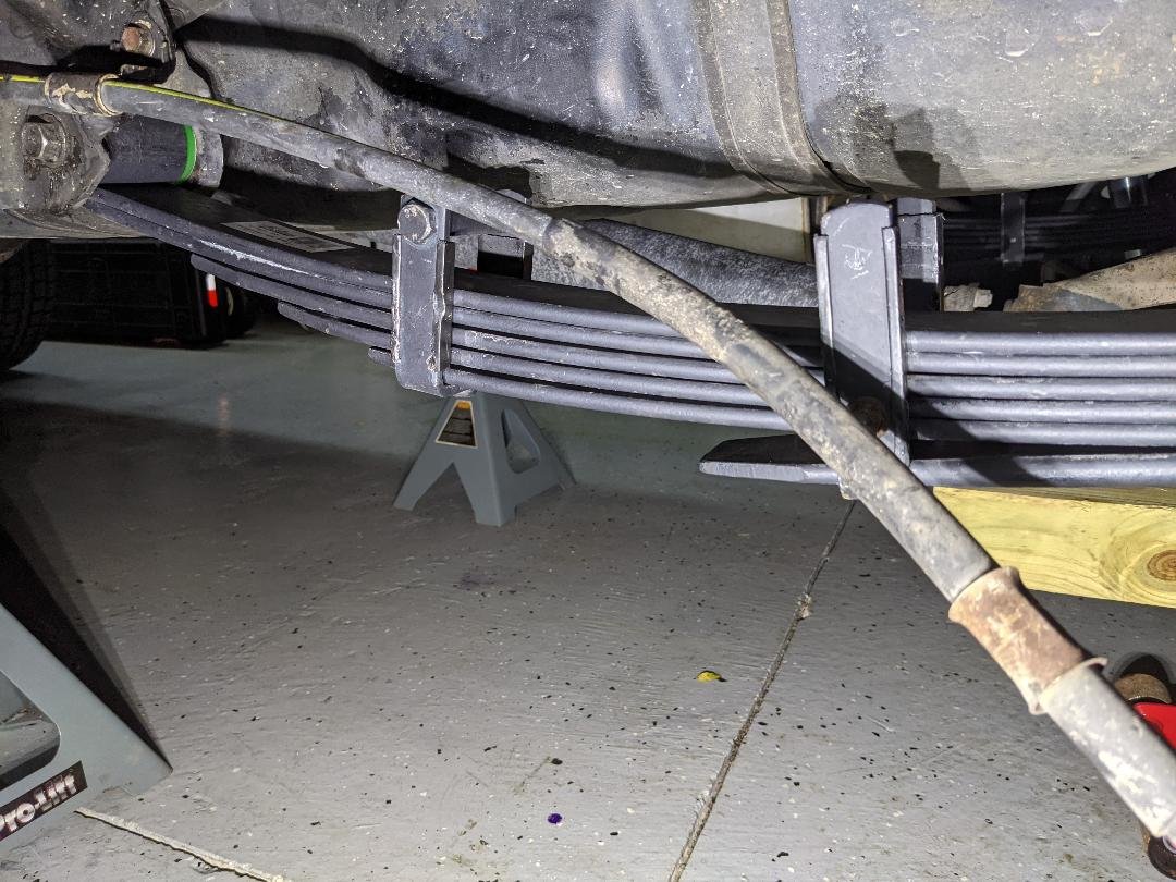

    3) Leaf Spring "clamps". Tried one, then two on each side. Following threads similar to: https://www.tacomaworld.com/threads/spring-clamp-solved-my-axle-wrap.228091/ Clamping every possible combination. Vibes Persisted.
    4) Leaf Spring Helper mounted front-side of spring, previous clamps removed. This is the best one yet. Vibrations still persist upon acceleration. https://www.tacomaworld.com/threads/goodbye-axle-wrap-mod.108316/
