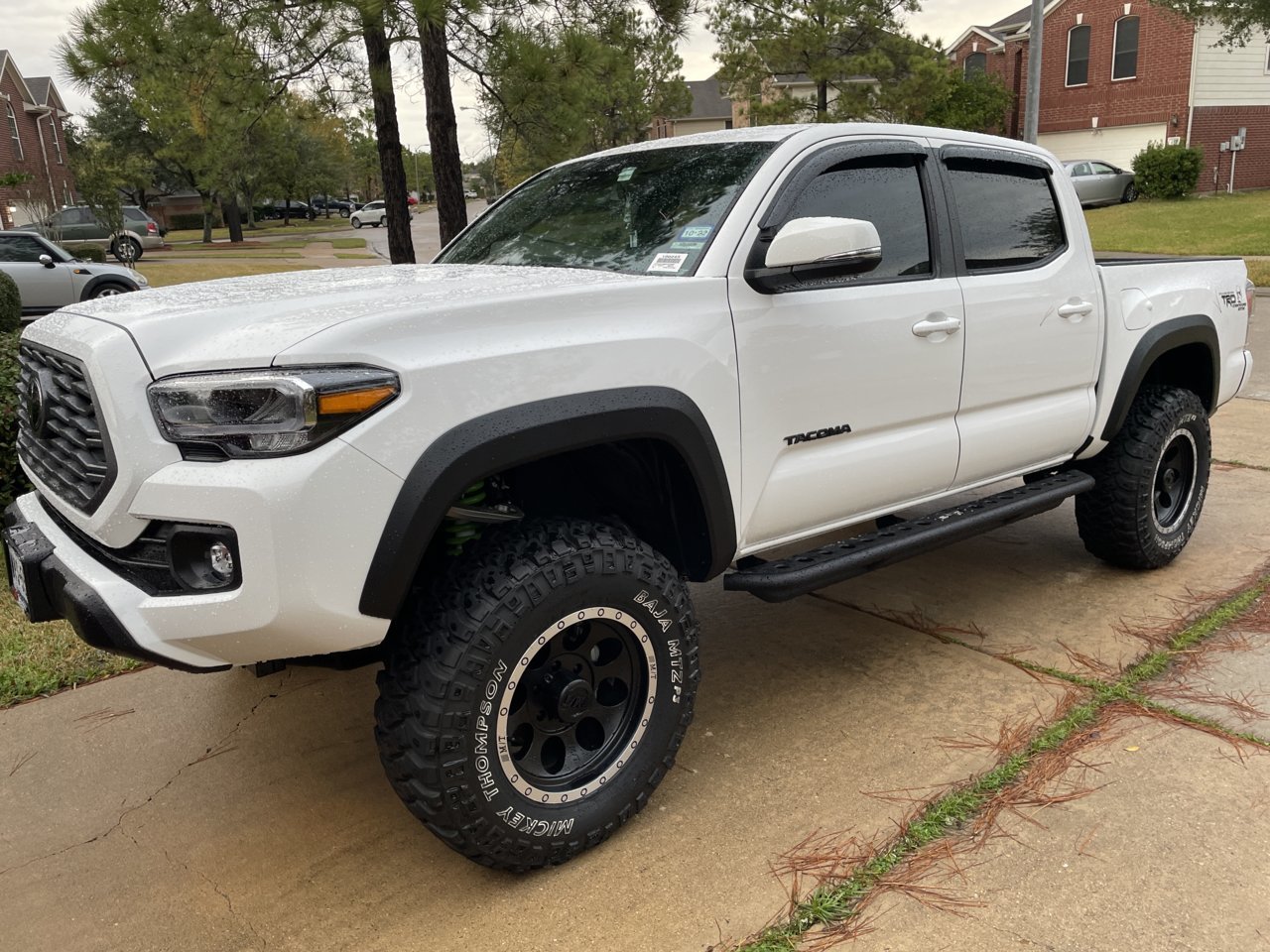

    Did a lift from Ironman Nitro gas stage 2 suspension kit on my TRD 4x4 OR 2021 at 1,067 miles, on the highway the ride is way better than my Tacoma 2019 which I traded in,it has 6112 Bilstein w/ ready lift 69-5531 kit,5100 rear/spc uca
    both of them are in 3” front 2.5 back on 285/70/17 mtz p3 MT,so far no vibration,squeaking will update on how it does off road.

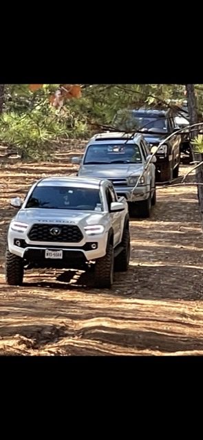

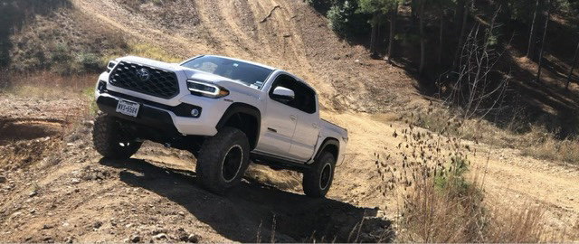

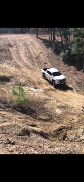

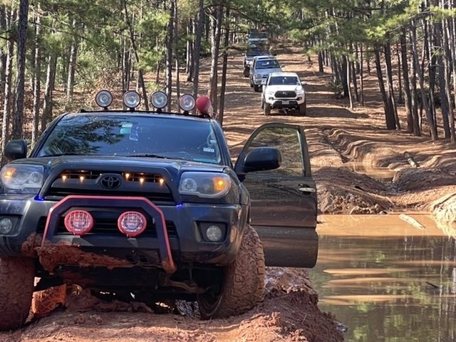

    Had a chance to hit Bastrop Tx trail with some friends and the suspension did really well....

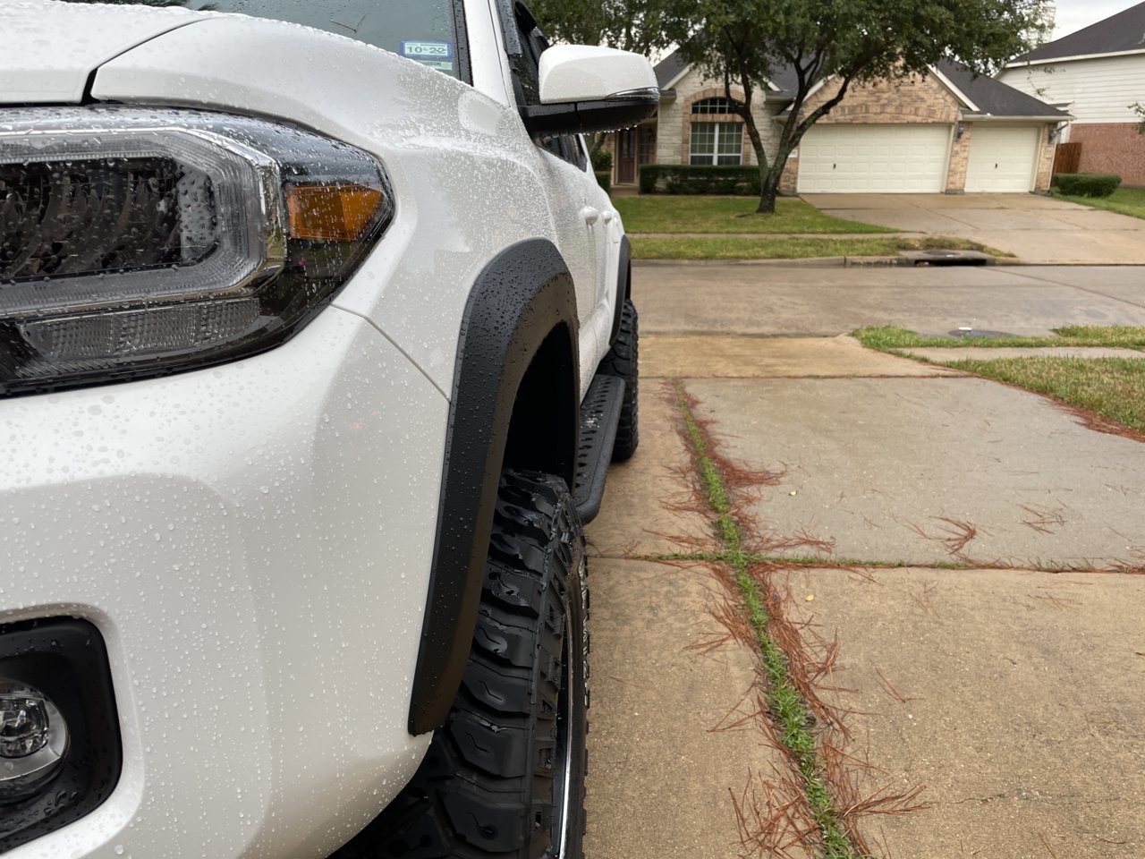

    @Boyettexan Hey man, I just bought this same lift for my 21 Tacoma. Also looking at the same specs - 285/70r17.
    Do you have any rubbing? Did you have to do a CMC? Lastly, what are your wheel specs? (Width / offset / Backspacing)?

    Looks really nice but I noticed your cv boots are not so happy . Both are rubbing bad . Just a heads up

    from Ironman i requested for 3inch lift in front and they put a little 1/2 spacer(silver ring in the bottom of the spring) and no rub,lift was installed at toyota dealer paid 20%extra from other shops dont want to void warranty,my rims has 17x9, -12 offset,4.5 backspacing.

    @Boyettexan wats the rub situation like? Did you have them do a cab mount chop? Assuming not, since it was dealer installed.

    mostly that i know on 33s or 285/70/17 dont require cab mount chop if you have 3inch lift, you might trim on the plastic but no cab chop
