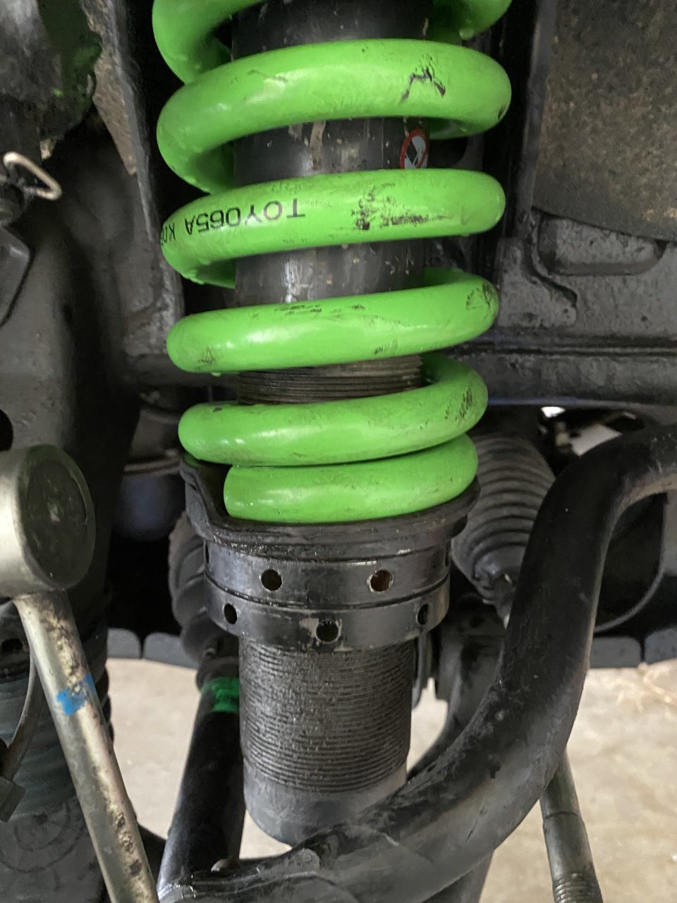

    Do you have measurements/pictures of how much you adjusted your preload down? I also just switched from E rated tires to C rated too but will go back to E rated once my son gets older.

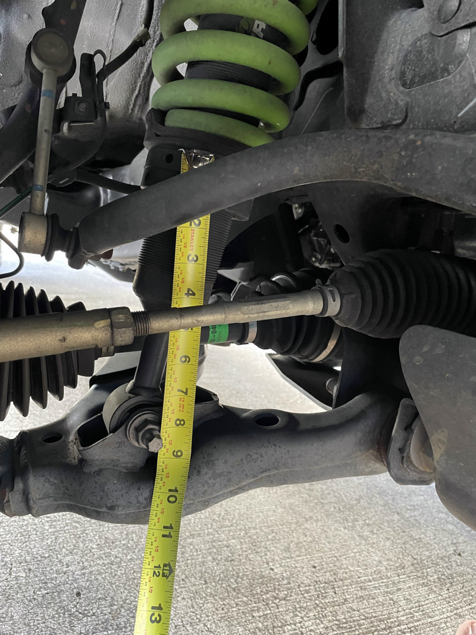

    I don’t think I have any pictures of measuring them but what I should have done was start at the same place as the B springs. I think I was anticipating them being compressed more with the added weight I had… or now that I think about it, I should have adjusted them lower to start out with since they are different heights.
    I have a few commutes to do but I’m going to drop them another 1/4-1/2”. I’ll measure what they currently are next time I go out.
    this pic was after I installed but before my first adjustment so they are much heigher here.

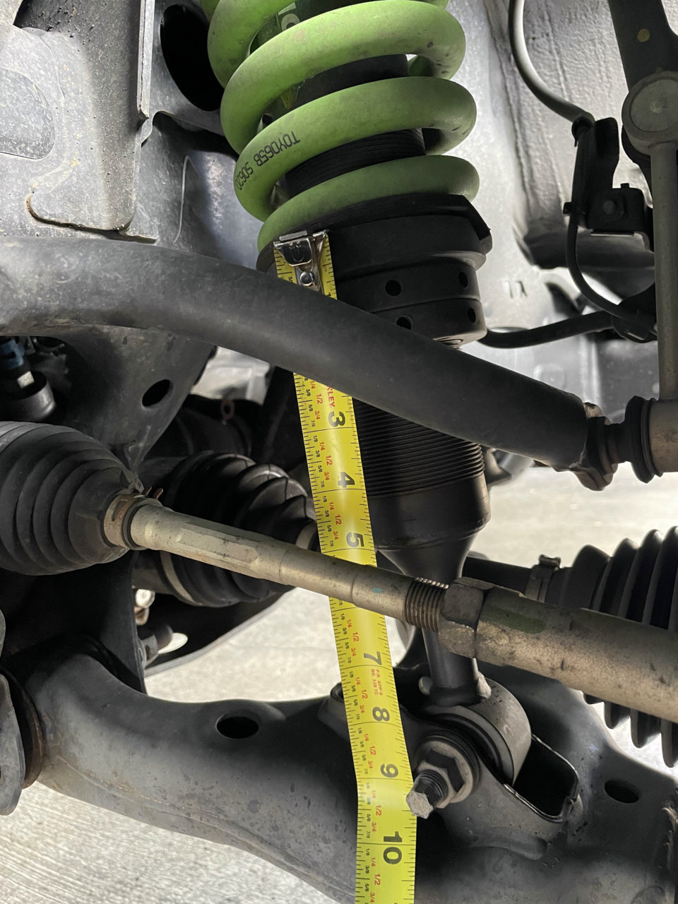

    I got around to adjusting them again today. From spring seat bottom to mid bolt I went from 8.5” to 8.25” on the drivers side and 8.25 to 8” on the passengers. Or pretty close to those measurements. I’ll update the height of the truck after I drive around for it to settle.
    Takes a little less than an hour to adjust. I had bought the IM tool but with the spring under preload I could not get enough umph without a breaker bar. I have nothing thatll fit it right now.

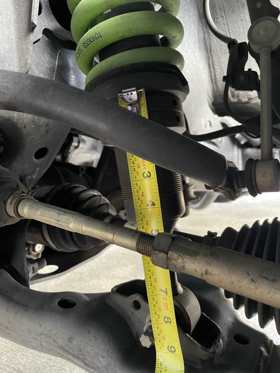

    thanks for the new info. I just measured where my preload is at on driver and passenger side. That's where IM placed them upon assembly.

    That does not look bad with those springs. They are about 1/3” shorter than the springs I have on now.
    You could try removing more preload to see if it softens the ride up for you. I’m not sure what height your trying to keep, or at least don’t see it right now.

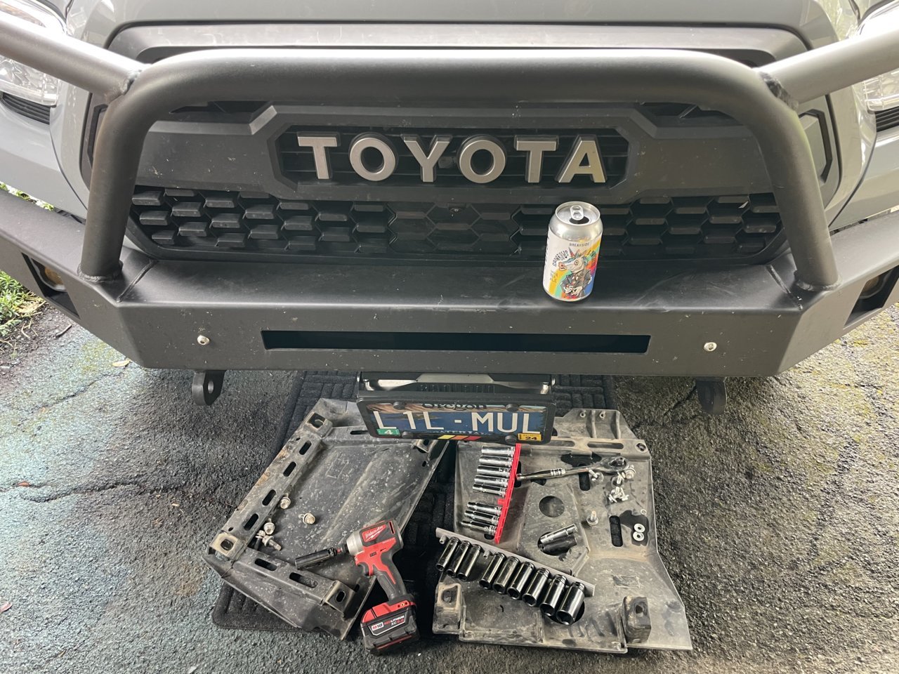

    Anybody do an oil change with Ironman skids on their truck? I had to remove my skids before taking it to Toyota for my free maintenance. Didn’t want to hassle the service techs with my plates.

    Lol, that’s the only (well one of them) that I didn’t go with the IM skids. Having the panel was important since I have free lifetime oil changes from the dealer and didn’t want the extra hassle.

    Theoretically, I just have to take off the front skid to access the filter. There is a small hole at the oil drain plug but I think the Toyota techs would be annoyed by any hindrance. I already have to hand them the lock key socket for the lug nuts.
    I bought a fumoto valve kit that may make things cleaner and easier in the long run.
