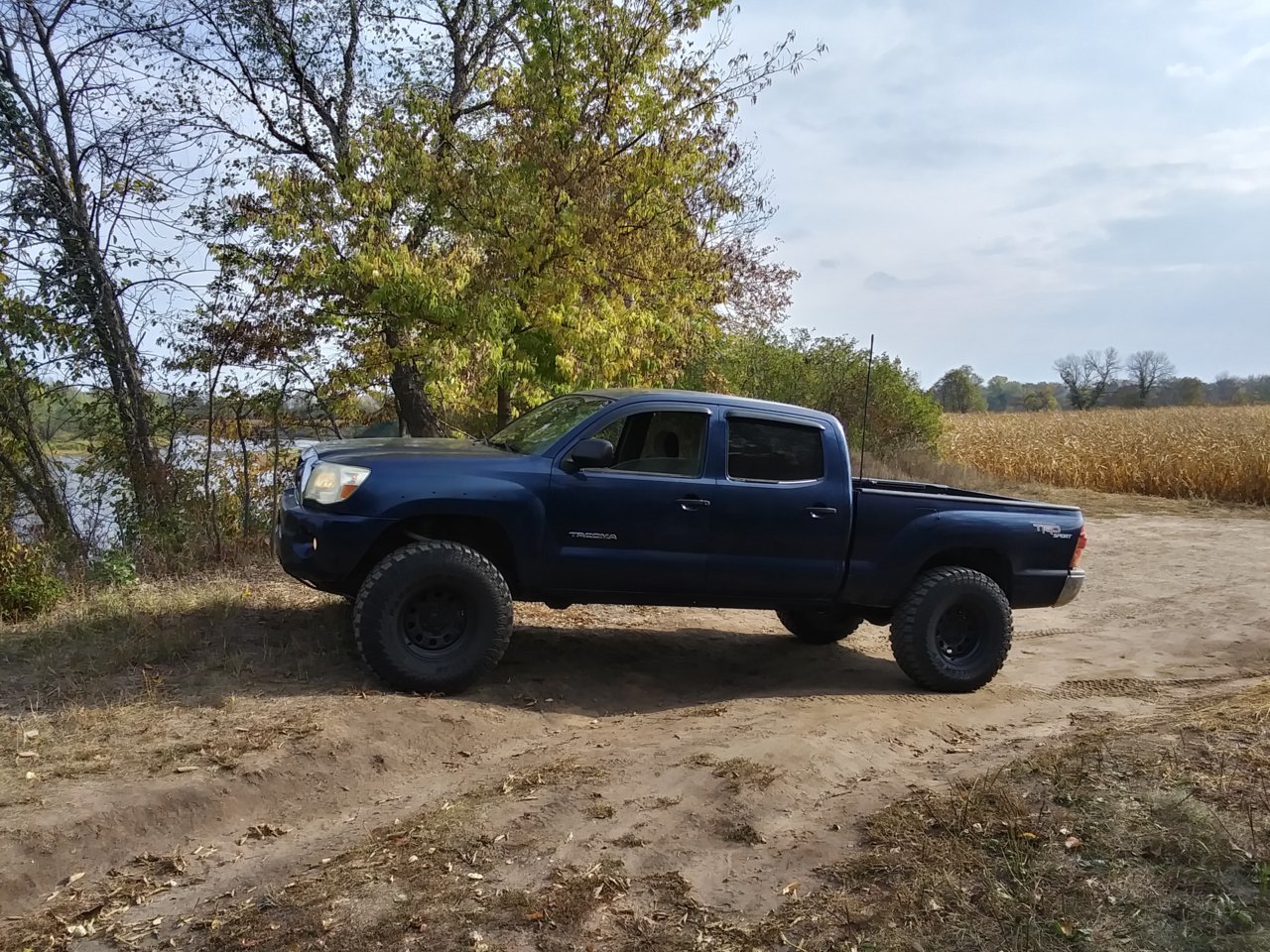

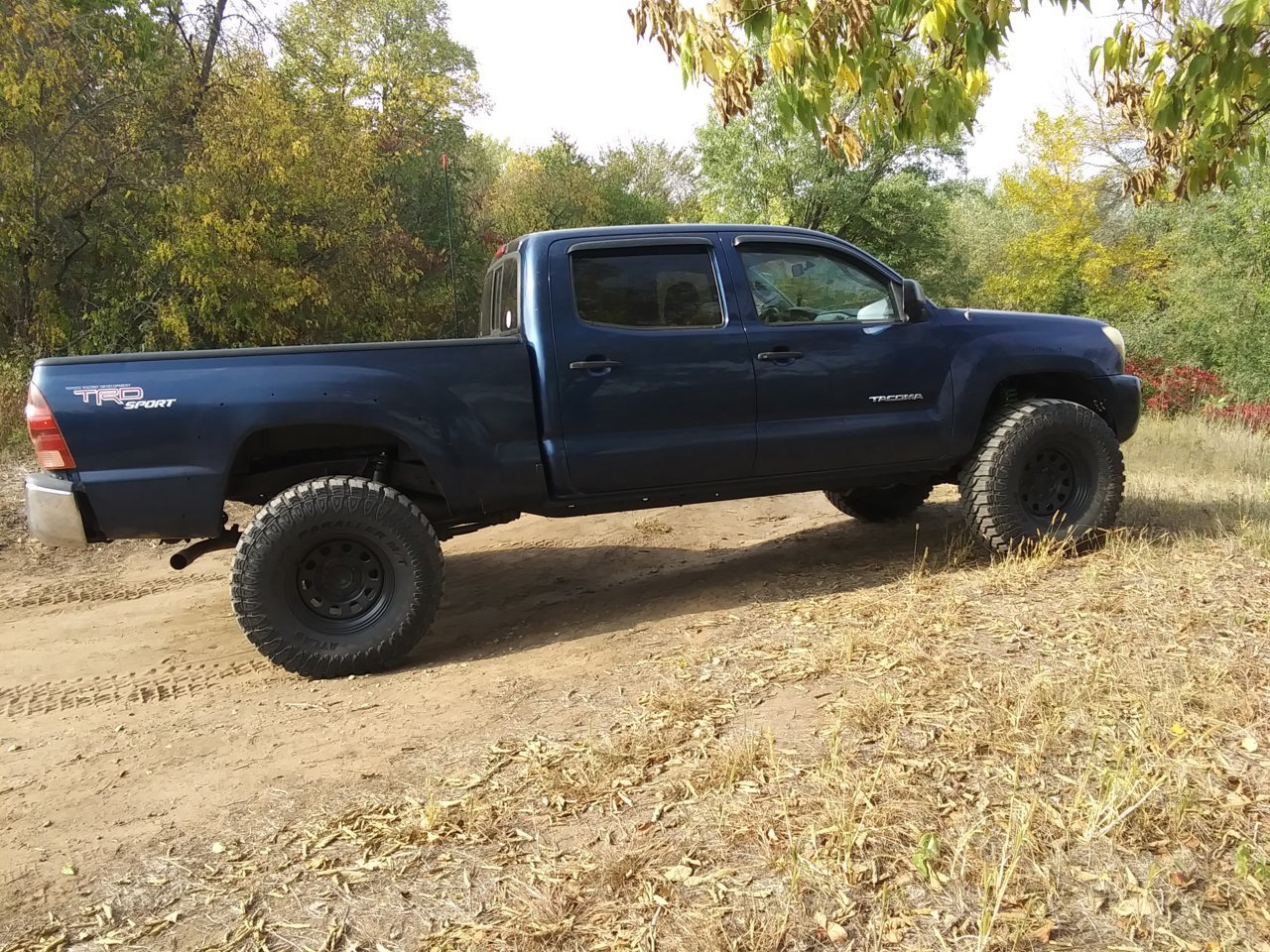

    I think Old Blue settled in good after a few months . Not sure how the rest of you feel but in my own opinion. This lift is well better the all the others I personally have ran. And I've been wheeling for 39 years so there's quiet a list. Now my kit is only a Mid travel lift. But for a lifted truck I feel it performs very well on and off road20230922_095101_HDR.jpg
