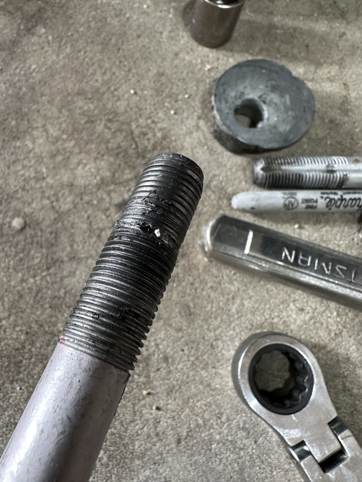

    Nice update! I had to swap out mine after the treads on one of the bolts ended up buggered from hitting a pot hole. I put a tab kit on mine.
    I’ll say more than once I’ve thought about adding 200lbs or a few 5gal buckets of sand in the bed to see what that does.

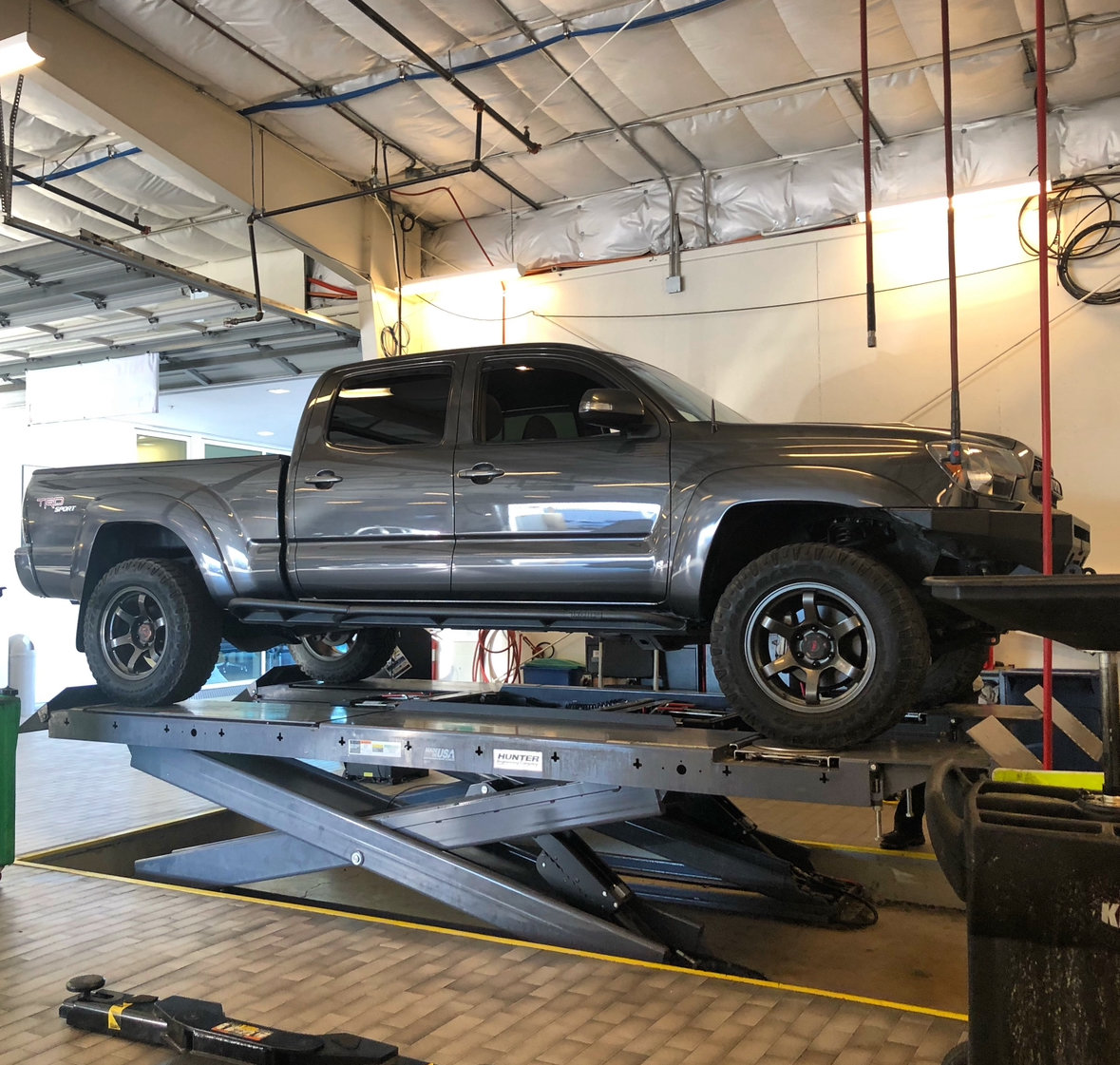

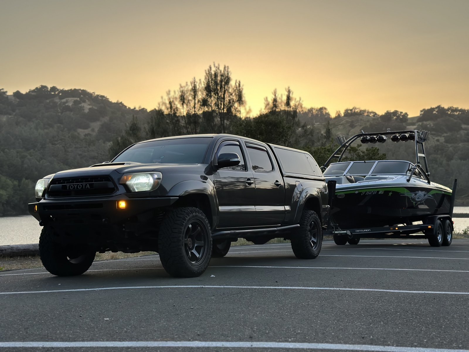

    I called and emailed them and asked to switch to the 0-440 due to just the shell and some camping gear. I have seen other posts that say the truck lifted 6” with the heavy packs. And I have been running stock springs of the tow package for 12 years with 3” lift in the front and a 1” block with Firestone RideRites on Daystar cradles and it has been more than enough to keep level towing a Wakesurf boat with full camp gear for a week. And it can still articulate thanks to the Daystar cradles. I may not even swap leaf packs until I see how it feels with the new shocks. I also already have Tubular UCAs with Uniball but I just wanted ones that don’t have to be lubed every time I wash the truck that aren’t as noisy.
    This was my 2nd suspension after the TRD Sport Bilsteins. IShock Midtravel Kit with tubular UCAs with uniball and Diff Drop 3” Coilover lift.
    This was after I swapped out the stock IShock 600lb springs for the heavy 700lb springs when I just had the plate bumper and no camper shell.
    This is how she sat. I have always had the BAMF sliders and rear diff skid, and was the first No-hoop fully powdercoated production available from Jerry when he made these.
    Zero Squat with a weeks worth of camping gear and a fully loaded boat on 700lb springs with plate bumper and stock tow package with the Air Ride and Cradles with like 30-40psi.
    Nice and Level zero squat with fully loaded truck and same 700lb springs with plate bumper and sliders and camping gear IMG_5654.jpg Just really like this pic… Truck and Centurion looked killer in the Sunset.
    Then I got the truck re-painted from all the 12 year old Toyota paint fade and trail scratches. And I had the body shop install the 12k winch that has been sitting in my hall for 6+ years. And now the front is even more heavy and truck already has a Rake with like 10psi in the bags just so they aren’t zero. No load in the back other than the Snugtop. I don’t need 6” more lift in the rear so figured the 600+ was overkill seeing other people’s lifts after I had pulled the trigger. I figure it would ride better going softer in the rear and heavier in the front to counteract the heavy front and not super heavy rear since I have OEM rear bumper and am already too heavy to do the high clearance rear bumper with swing away. I wouldn’t have enough HP and be over GVWR if i did that. Was going to do the Fox Elite resi but don’t want to rebuild or revalve every 20k miles. And the Kings would be too soft for all the weight. I wanted to minimize the teardown and back together as I have too many projects between all the motorcycles and cars and my Subie as well. Need to do my Eibach lift kit and Cobb goodies and Vibrant exhaust on the Ascent. Just tuned up the accessport on it so far. Thing actually rips for a Costco Car And my new Africa Twin comes in a couple months and the Navi/600RR/CRF250L all have more mods just sitting in boxes. Just kept buying shit but no time to work on anything.
    Really Hoping the Ironman FoamCell Pro was the right choice for my heavy ass Taco.

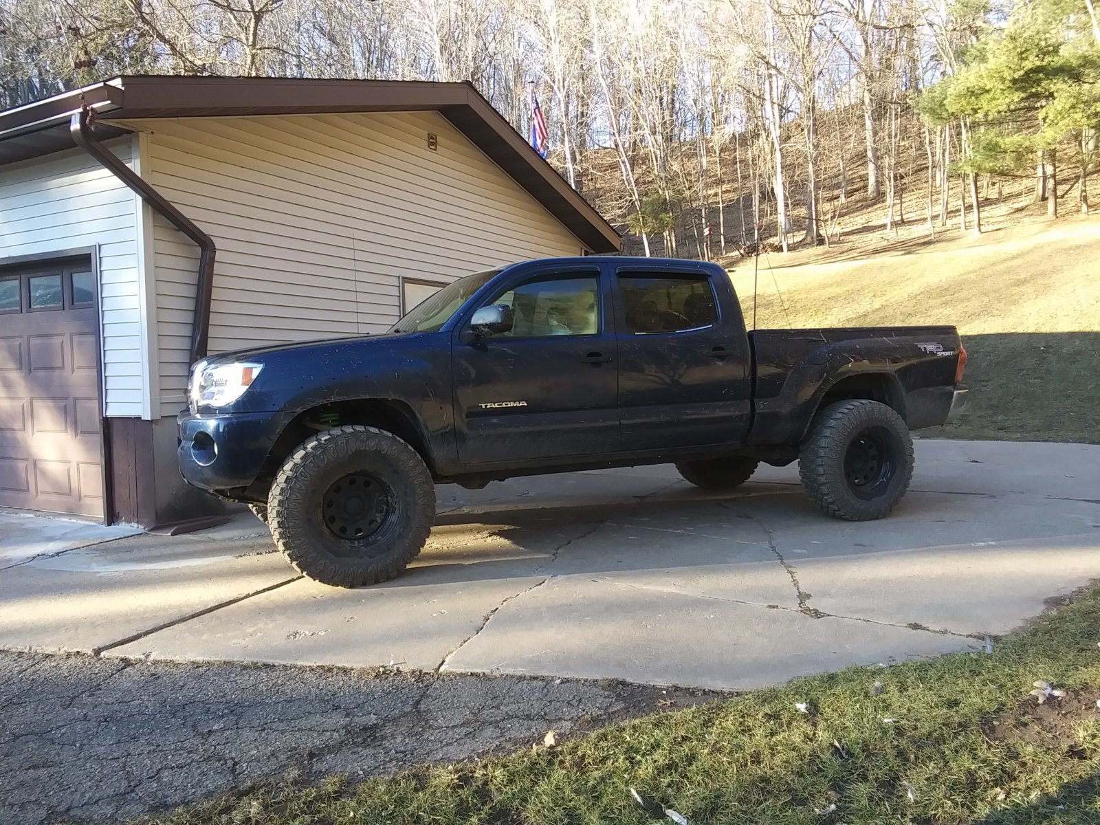

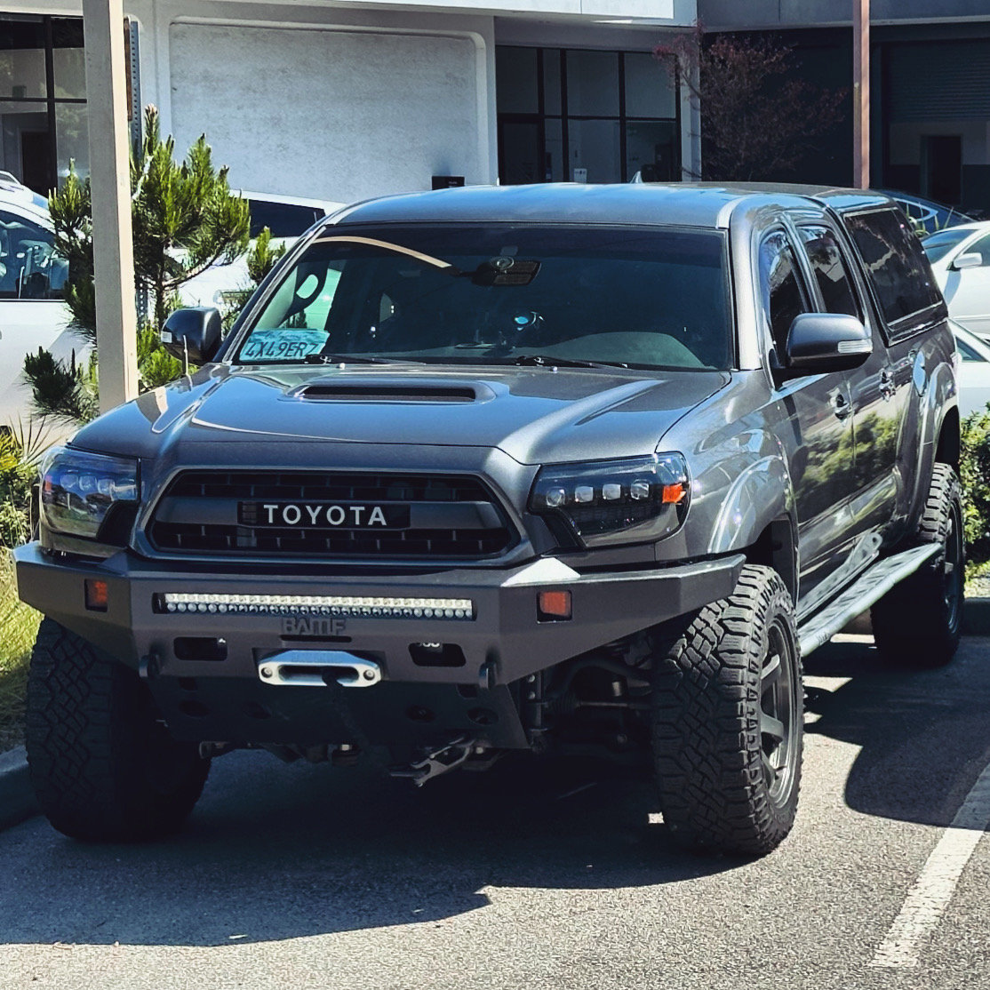

    This is where he sits now days ! Still has inner fender liners does not rub in front or back while it is off road / off trail and yes where I come from sometimes you just have to make your own path. 20240202_154648.jpg

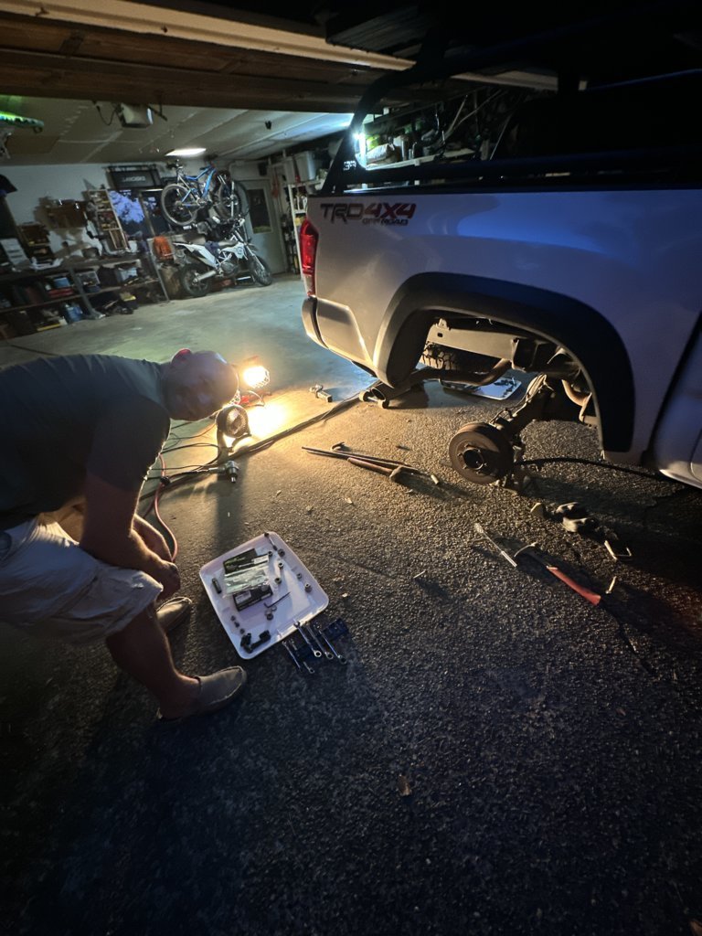

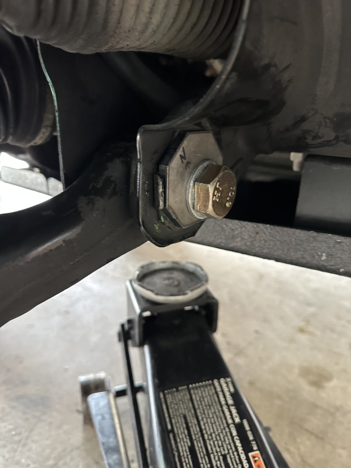

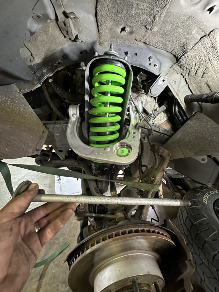

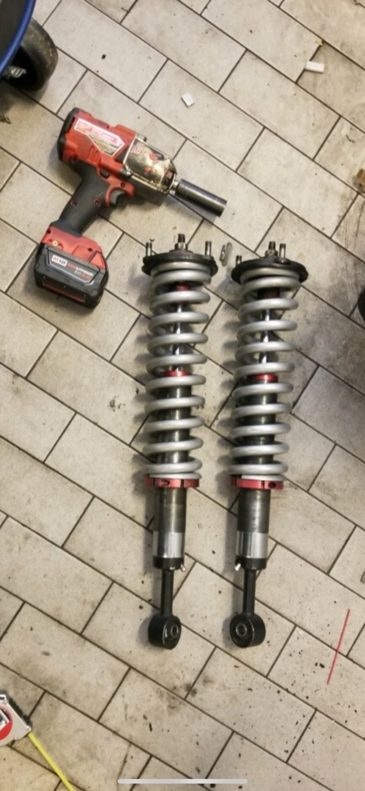

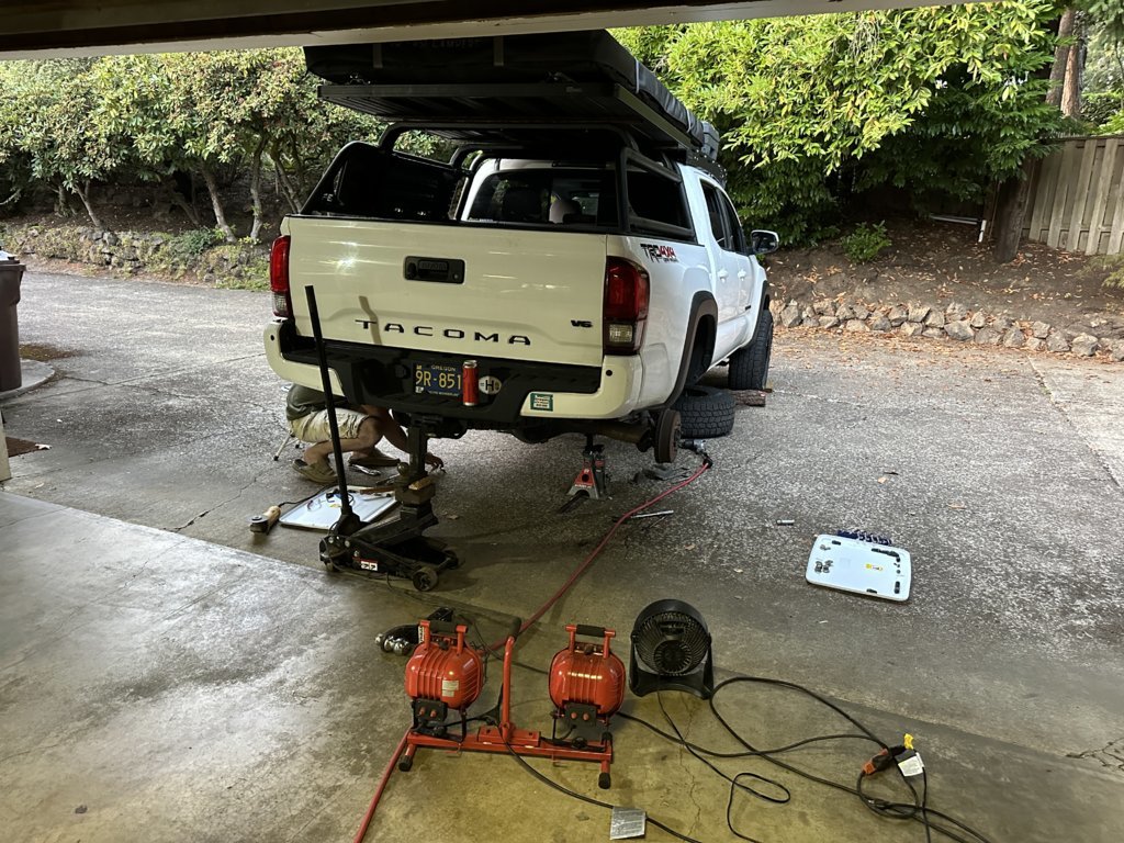

    Finished my install yesterday of the Stage 2 kit and I’m very pleased. I had installed used Bilstein 5100s that I bought off TW at all 4 corners about 4.5 years ago. Those were getting a bit tired and the factory leaf springs were sagging from the added weight of my GFC Superlight and Body Armor bed cage.
    Install was relatively easy. The UCA bolts were a PITA—what the hell was Toyota thinking when they designed that? Did the rear last Sunday night in about 3.5-4 hours. Front was wrapped up yesterday and it took about 5 hours. Had a buddy help me who’s done the job 3 times before on his previous 2nd gens. That was helpful.
    Ride is much nicer for sure. Taking it in for an alignment this week.
    Adding some photos cuz who doesn’t love photos?
