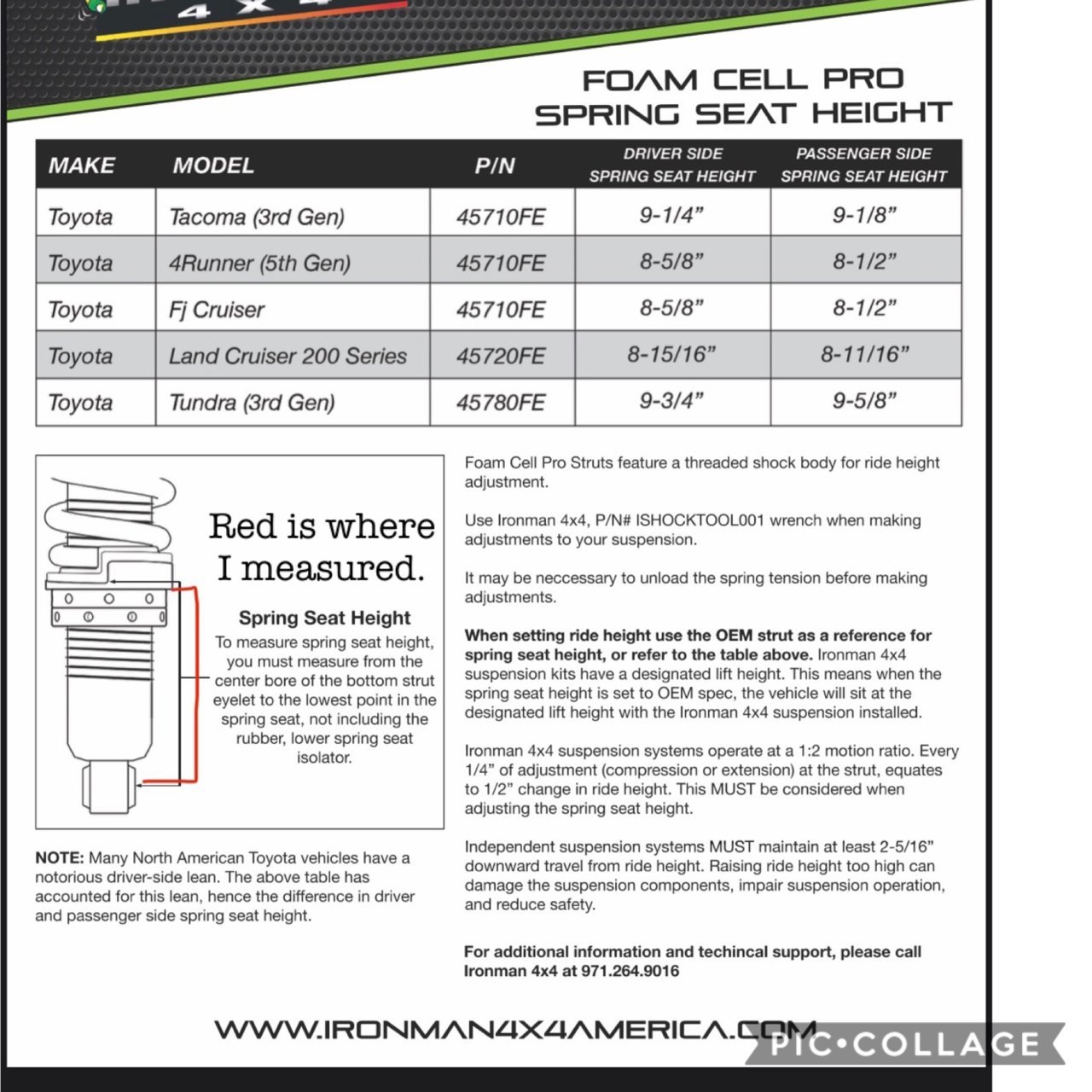

    Setting up the struts I set the drivers side height to 8.87” and the passengers to 8.75” to account for the taco lean. I measured from center bolt hole to bottom of the spring perch, not where the bottom of the spring is, like I should have. I originally wanted to lift my truck 2.5”.

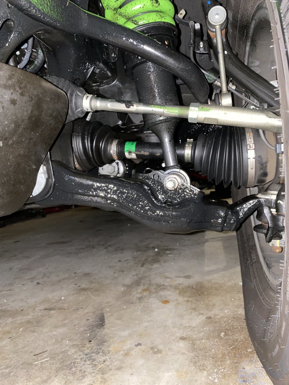

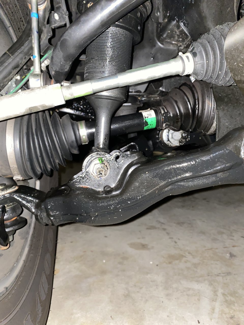

    That caster is no bueno. You need UCA's. Got any pics of the CV angles?

    Thanks, that’s good to know. UCAs are on my radar to get but I can always lower the front some till then. I’ll grab a pic tomorrow and post it here.

    Definitely not gonna kill you, but more caster will handle better

    So far the handling has been pretty good and I’ve not noticed anything that felt off. I would like to get UCAs still.
    Grabbed pics of the cvs- the one cv has Woolwax overspray on it, not grease.

    Looks like your boot fins are rubbing on the diff side. That can wear holes in them and then eject all the grease. From what I've read most folks try to stay under 23" hub to fender to keep them from rubbing, which is why I was curious what your CV angles looked like. You can do a mod to extend your CV boots out with a hose clamp to try alleviate that, or get aftermarket CV boots. Or you can leave it and see if you have any issues down the road. Looks good, but that is a hazard with the stock CV's. That's why I'm rocking 22.5" hub to fender :D

    I’ll need to check out that mod. I’be seen the red boot cvs but not ready for that yet. Might be easiest to drop half an inch. I’ll keep that in mind. Thanks for those tips too.

    Check out this post I made on the “main” IM tread, it might be helpful. All the FCP struts are adjustable, it’s the spring rates that are different.
    https://www.tacomaworld.com/threads/ironman-4x4-foam-cell-pro.427407/page-82#post-26020053
