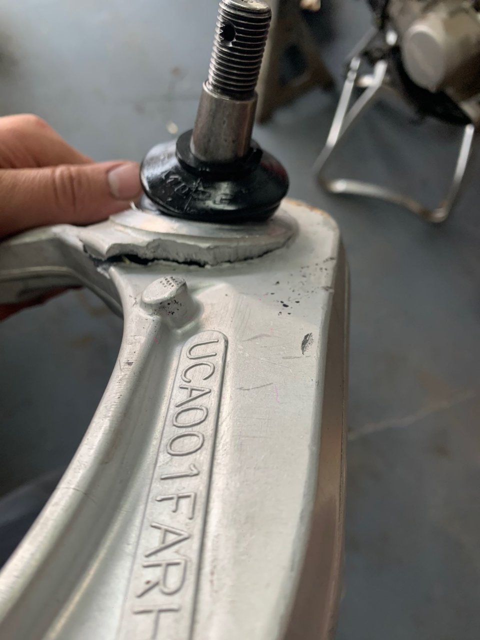

    Interesting they say "premature wear" of the balljoint. Doesnt take a genius to see that aint wear and sure isnt the ball joint.

    Welp, guess I should order the TRD uca like I wanted now to swap mine out. Thanks for informing.

    I just got off the phone with them. I used to sell a lot of iron man. They say it does not impact the US market but they will continue to evaluate the situation. I think that means that people in the US do not wheel as hard. Lol.

    Fracture direction suggests the ball joint got into a bind, due to abnormal wear and/or bad design.

    The uca's have been scrubbed from their website so i think it'll most likely the usa market will also fall under that recall.

    Thats a good catch. I still have a hard time saying thats wear. It really is improper design, either they did not monitor their ball joint supplier or someone goofed up the design.

    Wow, I can't believe this is happening. I've ran mine for about 17k issues and no real wear on them but I don't wheel often. As of now, they are only saying it's the Australian arms are the only ones affected. I will say this, at least they stand by there product and recalling it. Curious to see if the US ones are affected and how they will handle this.

    Yeah I installed them in December. I kind of want to ride it out as Mine have been great the last 17k miles and they are saying it's only the Australian arms. I spoke with a guy and supposedly the arms are made differently from the US arms. Not sure how true it is, but just going off of what I was told. Maybe ours are fine?

    I think it's safe to say as of now we might be in the clear hopefully. I've had great luck with the Control arms. I hit a deer on the driver side and it walked over it doing 65mph. It didn't break then surprisingly so I think we might be okay. But I'm hoping for the best and will keep updating the thread.

    Yikes, Thats a mess.
    Do you have any information how this happened? Long struts and ball joint binding?
    Also, that looks like a MOOG ball joint, not the Ironman one... Its a bit hard to tell. Could you confirm?
