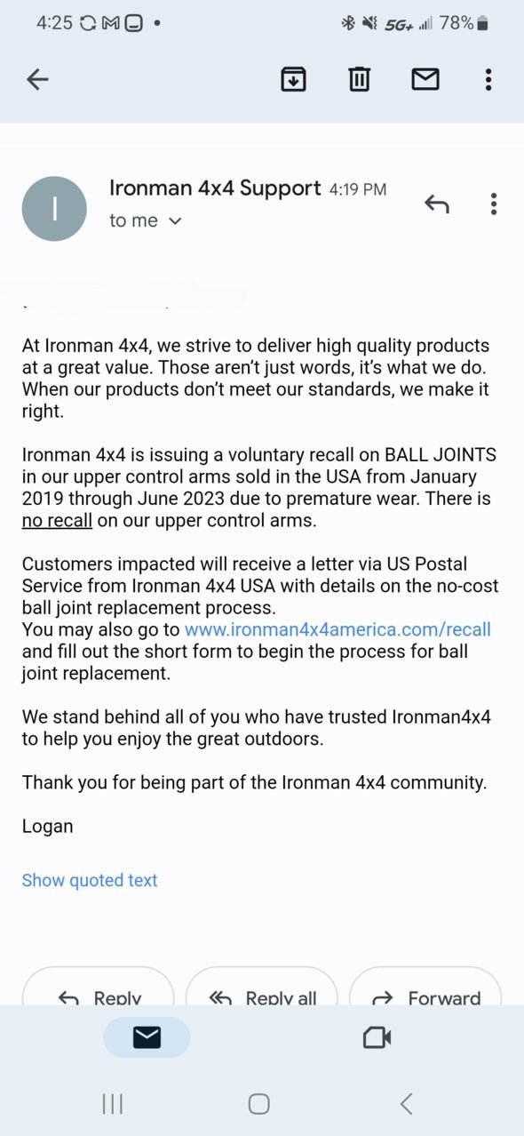

    Just received this
    rubbersidedown and TheProject like this.

    That's odd. Supposed to be factory style ball joints right? That is one of the selling points to me. I can't imagine the geometry is so of that it causes failure of the joint but maybe I'm just being hopeful
  9. Jul 10, 2023 at 7:32 PM
    #29
    PNW15
    PNW15 Well-Known Member
    Jan 23, 2023
    #416175
    156
    2015 Tacoma DC LB SR5
    Maybe factory style doesn't mean OEM Toyota? And their ball joint source was the issue?

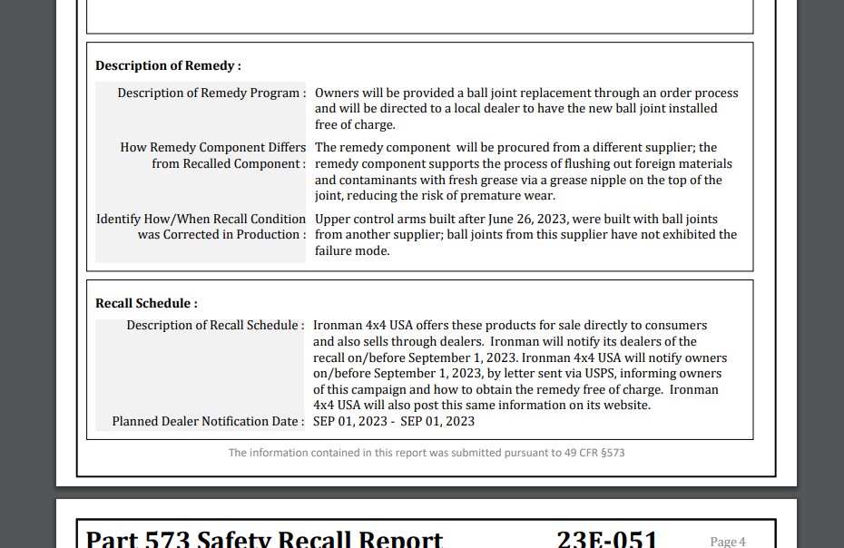

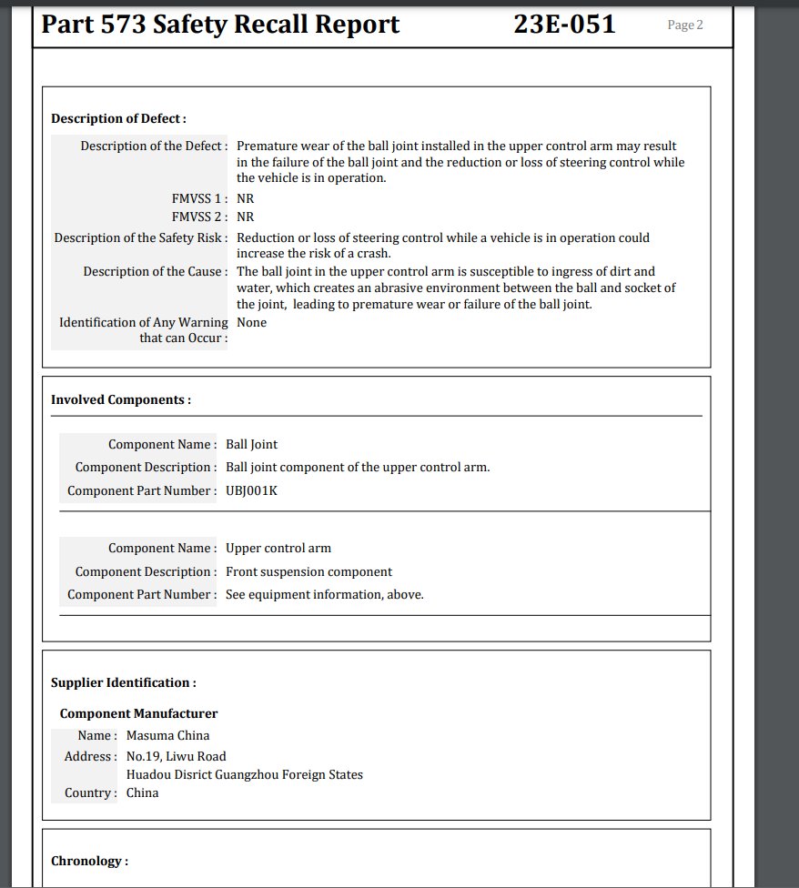

    I wish they fully disclose in detail what the issue is to clarify why the recall is being made…

    Ive been speaking with Head Office in Melbourne. The sales manager told me the ball joints are getting excessive wear and some have separated resulting in accidents. (To be clear - they told me the ball coming out from its socket... so not arm related at all). They wouldnt tell me how many have separated, but said its some small percentage of the thousands of arms they have sold worldwide. Its clear its a fastly evolving situation and they said they we developing the plan, whilst also obtaining a Tier 1 supplier of appropriate BJs.
    In Australia there are serious regulations for safety recalls. A friend took his FJ in last week and they found his LHS BJ had some play, so they replaced with new set of arms and told him he will need to come back when they can fit the new BJs. Or we could sort it ourselves - I was told they will reimburse 2 hrs labour + cost of BJs + wheel alignment (In Aus).
    I was told that the FJ/Prado/Hilux arms (UCA001FA - also 4runner) use the Hilux factory size ballpoint - OEM equivalent 43310-09017, which has a slightly smaller diameter than the FJ/Prado/4runner OEM sized balljoint.
    Ironman need to publish part numbers for replacement ball joints, as fitting an eg MOOG (or other aftermarket compatible) FJ balljoint into the UCA001FA would likely crack the UCA as in the photo at the start of this thread.

    Update- I received a letter in the mail from Ironman. It restates that the issue is the ball joint; now the remedy is complete upper control arm replacement. To be clear it says verbatim "We will ship your replacement upper control arms free of charge when the part becomes available, which we anticipate to be in October." It goes on to say that the parts should be installed at the local dealer and that receipts will need to be submitted for full reimbursement, though it does not state whether there is an upper limit to the dollar amount covered.
