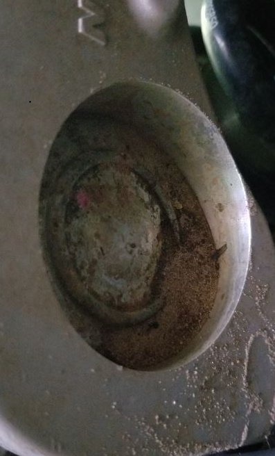

    Just received my letter from IM4x4. If I am reading this right, they are shipping out new UCA in October? I filled out the recall form.

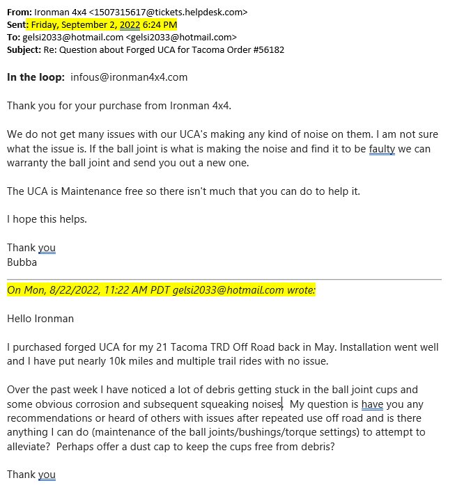

    The funny part is I emailed them about a year ago telling them I was getting crud stuck in my ball joint and hearing a bit of noise and asked if they would make a dust cap to keep those deep cups free from junk.
    They did offer to replace my ball joints at that time for no charge.
    I didn't think it was a big issue and picked up some rubber covers to try and mitigate the debris getting stuck in there.
    I have about 25k miles on these after 18 months and no issues to date, but I am glad they are working on replacements and it seems like they are standing behind their product.

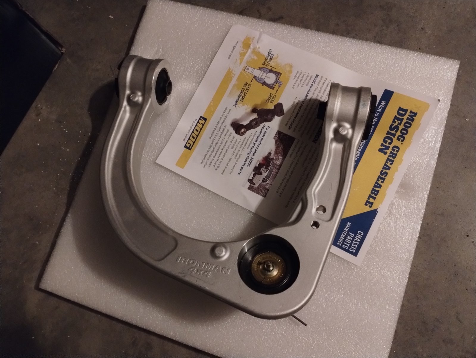

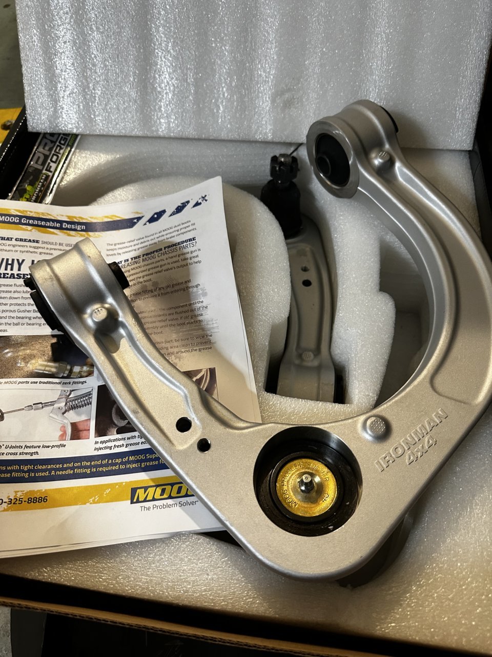

    my replacement UCA came in today.
    It has MOOG ball joints on the new ones.
    Since only the UCA came without any letter of explanation, I need to find out about labor comp and all that. Anyone else got their letter + replacement?

    At initial look, I do not see any other difference other than the MOOG ball joint. Everything else seems exactly the same.
    My guess is if there is a premature wear on the UCA due to this ball joint issue, the arm itself has a wear that is abnormal, so it should be included in the replacement work.
    That is just my guess. And I'm happy that IM is replacing the entire UCA.

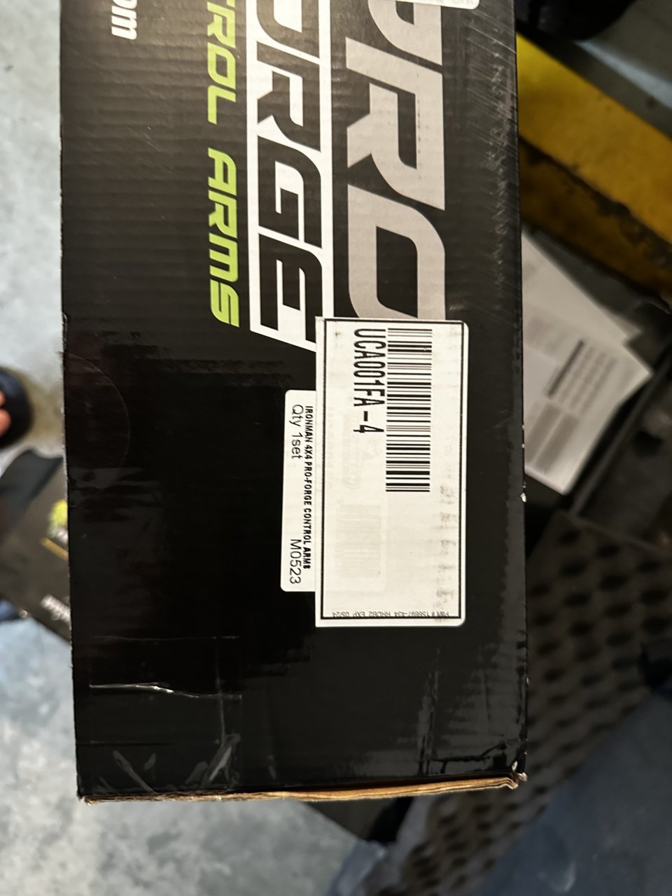

    My guess, for the purpose of liability, the entire assembly needs to to be replaced. I don't have my old box, but I noticed on picture of the replacement UCA box there's a suffix -4. Not sure if that's meant to distinguish between UCAs w/ replacement BJ or not, just a guess.
    Unless the replacements are stamped in someway, people should probably be wary when these predicably enter the used market. Additionally, resale value probably diminished even if the updated version with MOOG BJ.

    Is there a part number on the ball joint?

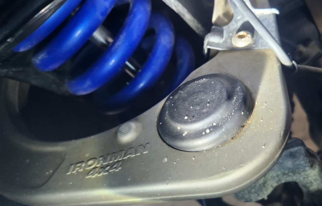

    Do you have additional info on that dust cap? I’d like to get some of those for the new UCAs when they come in.

    Looking good. I would also love to put a dust cap on these since they are serviceable.
