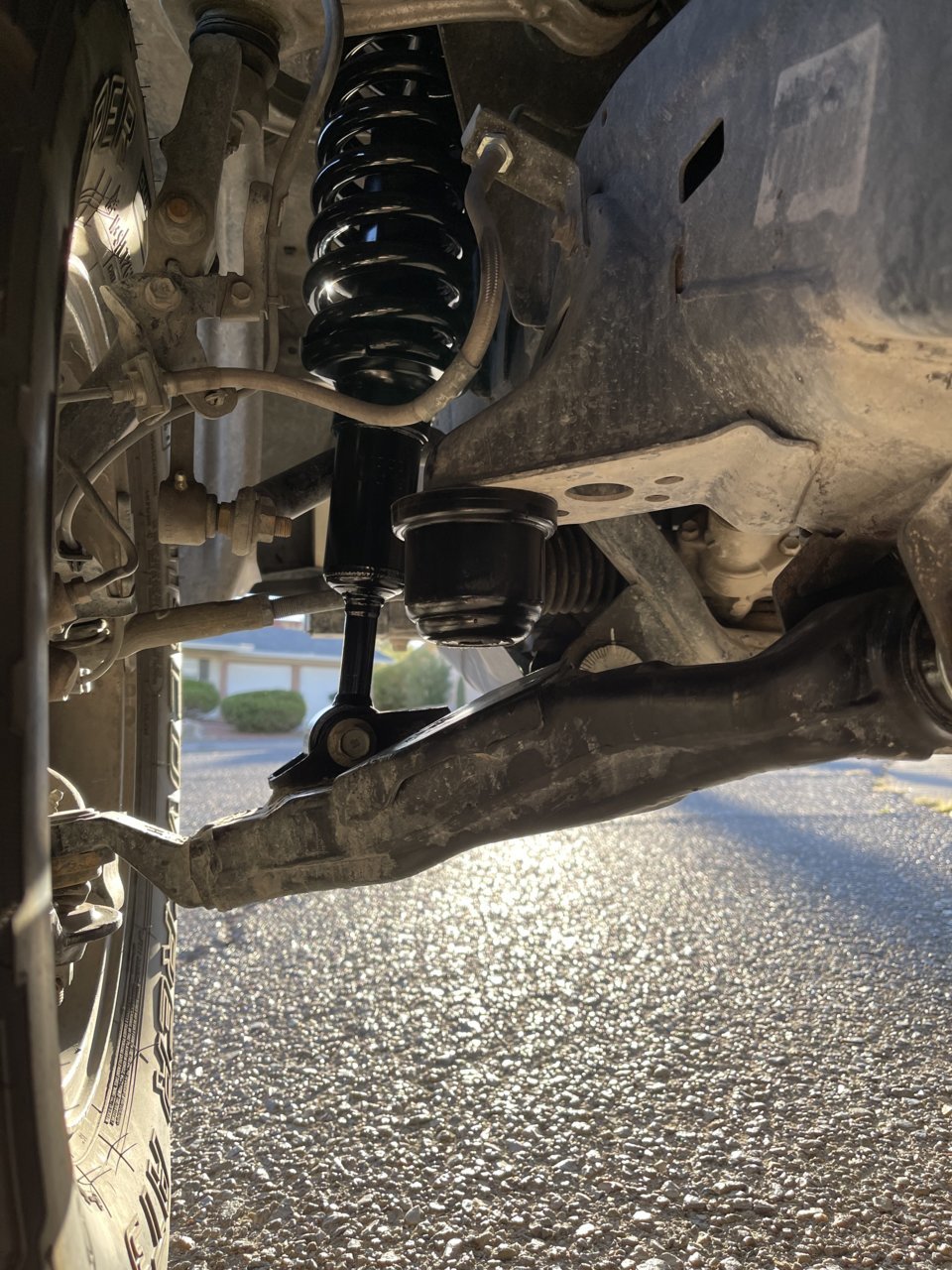

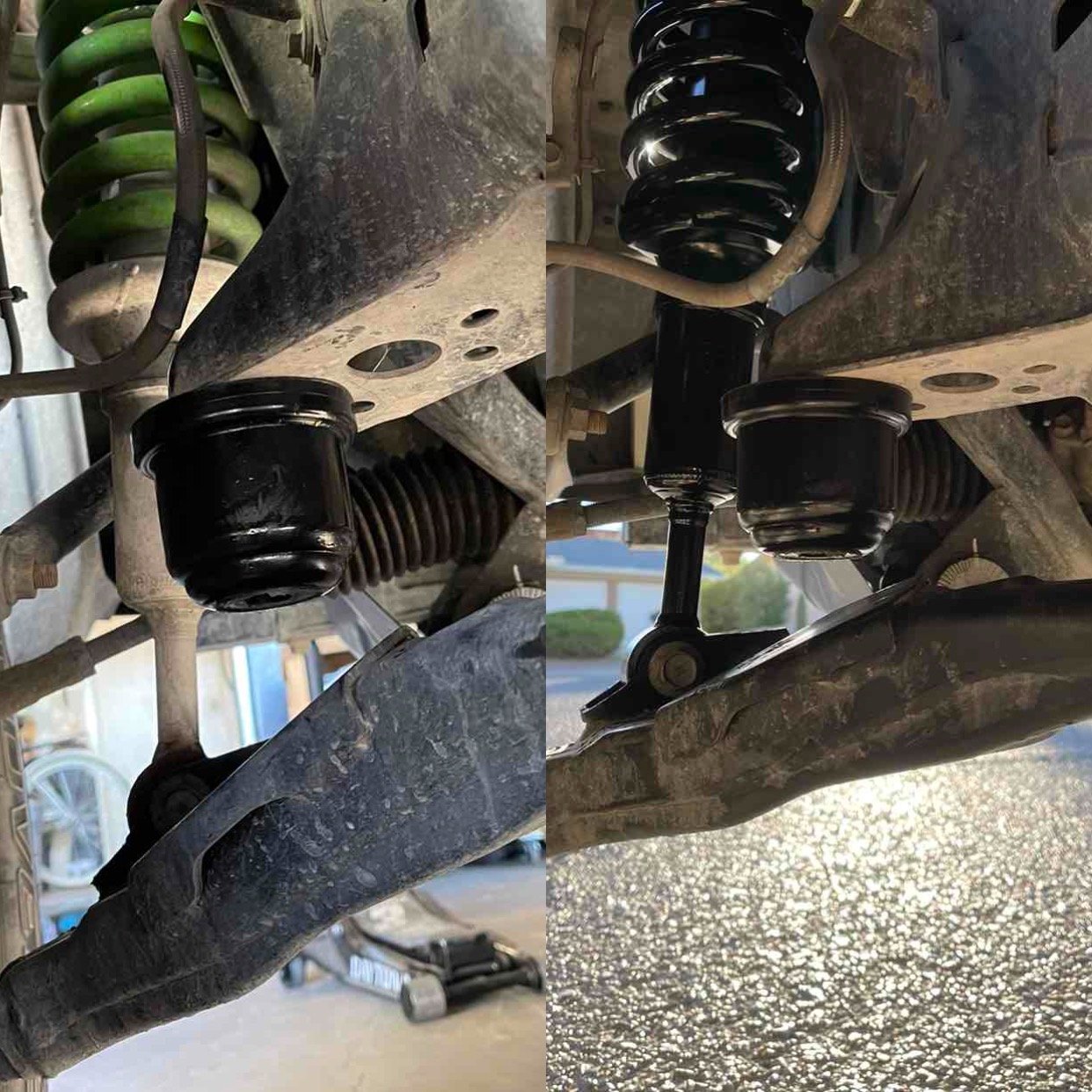

    Remember way back when I said “I’d love to install some zerks one day.”
    Well I did that today when I swapped my front coil springs out.
    So as a Prerunner, I have to account for the lighter weight of my truck versus an equivalent 4x4 variant. This discussion is a common theme on this thread you’ll have noticed.
    Since the Ironman kit “meant for 4x4 vehicles” jacked my truck up almost 5.5” and gave me essentially no real useable suspension travel either direction I started looking for a way to fix that issue without buying an entirely new setup.
    So after a lot of thought and probably tons of unnecessary calculations I decided to pick up these coils and try them out. They should set me right about stock height, which I prefer.
    If you have the Ironman nitro gas system on a prerunner and are looking for a bit softer ride then the Dobinsons coils might be for you! They have all the same free heights as the Ironman coils with a 586lbs/inch spring rate.
    So you can preserve your lift height and get a lighter spring rate.
    I’ll have to keep updating as I put more miles on them!
    Zerk fittings!
    Coilovers out, shocks aren’t too dirty. Still ugly white though.
    New coil springs next to the outgoing model, those are Dobinsons C59-238 coils. (14.75” free height and 586lbs/inch rate) Thanks @Crikeymike for all the help!
    No better opportunity than now to remedy the colour choice!
    Much better!
    Installed some Superbumps while I was under there, just in case I need them.

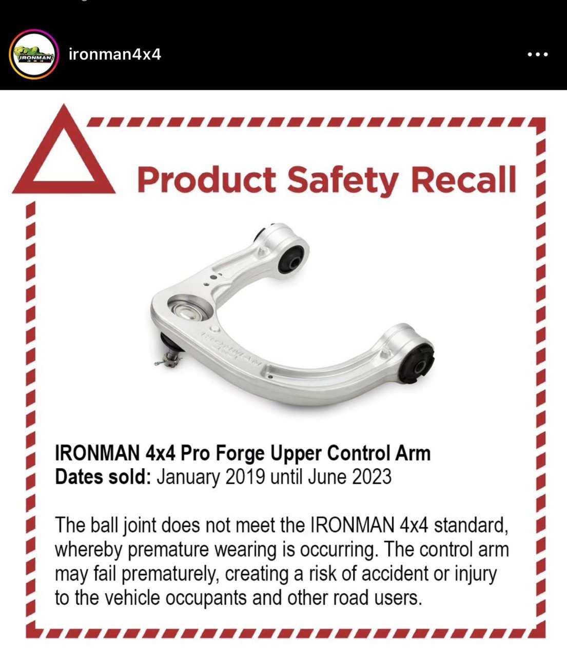

    Ironman4x4 issued a safety recall for the ball joint in their Pro Forge UCAs. On the webpage it says “Effective immediately, we’re recalling all Ironman 4×4 Pro Forge Upper Control Arms.” However to my understanding they said this has only affected products sold in Australia, and not in the USA.
    I’ll keep an eye on any development.
    @hyrule_trd @Lucario Runner
    Web link; https://www.ironman4x4.com/recall/
