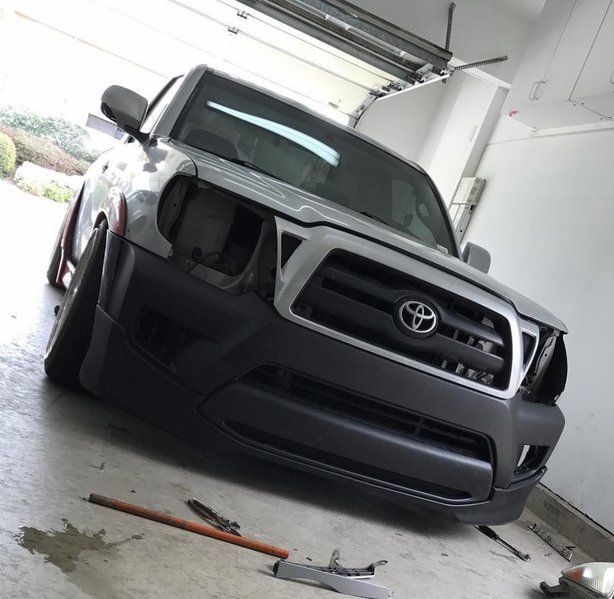

    Where did you buy the bumper? And was there a good amount of fabricating to get it to fit?

    Na was straight bolt on

    It's oem 2015 Toyota x runner front end bolts straight up ... do need to switch out crash bar to 2015 it's a lil shorter
    ChadsPride likes this.

    Bought it from Toyota

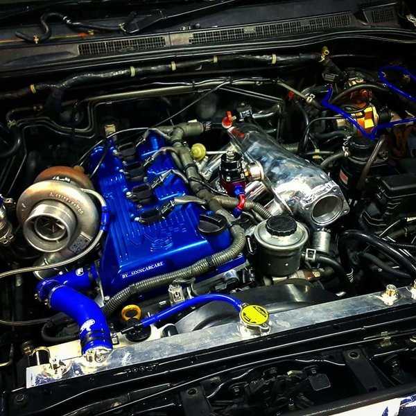

    Torspd Custom Turbo kit [] Borg Warner 9180EFR Turbo [] Haltech Elite 2500 [] TiAL Q BOV [] TiAL V44 Wastegate @ 15psi [] CP Pistons [] CP Carrillo Rods [] ARP Head studs [] ARP Main Studs [] ARP Header - Head Studs [] Ported Heads w/ 1mm oversized valves intake/exhaust [] Brian Crower Forged Stroker Crank [] Darton M.I.D. Sleeved Block [] Kelford Camshafts [] Torspd 160* T-stat mod [] APR Large Fuel Rail [] Walbro 460 LPH E85 Fuel Pump [] FueLab FPR [] APR T56 Conversion Kit [] KP RACING Built T56 [] McLeod Racing Custom Twin Disk Clutch [] One Piece Aluminum Driveshaft [] MGW Shifter [] Custom lowering kit [] Ohlins Front Coilovers [] QA1rear shocks [] Custom Ron Davis Radiator [] Dual SPAL Electric Fans []
    Just a heads up if you weren't aware. The 2TR is the same short block as the 3rz. Stout little engine. Just VVT-I. All of the short block parts are interchangeable. Cheap to build.
    Truck is mighty wicked. :thumbsup:

    Thank you , I've rebuilt the motor with pistons and rods ... but not still stock .. gonna run noz for the next drift event and then prob swap it to 2jz
