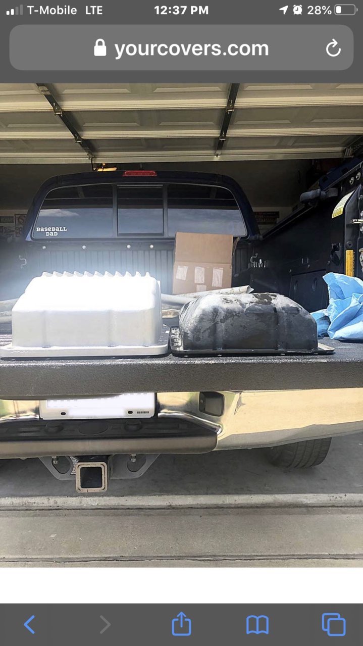

    E349FBAF-C3E0-4EBC-9D27-EE3E91CEEB39.jpg I was a bit overkill when I bought my 15. At 30K I disconnected the return line and pumped about 3.5 qrts out. Shut it down, add 4 qrts, start it back up and pump 3.5 qrts. Repeated till I used up 12 qrts. Temp check mode and done. Used Maxlife ATF because it’s synthetic. 60K I did drain and fill. 80K I put a deeper pan and used Amsoil blue cap atf. I won’t touch it till 150K now.
