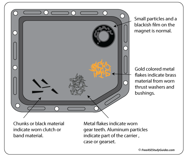

    To OP, don't guess about whether to do a flush. Drop the pan and see how it looks. Inside you will/should find magnets with black sludge. This is normal. If you find metal shavings or black’ish material, don't proceed with a flush. Maybe not even continue with drain/refill; return the old ATF back in the pan because removing that material from the fluid will likely lead to slipping. Do replace the ATF filter and clean the pan regardless, especially if there are metal shavings in there.
