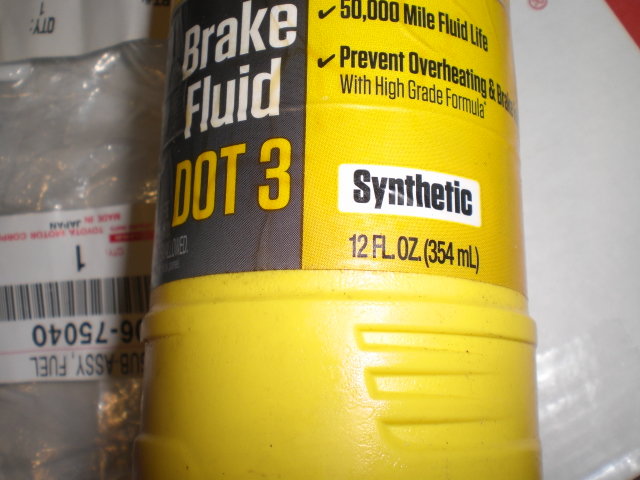

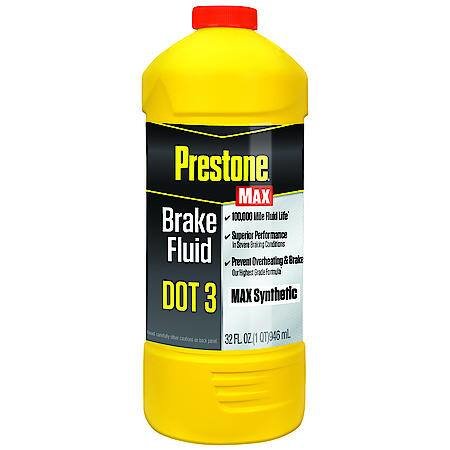

    Non abs, doing all four wheels I use a 32oz......and I end up with about 10oz left over and stick in old 12oz container for adjustments.....
    I like the prestone max....supposedly lasts 10 yrs......
    If you keep the air out of the left over.....its good for about 30 days.....
    I even stick in the frig....
    And if flushing....you can stick in either one....dot3 for dot4...obviously cant mix em....
