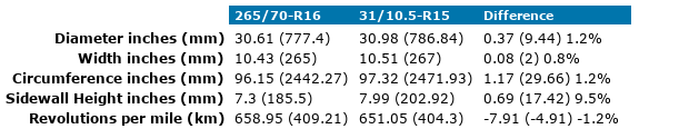

    from the online tire size calculator
    I don't know what your running now but a 31/10.5/15 is a little wider the a stock 265/70/16
