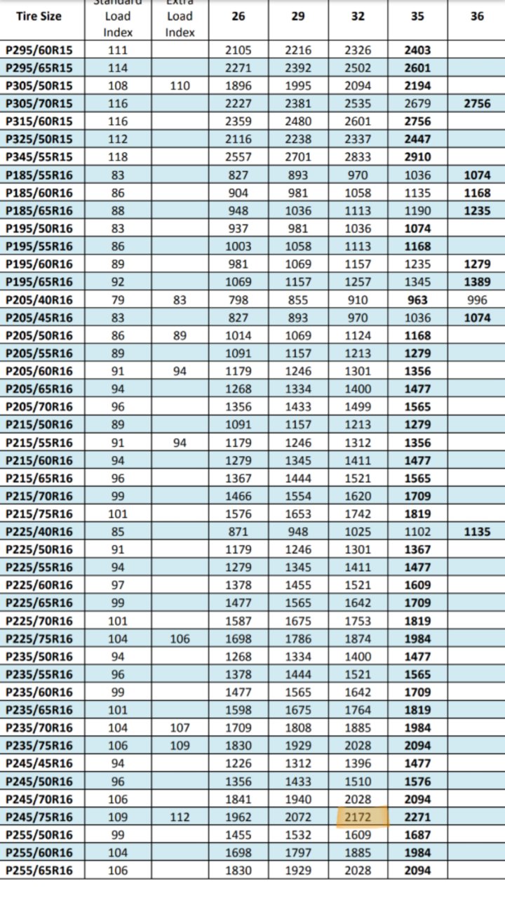

    Your door placard only applies to a P245/75/16/109SL...
    What exact tire did you replace them with? If you replaced them a LT265/70/16, your adjusted recommended psi would be 39.
    What do consider high psi for a load E?

    Those tires are goodyear adventure's. I originally got for my gen1 tundra. Their very close to the 245 75 16's that came on the truck. They were recommended for around 30 psi for the tundra. They seem fine at 32 psi on the tacoma. Their wearing perfect.

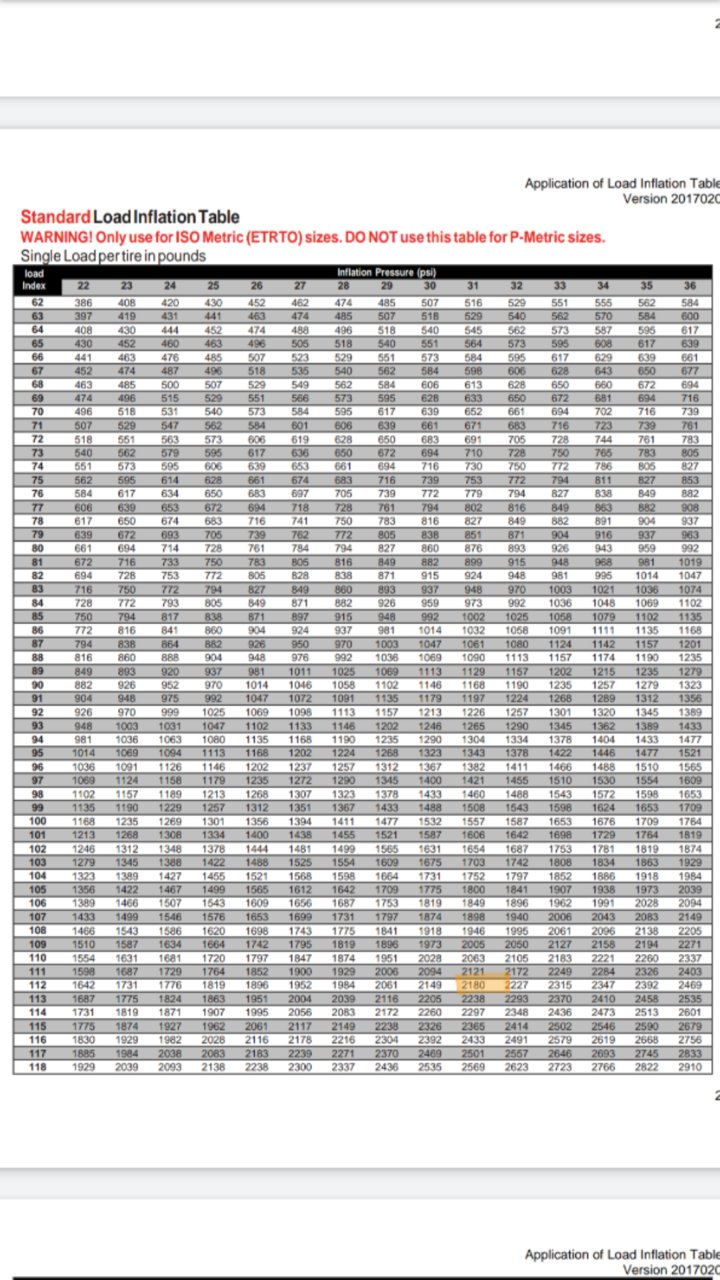

    Adventure Kevlar; the same thing that comes OEM on Offroads?
    I wouldn't say their close...
    The stock tire is a P-metric P245/75/16/109 SL.
    Your replacement tire is a euro-metric 265/70/16/112 SL.
    31 psi would be your adjusted recommended psi. At 32 psi, you're within tolerances of most TPMS or a good pressure gauge.
    I'm posting this to explain the how/why you are correct; just not for the reasons you describe. It's not meant as a 'gotcha' post.
