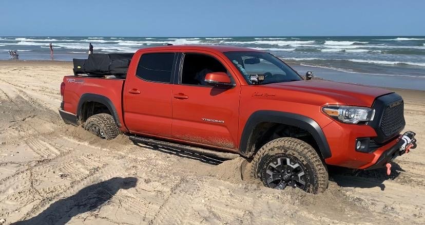

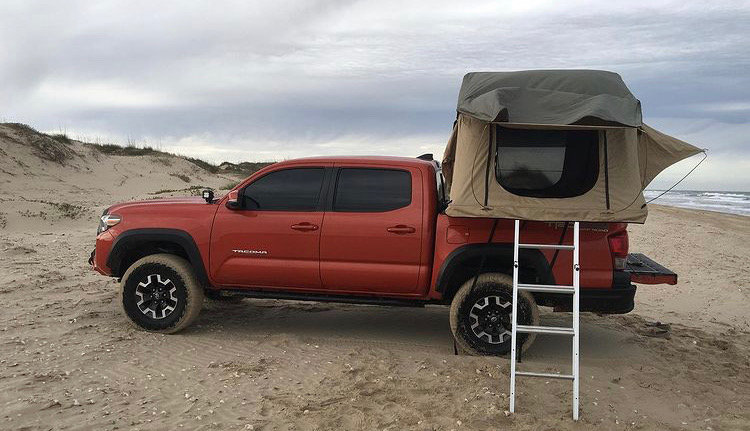

    Post a pic of your truck.

    Hank
    ‘21 SR5 Tundra CM 5.7L Barcelona Red
    Tint, LED interior
    See this is where I get indecisive lol
    I should also state that I have the OVTune which has helped a lot, so Im thinking if I throw the 4.88 performance tune plus the 4.88 gears I might be doing really well.
