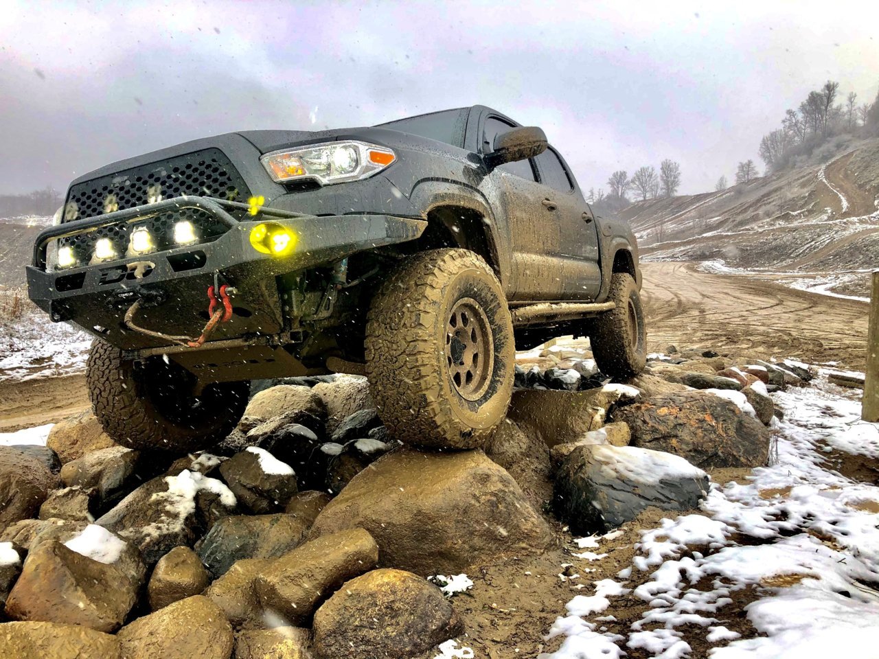

  10. Dec 16, 2020 at 11:39 AM
    #50
    Freeheelbillie
    Freeheelbillie Well-Known Member
    Mar 18, 2018
    #247669
    1,603
    Billie
    Saint Clair, MI
    2019 Tacoma SR, DCSB
    FRONT END King Stage 3 3” RR Coil Overs SPC UCA’s REAR END King Stage 3 BAMF Shock Relocation Rear AAL Heavy ARB Universal Diff Breather Kit TIRES & RIMS 16” Method Bronze BFG K02 (315/75/R16) ARMOR Demello Off Road Baja Hoop Front Bumper Main Line Overland Rock Sliders w/ Top Plate ¼” Aluminum RCI Fuel Tank Skid RCI Fuel Tank Straps RCI Rear Diff Skid RCI A-Arm Skids RCI – Front, Transmission, and rear Transfer Case Skid DRIVE LINE YotaWerx, BlackHawk Tune Re Geared w/ Nitro 4.56 Package Front ARB Air Locker Rear ARB Air Locker 8” Reverse Clamshell 3.73 & Down Carrier RECOVERY ComeUp Seal Gen2 9.5RS Winch, Synthetic Line ComeUp Seal Hawse Fairlead ARB On Board Twin Air Compressor LIGHTING Squadron-R Pro Amber Fogs (Wide Cornering) Baja Designs Rock Lights Squadron Sport Fogs (qty 4) Baja Designs Bed Light Kit SPODS, HD 8 Circuit Switch Panel
    AT (assuming you're asking about the tires)
    CaptainBart45 and Dirk Diggler like this.

    @Bigdaddy4760 hasnt picked his up his truck yet. But just had 5.29 gears installed

  14. Dec 16, 2020 at 1:54 PM
    #54
    Freeheelbillie
    Mar 18, 2018
    #247669
    1,603
    Billie
    Saint Clair, MI
    Oh, got it.
    AT
  15. Dec 16, 2020 at 1:57 PM
    #55
    Texoma
    Texoma IG: Triple C Chop Shop
    Feb 1, 2011
    #50374
    18,959
    Chris(Topher)
    Lago Vista, TX
    10 Taco 4x4
    A bunch a cool stickers, a bada ass MetalMiller Tx Longhorns grill emblem painted Hemi Orange, JBA long tube headers with o2 sims, Diff breather mod, Red LED interior lights, Fancy head unit that plays ipod n movies, Also DIY install factory stuff like, factory cruise control, factory intermittent wipers, OME nitro struts with 886x springs and toy tec top plate, JBA high caster UCA's for better alignmnet and dey beefier too, Old Man Emu Dakar leaf springs in da rear with the gear, U bolt flipper, Ivan Stewart TRD rims with 33" K Bro 2's, some bad ass weather tech floor liners so I don't muck up my interior, an ATO shackle flipper for mo travel in da rear wit the gear, also super shiny Fox 2.0 shocks back there too, all sorts of steal armor for bouncing off of the rocks like demello sliders, AP front skid, trans skid, n transfer skid, demello gas tank skid, and a tough as nails ARB bumper with warn 8k winch, I'm sure there's more
    For 33" and smaller tires, 4.88 will do you good. 33" and larger tires, 5.29 will do you good. Add in weight of armor, gear, and things that will inhibit aerodynamics, then consider that you will need more power.

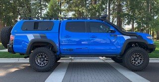

  16. Dec 16, 2020 at 2:39 PM
    #56
    daltondrose
    daltondrose Well-Known Member
    Nov 24, 2018
    #273703
    566
    Dalton
    Forest Grove, OR
    2019 Tacoma TRD Pro Voodoo Blue, 2008 FJ MT Sand Storm / White
    • Victory 4x4 front Strike Bumper • Warn Winch Zeon 10 Synthetic • White Knuckle Offroad Rock Rails • Prinsu Full Rack System front and rear • ARB On Board Twin Air Compressor • Nitro 5:29 gears w ARB Air Lockers • 315 70/17 BFG KM3 • 17” Wheels KMC XD with Matching Spare • Decked Storage System • SnugTop Canopy with Windoors • Expedition One Rear Bumper with Dual Swing Outs • Baja Designs Rock Lights • Switch Pros SP 9100 • Victory 4x4 LED Light Bar • Front Baja Designs Driving Lights • Rear Baja Designs Flood Lights • Body Mount Chop (installed by Accessory Outfitters in Aloha, OR) • OME Rear LEAF Springs (soon Deaver Stage III w/ Archive Hammer Hanger) • Ride Rite Airbag System with Daystar airbag free floating cradle • Tailgate panel, Black Mountain Hatch • Tacoma Bed Stiffeners, Chaos Fab • Spindle Gusset, Chaos Fab • ICON 2.5 (58735c FR / 57805P RR) Suspension
    I am running 5.29's with 35's and a SC. Love the gearing with the SC. Top end (speed) sacrifice but she does great off road, etc. I can cruise at 80mph with zero problems. She jumps right out of the gate too! That said, I do not regret re- gearing my rig whatsoever. AT.

  19. Dec 16, 2020 at 3:29 PM
    #59
    Ted Steel
    Ted Steel Well-Known Member
    Jan 24, 2017
    #208512
    304
    Ted
    NC
    2018 Cav Blue Pro 6MT, 2014 Baja (sold)
    Have you got a larger pic of that truck? F N things is kick ass looking.
