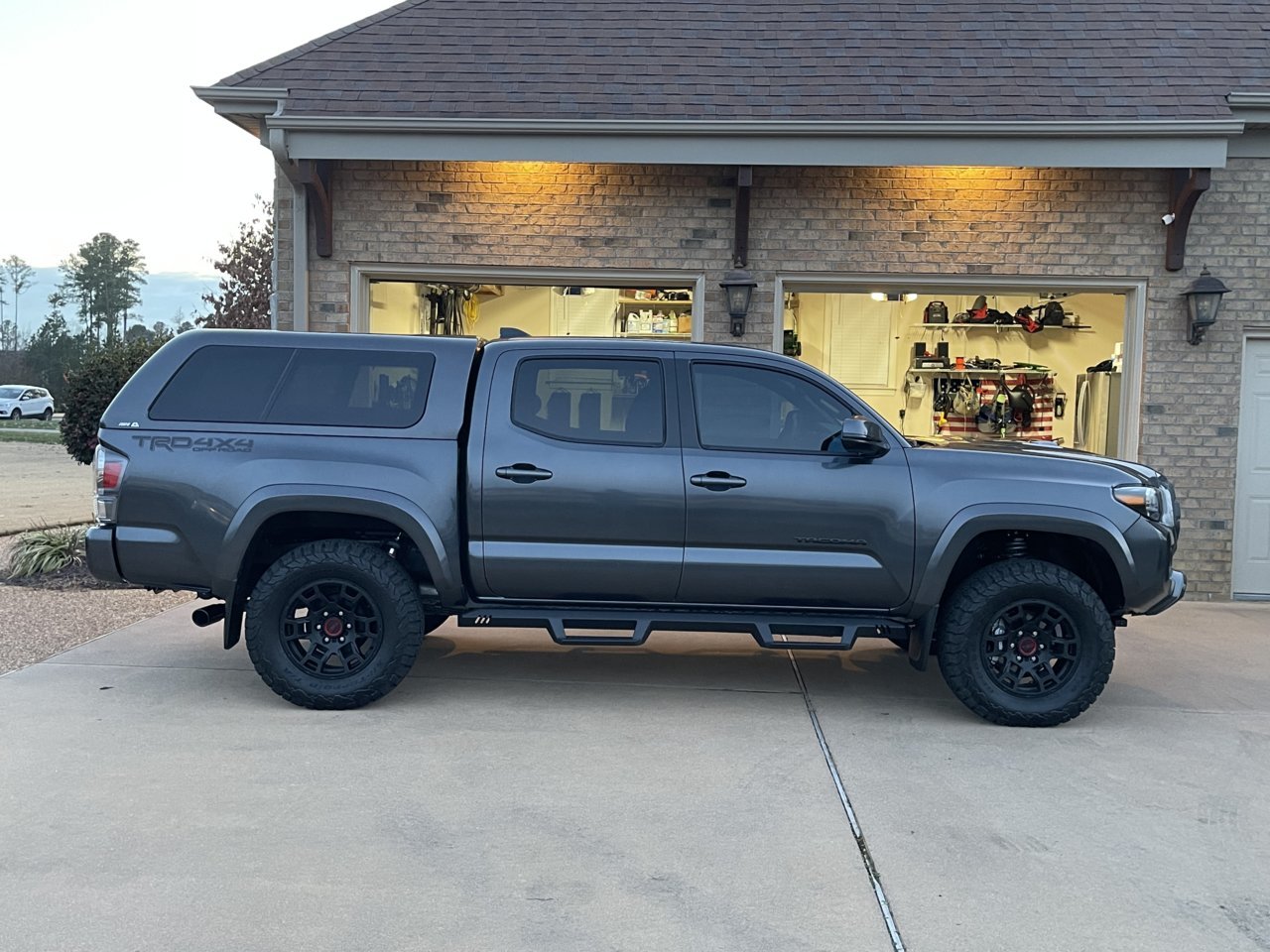

    I’m at
    2” lift 1” rear
    265/70/17
    Not a ton of weight often
    Camper shell
    And eventually cbi front bumper
    The math for me says go 4.88’s
    the more you read people say just go 5.29’ still, more responsive etc etc and future proofing I suppose
    struggle continues because I’m only gearing once unless there’s a failure down the road
    Hmmmmmmm
