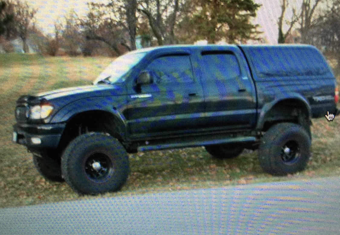

    I did 5.29’s on my 04 it’s what the math said to do. But it had weight in the back 9” of lift and on 35’s and man did it ride beautifully. I just want to have that experience again but won’t be beating on this truck like I did that one or be loading down near as much. Only pic I can find.
