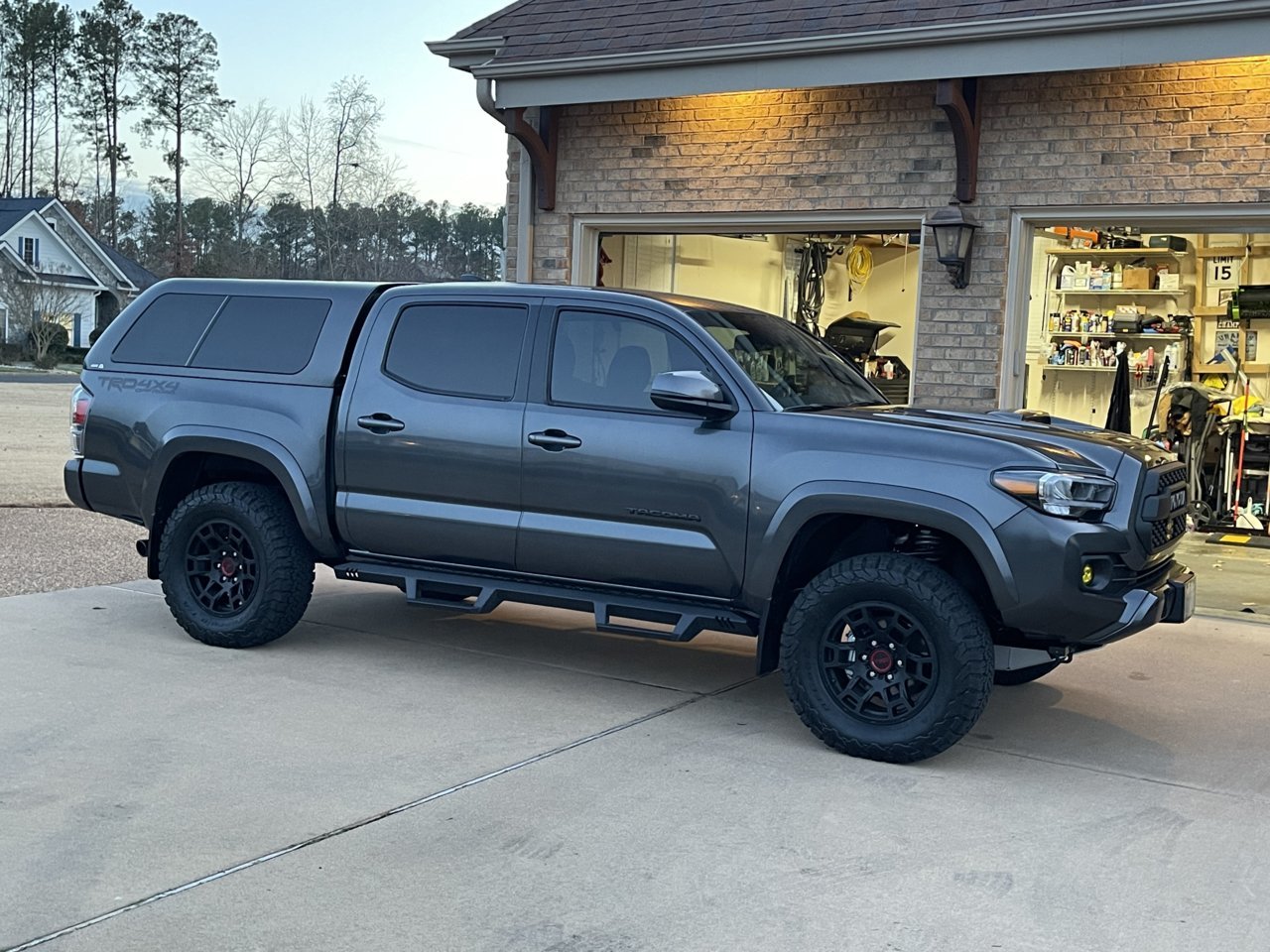

    Yeah I went up an inch tire on my taco
    265/70/17
    And forgot to mention I live on the east coast near Va beach so I’m running pretty flat terrain
    Here’s a pic. Will at times have gear in the rear and most I’ll do up front is a cbi bumper w winch. Basic stuff. No overland build. Maybe a 285/70 after these (but maybe not lol)
