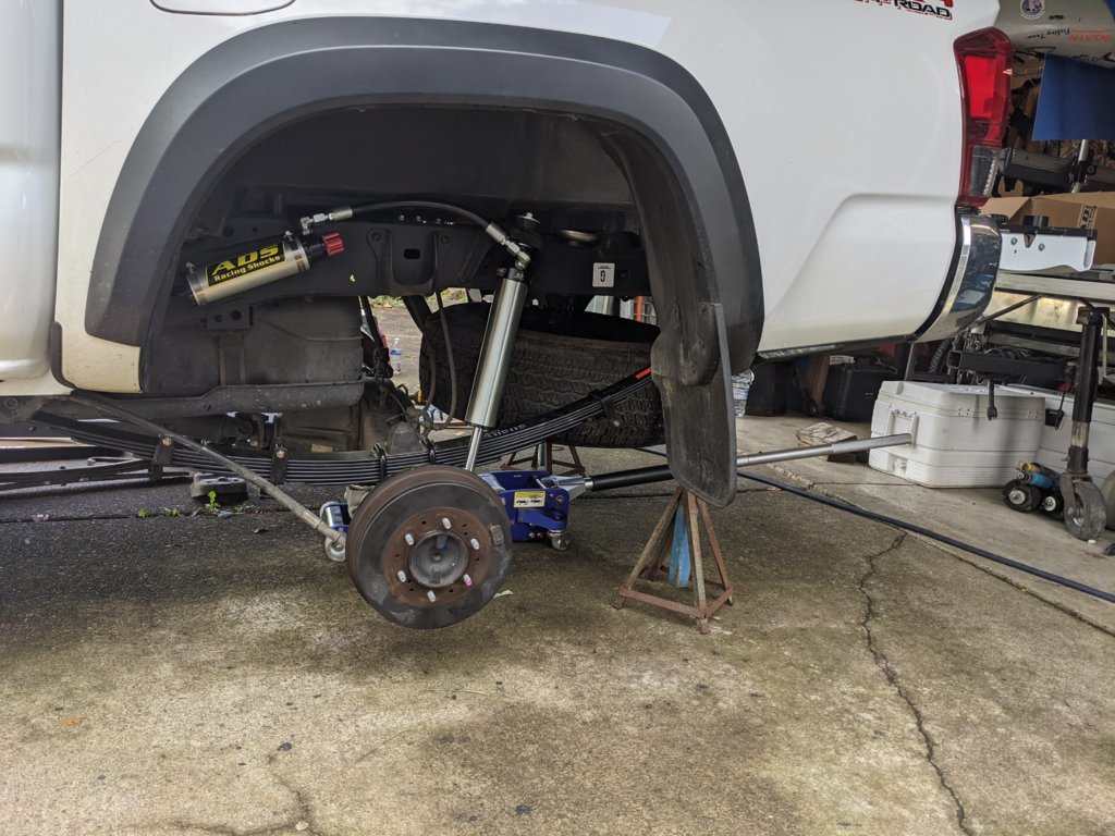

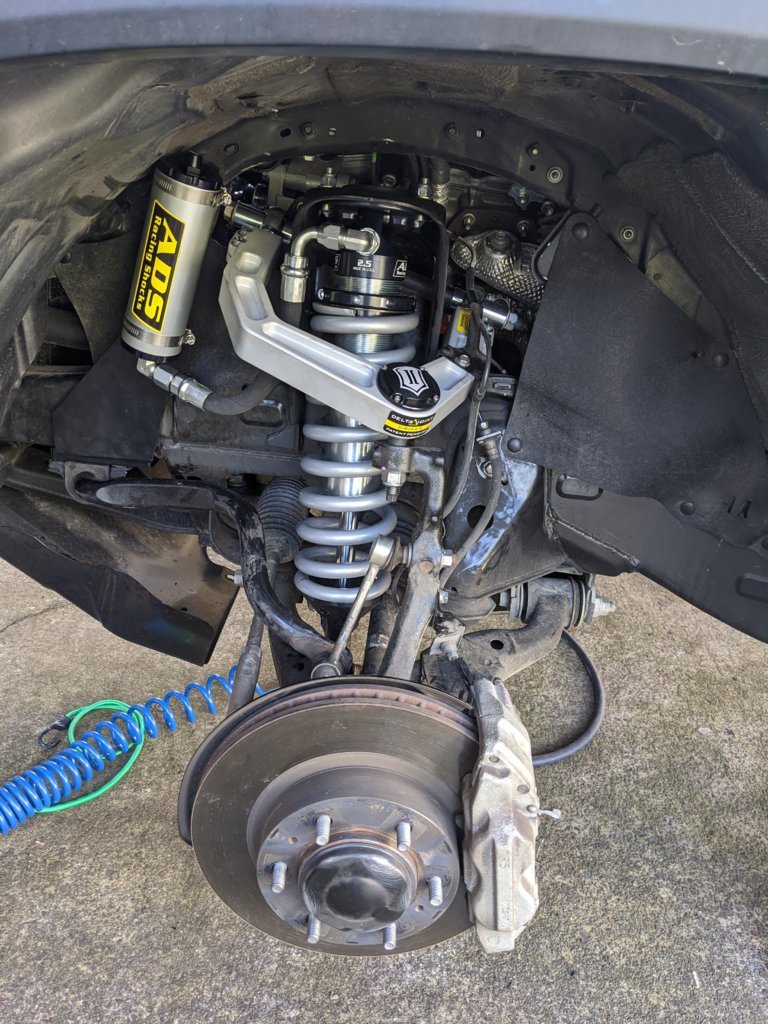

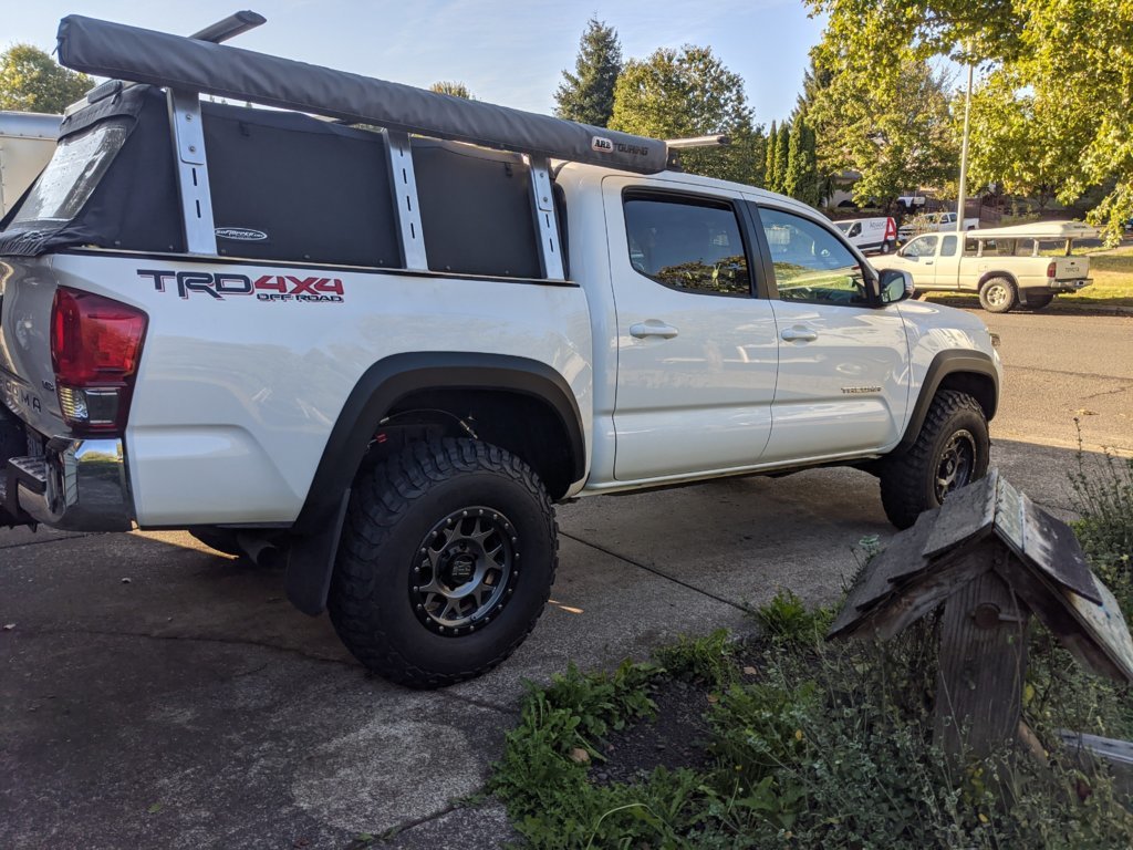

    A combo of things.
    Front:
    ADS 650lb spring coil overs with rezzies.
    Icon billet UCAs with Delta joint and PTFE-lined ¾” FK rod ends.
    DuroBumps bump stops.
    Rear:
    ADS shocks with clicker rezzies.
    Icon RXT leaf kit.
    U bolt flip kit.
    5x BFG KM3 255/85R16
    5x KMC XDS Bully 16" x 8" wheels.
    (I rotate the spare with the rolling 4)
    The rear was actually too high in this photo as I torqued down all the leaf spring hardware while the suspension was still suspended. After I loosened everything, jumped up and down on the tailgate, and retorqued it, it lowered about another inch.
    Also, I didn't have the DuroBumps and U Bolt flip kit installed as of these pics.
    Was another two weeks before those arrived.
    I have it setup for Oregon desert trails, hours of washboard, and rough baby head two tracks, rather than rock crawling and mud bogging.
    Essentially more available droop than lift.
    Also, factory rear locker, ARB front locker and 4:88 regear.
    Zero issues with alignment, rubbing, weird noises, or loss of torque with 33" tires.
    Skinnies for the win! :thumbsup:
