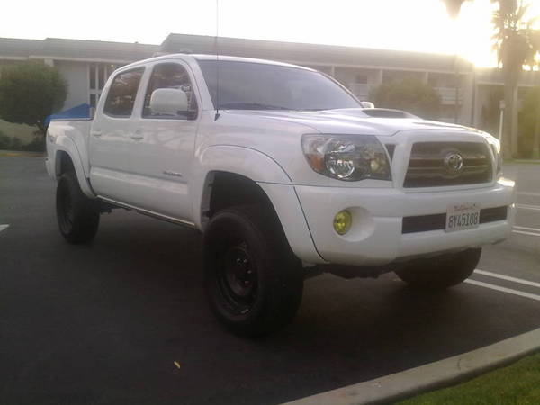

  16. Dec 11, 2010 at 6:39 AM
    #16
    tony92629
    tony92629 Well-Known Member
    Jun 11, 2010
    #38783
    246
    Tony
    Dana Point
    2010 White Tacoma Prerunner
    5100's all the way around. Front set at .85. Camburg Spindles. Camburg Uniball 1.25 UCA's. Total Chaos LCA skid plates. Custom Deaver 10 pack rear leaf spring. BFG AT KO's 285/70/17, Weathertech floor liners, Wet Okoles. Midland CB/PA, Firestick.
    I believe that the adjustable 5100's give you more options and its a decent quality shock. You will be able to adjust your shock to three different settings.
    It was the first mod I did to my truck. Adding the 5100's all the way around. I set the front at 2.5 and added a 1" rear block for a lift. Then I upgraded to the TSB leaf pack for the rear and retained the 1" block for about a 2.5 rear lift. (Slight rake - nice stance). Be sure to get an alignment after they settle a bit to avoid camber due to the front lift. Most people don't and you will see uneven tire wear and a small amount of vibes after a few months with the billy's set at 2.5.
    I just finished installing Camburg UCA 1.25 Uniball - to prepare for the Camburg Spindles (next week). After the spindle lift I will re-set the front 5100's to .85. I wanted a lift without maxing out the front 5100. The spindle lift with provide me with more travel, a higher lift than the 5100's and provide better better/more alignment options - and allow me to upgrade to better shocks to create a decent mid travel set up. BTW, Have you seen the Camburg spindles - they are bullet proof and beefy! :D
    When I first bought the truck in March of 2010 I ran into a guy that did the spacer lift. I liked the look and thought that was cool. I called a local Off Road Shop (Full Tilt in San Clemente, Ca) and they talked me into the Billy's. Best move I made.
    Looking at rear suspension upgrades now to work better with the spindle lift. I will remove rear block and change out the TSB leaf pack to something a little more better. I figure I could run this set up for a while....Until I save a little for upgraded shocks. (FOX, KINGS, Camburgs). Then the 5100's will be replaced.
    I will dial in the suspension (cost estimate around $3000/$3500+labor) while I wear out my stock tires and replace them with new tires and rims ($1000/#1200 tires - ??? rims (undecided).
    Yes - I have the bug and love my truck!!!
