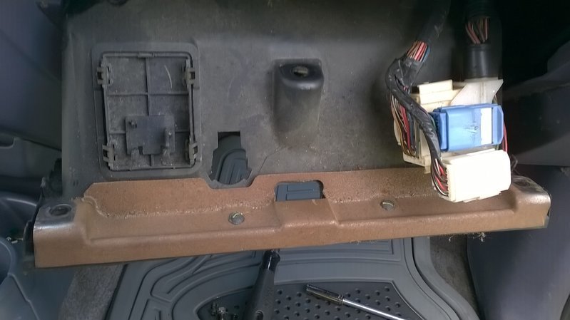

    I took apart part of my glove-box today in order to get to the light socket/assembly/harness that I assumed had fallen into the dash. Turns out I don't have a light at all, just the hole for it.
    Did glove-box lights not come standard? Did it depend on trim level? I have an SR5.
    Is there a OEM harness I can buy to put a light in? There are a lot of tools in my glove-box, I would definitely like a light in there.

    You could always just wire up an aftermarket 12v LED strip tapped into the cig lighter wiring. You just need an inline sensor to turn on when you open it.
    Actually now that I think about it, if you don't use your ashtray it has a small light that you can extend the wiring for and add a magnetic sensor. Weird how they put a light in the ashtray, but not standard in the glove box.

    What I did, was to pick/pull a bulb/socket/connector from another Toyota (Celica, as I recall), and install it into that matching hole in my Tacoma. Then I wired it into the cig-lighter circuit, which means the light is on whenever the key is in the ACC position.

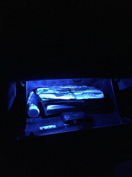

    My 04 Tacoma DC came standard w/ a glove box light. I even changed it to a blue #74 LED.

    Anybody have the OEM part number for the socket assembly? My 2 99's have the connector ready to go right next to the hole in the roof of the glove box. I'd really like to just plug a socket into that and add a bulb and call it good.
    Bonus points if you can tell me the same for the ashtray light, I have a plug for that as well but no socket was installed.
    I checked both with a test light, the ashtray dims, the glove box is either on or off, goes on with the parking lights.
    THANKS!

    Here is the part number for the lamp housing 81260-33010. It takes a 74 bulb.

    The OEM part is like $12 and you can install it all in under 10 minutes.i did it in both my trucks and love it, can’t believe I went years without!
