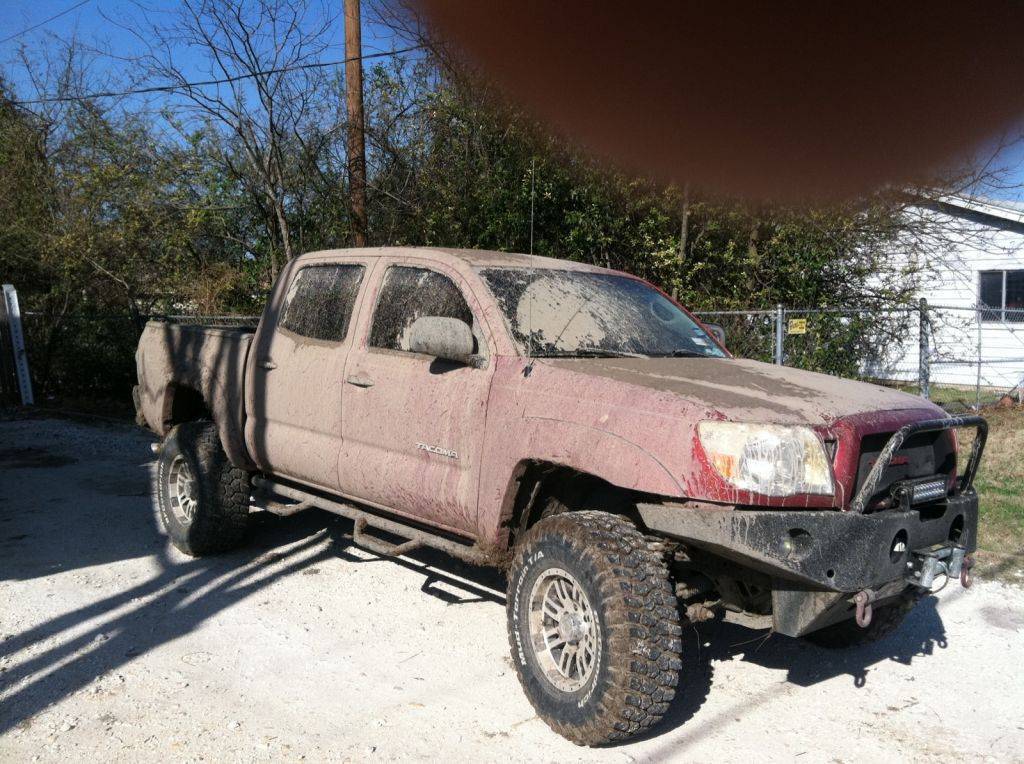

    Good choice brother! keep in mind you will need a rear shock too
    This is how she will sit with 285/75's
    EDIT: and the expos handle extra weight really well!
