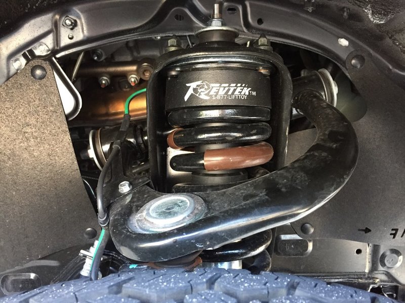

    I recently installed a revtex leveling kit witch lifted the front 3 inches and the rear 1.25. I also installed Belstien 5100 front and rear. After I installed it the place that did the work said that my alignment is back to factory alignment. After ready all the forums it sounds like that is not possible. Sounds like I need to get a upgraded control arm. I was looking at the Total Chaos control arm. So my question is 1. is there a need for a upgraded control arm with my set up 2. what is the best brand to purchase? 3. Once you install the new control arm is there a requirement to grease it so it wont squeak?

    I think the best thing you could do is post your alignment specs on here and have some other guys with more knowledge take a look at it. From the sounds of your 3/1.25 lift you will need aftermarket UCA's to get your alignment closer to factory specs, but if you don't feel any driveline vibes or anything of that nature and your comfortable with the ride then you COULD not get them, but it is advised. My question to you is the revtek lift an above coil spacer lift?

    If you're happy with it - don't change it. If you start doing more offroading - it'd be a good idea to "space out" your front bumpstops by about as much thickness as your top plate (the thin one above the coil, not the thick one in line with the coil)
    That'll protect your shock so that the bumpstop takes the load of bottoming out, rather than the shock. The shock isn't designed to take that load and can break. That fact is a source of a lot of the "hate" on TW towards space lifts.
    If you're happy with how the truck drives, don't change the upper control arms. If you find it "twitchy" (not centered enough, excessively responsive to steering input) then think about switching control arms.
    You'll get a lot of advice on here to junk everything you just did and start over. But a LOT of folks run Revtek lifts and are happy with them. Don't second guess a decision you already made. Be happy.
    If you start doing more offroading and find that your suspension is limiting you - THEN think about upgrading.
    On pavement, there's not much to recommend more expensive coilovers vs. the spacer lift.

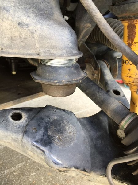

    Spaced out bumpstops with 6 fender washers:

    That seems kinda funny advice. Basically, using the revtek "in line" spacer has exactly the same effect as adjusting the position of the spring perch on the 5100 shock.
    But like I said - the Revtek isn't hurting anything. Run what you've now got until there's some reason to change it.

    ok I think I am going to replace front strut spacers with
    1. OME 887
    2. 1/4 top plate spacers for driver side
    3. Light Racing UCA or icon UCA but icon is pricey as hell.
    would that be a better set up then whats shown above?
