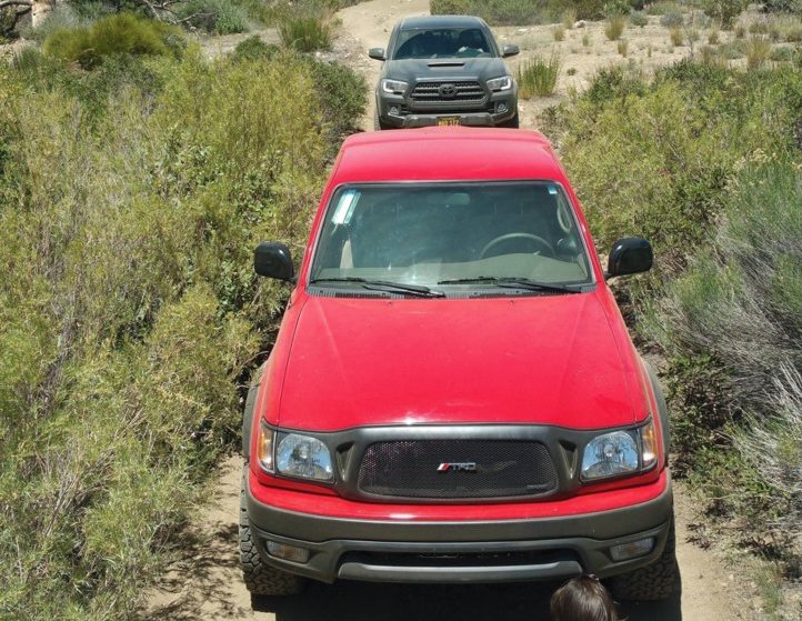

    easy way to remedy that, just Plasti Dip the chrome! :D That's what I did to my '04, blacked out the chrome bumpers front and back with plasti dip. Easy to do, did all the chrome all around in one afternoon. It's held up really well.
