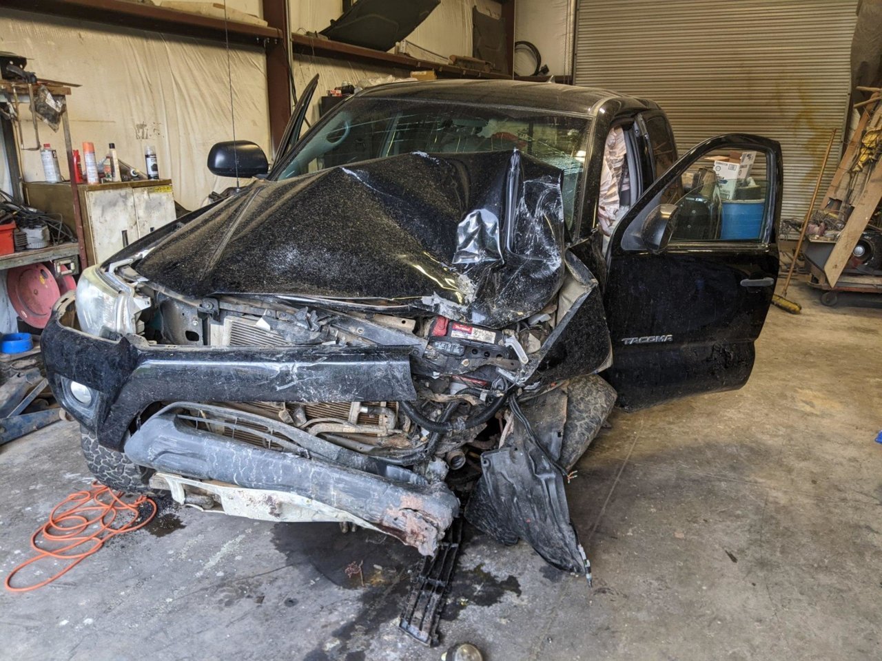

    2AD9D1B2-ED64-4C69-BCA7-8AFCE612AC89.jpg Well I got a photo of the truck. Excitement level dropped a bit but I’m gonna go check it out still. What do y’all think?

    Nothing yet
    Nope!

    That's a no from me dog.

    Looks like a Gen2.5 TRD Sport, but really an '08 TRD OffRoad
    TRD Supercharged / OTT Tuned
    Without any underhood visuals, I would think the cooling system for the SC would need to be replaced. The SC coolant reservoir and heat exchanger are probably toast.
    Wonder if the impact damaged the SC nose cone, etc... if so, I think its too much of a risk for purchase.

    Philhutch80
    Philhutch80 [OP] Well-Known Member
    Oct 19, 2020
    #344257
    145
    Phillip
    2010 Silver 6spd 4x4 Crew Cab
    I do not know enough about the system to understand what other components would be potentially affected, this seems like a great place to start though. Sure I have read the install manual but it helps having a truck in front of you. Hopefully gonna go check it out the next day or two. Thanks for the replies everyone.
