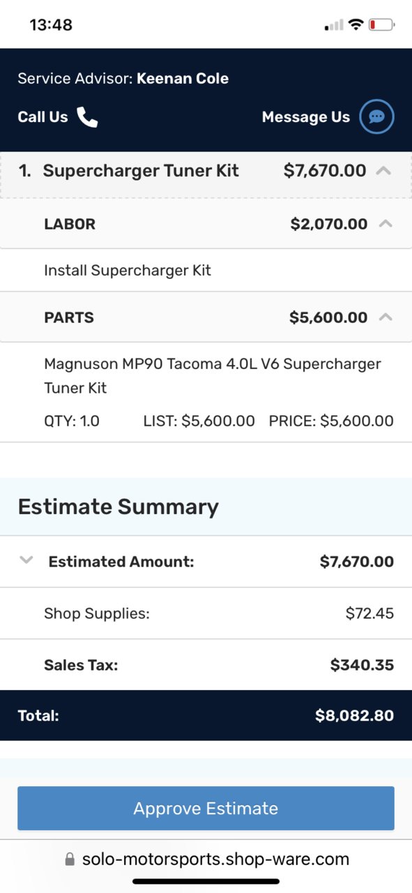

  19. Sep 21, 2022 at 11:59 AM
    #39
    Philhutch80
    Philhutch80 [OP] Well-Known Member
    Oct 19, 2020
    #344257
    145
    Phillip
    2010 Silver 6spd 4x4 Crew Cab
    Insurance has already quoted him a value higher than that we have agreed upon. Even if I need most of the ancillary pieces, I still come out ahead from a cost standpoint with an S/C rebuild. Without it becomes even cheaper so it is a win-win.
