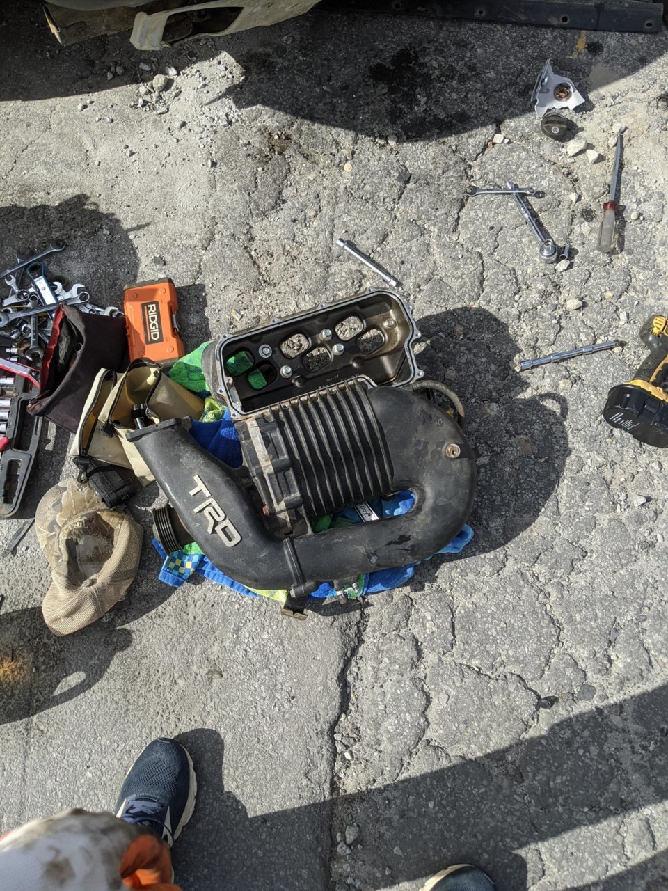

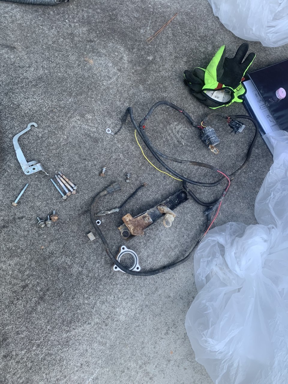

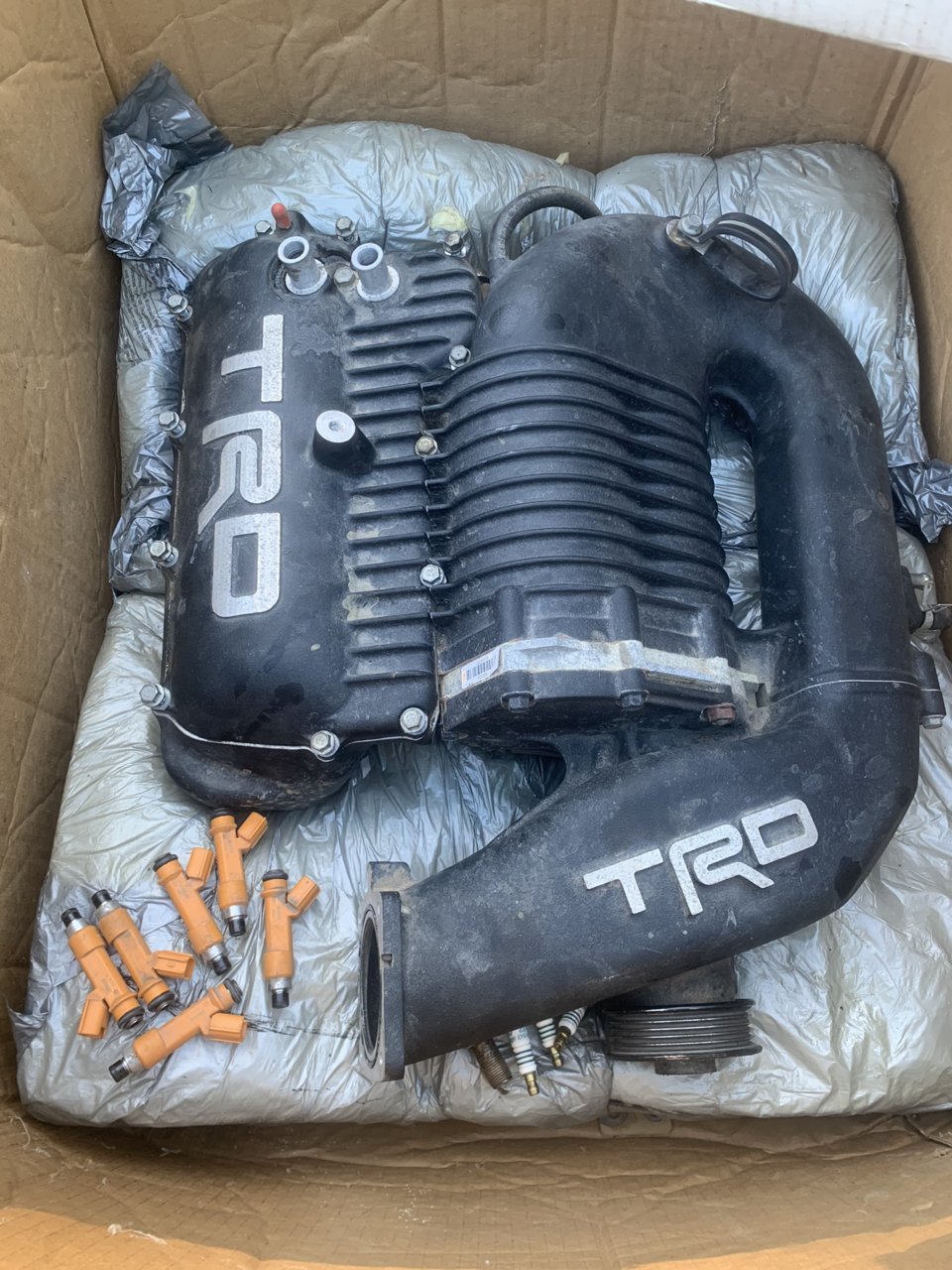

    Gentlemen… we have an Eaton/TRD Supercharger and most of the supporting hardware. The nose cone looks ok and the whole pack spins free and with ease. Out of concern for the impact the motor went through I’m still thinking of sending the S/C in to SCOL for a rebuild before I install it. Unless anyone can recommend against it here. Once again, I appreciate the support of the community here. I will keep y’all updated as the build progresses. I am sure there will be questions along the way. 1A74DEEF-1653-4ED6-B923-3600A9D27670.jpg 0770B6FA-4CD9-412A-B24E-864FB1F8FF05.jpg

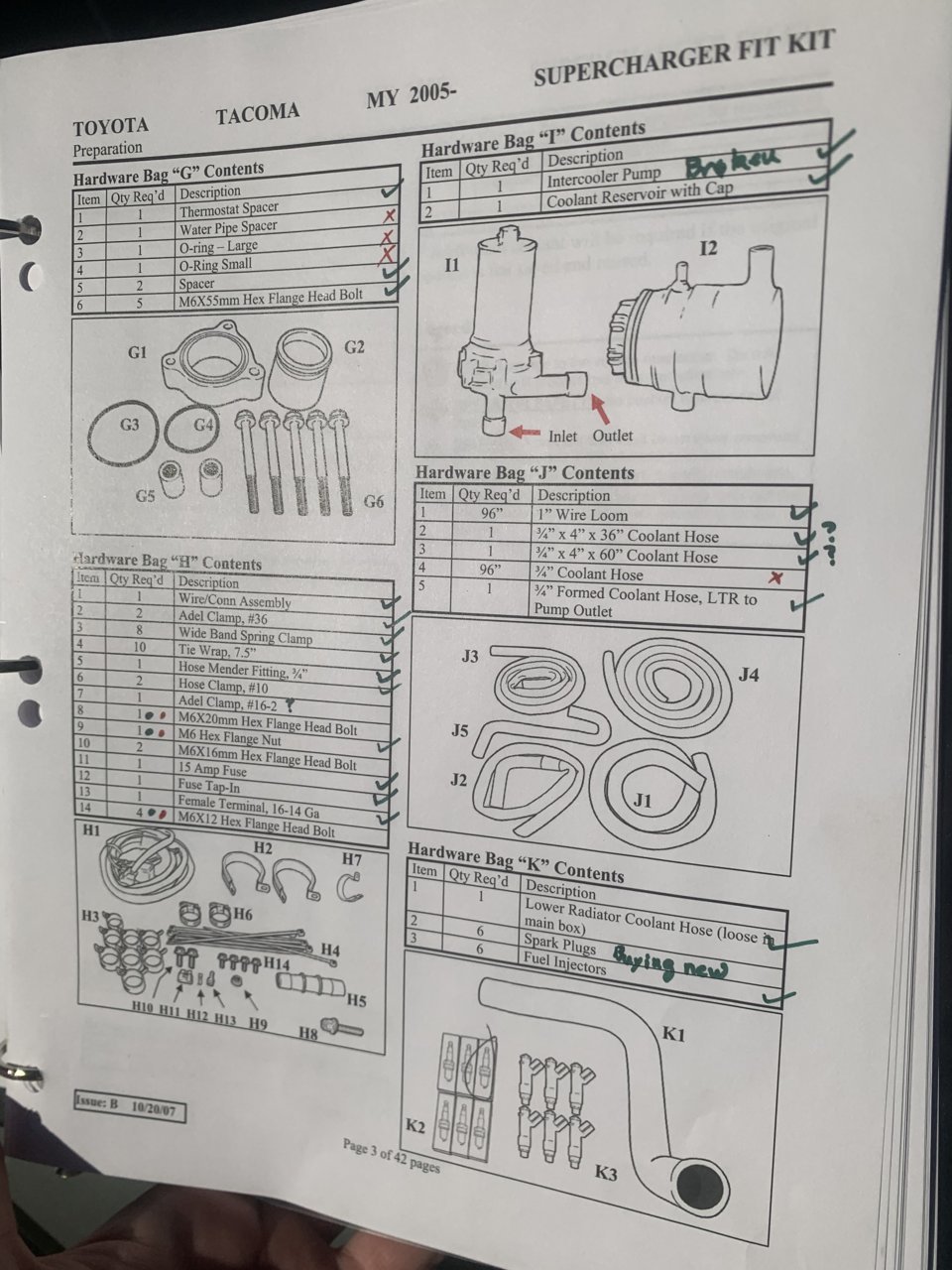

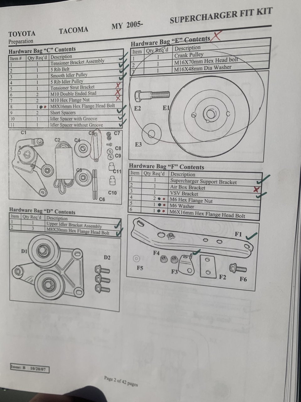

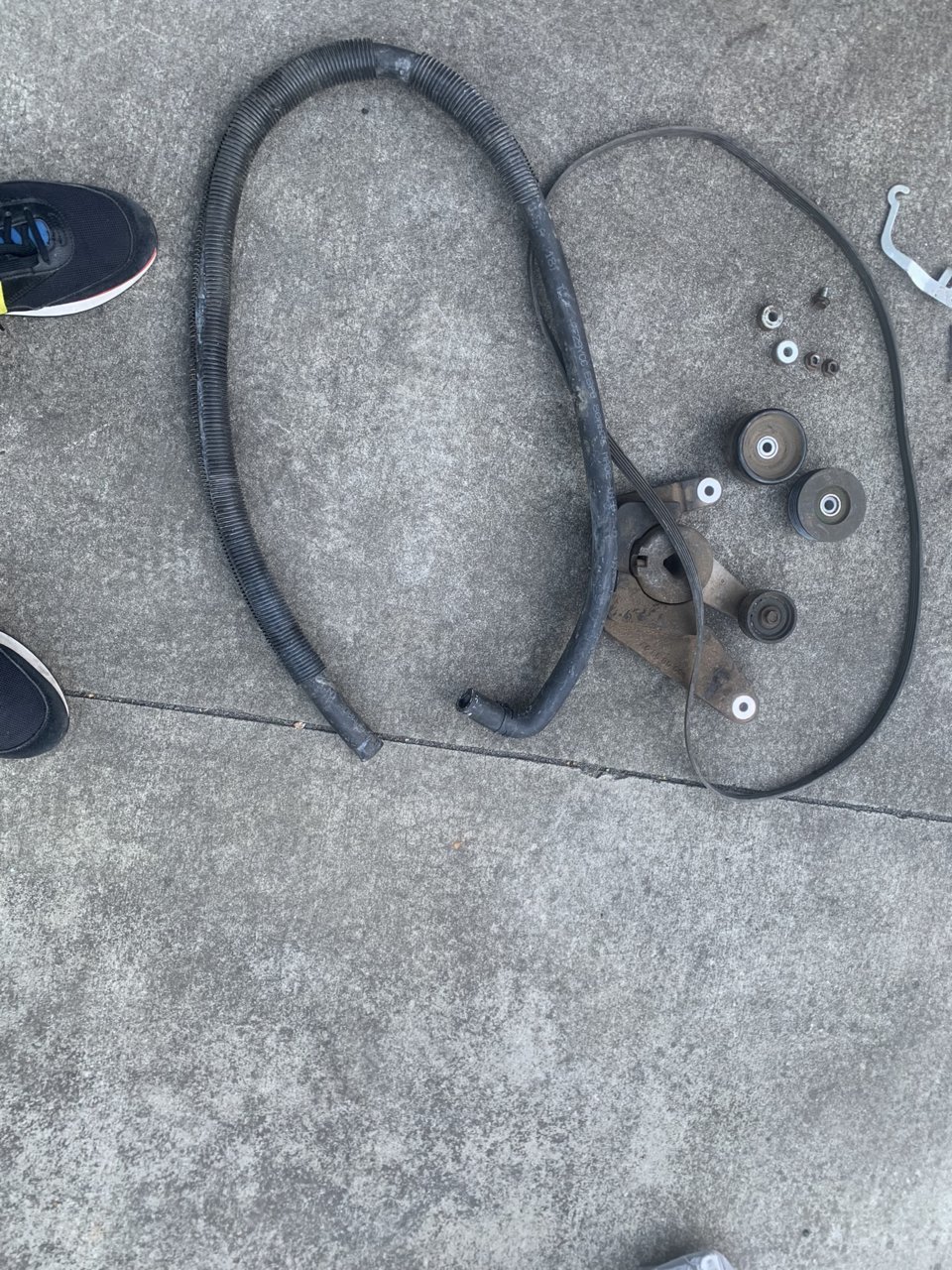

    Ok gentlemen, here is all of the parts & hardware and the parts list I’ve compared it to. If it has a green check or green writing I have it. Red x means I don’t have it. Almost all of the hardware has a green and red dot currently and as I work out locations for them I’ll eliminate the hardware from the list.

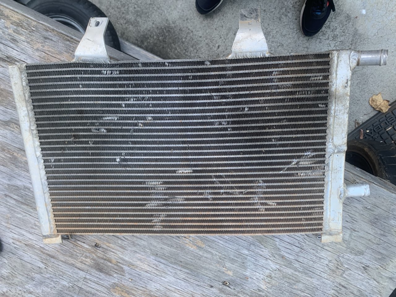

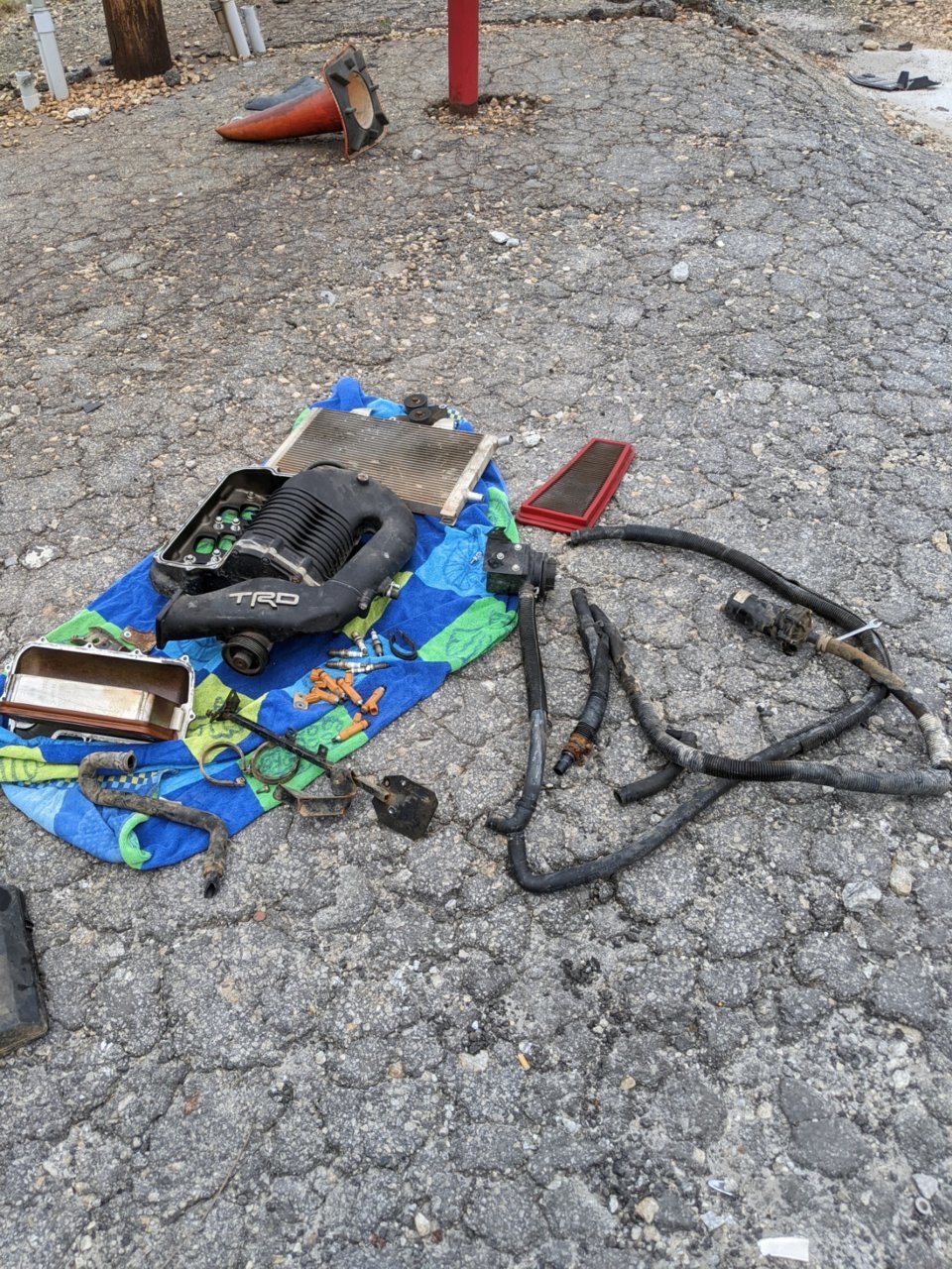

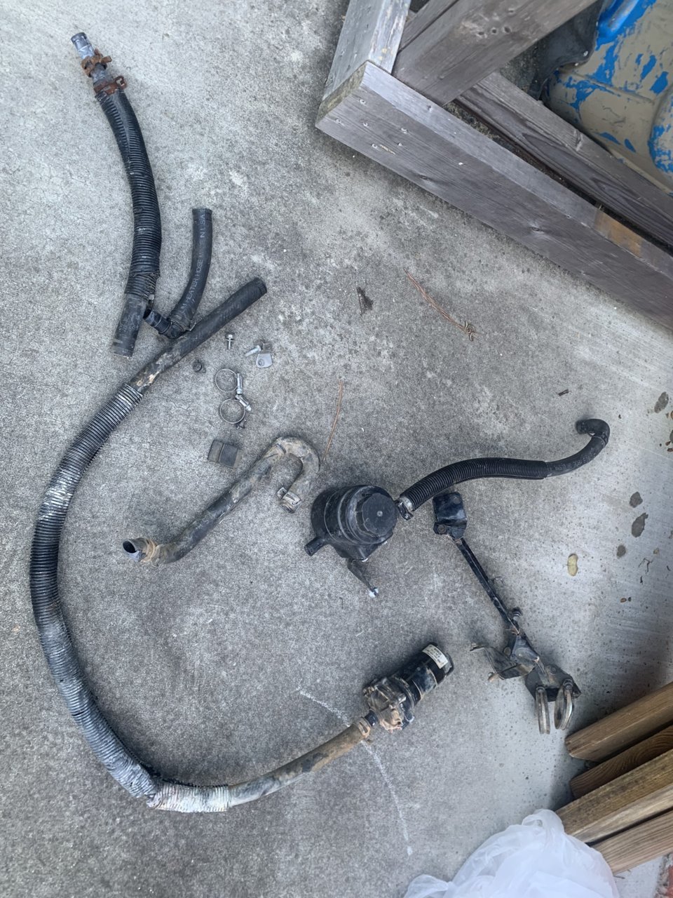

    Supercharger spins free and doesn’t look damaged at all. I’ll need some new hoses, plugs and a water pump for the AWIC system. Otherwise once this is back from a once over from SCOL it’ll be install time. Any feedback welcome. EFEC4C76-AF8D-46A1-9278-66B3966AA644.jpg8A960EAC-2CF9-4FBC-BC71-398992422724.jpgD7D69126-A157-44F0-B05C-F74A993C9F82.jpg5385FE85-12C9-4E6E-8A3C-53F37C19DEE0.jpg9E6B4FD8-62D5-4D46-82D8-0F2CFEFBC8A1.jpg082D5E47-0A22-43BB-A253-3CAF1CCAFC45.jpg066125C5-7189-4CE8-9927-77DAA42483AB.jpg1C9C8E44-ECA8-4B20-B6BA-410C76853D06.jpg

    If you get the fit kit parts it’s worth if you can piece it together. But def agree would need to see it. But $2500 is steep if all you get is the blower.

    Missed that last photos that does not seem too bad. I am swapping out my coolant pump and have the resi if yours is messed up.

    The reservoir is actually ok. Gonna get the upgraded water pump though and look at another reservoir that I can add a thermoelectric cooler into. Gotta keep those IC temps low. Anyone seen any double insulated reservoirs?
