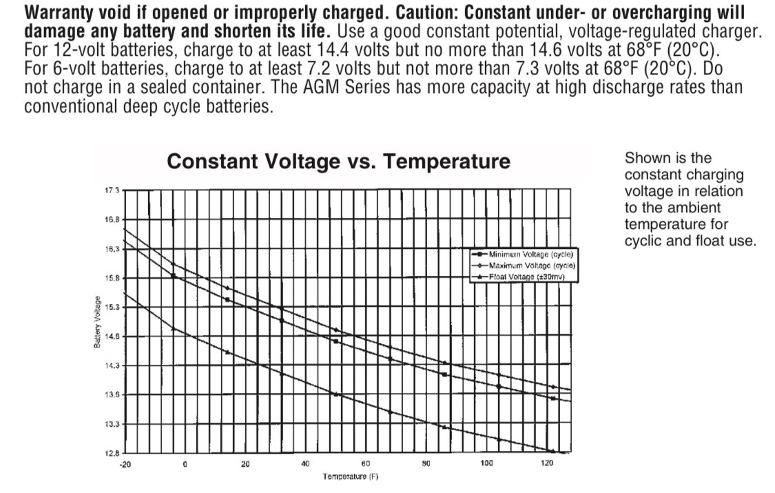

    An AGM won't fail catastrophic from being charged at the incorrect voltage. They slowly sulfate resulting in the capacity decreasing over time. Not using the correct charger will just shorten the usable service life of the battery.

    AGMs prefer more voltage, not upgrading it or charging it won't cause it to fail, but the AGM will last longer and perform better with a little maintenance.
    People always use non-fail examples, but it's not the point.
    AGM is fine for tacoma, but not ideal. I just recommend a trickle charger from time to time. (which is actually good for any battery)

    Total waste of money and they require higher charging voltage.

    The recommended charging voltages for the different types is very well documented. This is why chargers have a different setting for AGM vs flooded.

    How goes the learning journey ed? I did about 5 minutes worth of googling and found they do in fact have different charging requirements than a standard flooded battery. Turns out there are documented efforts all over the internet on this very thing.
