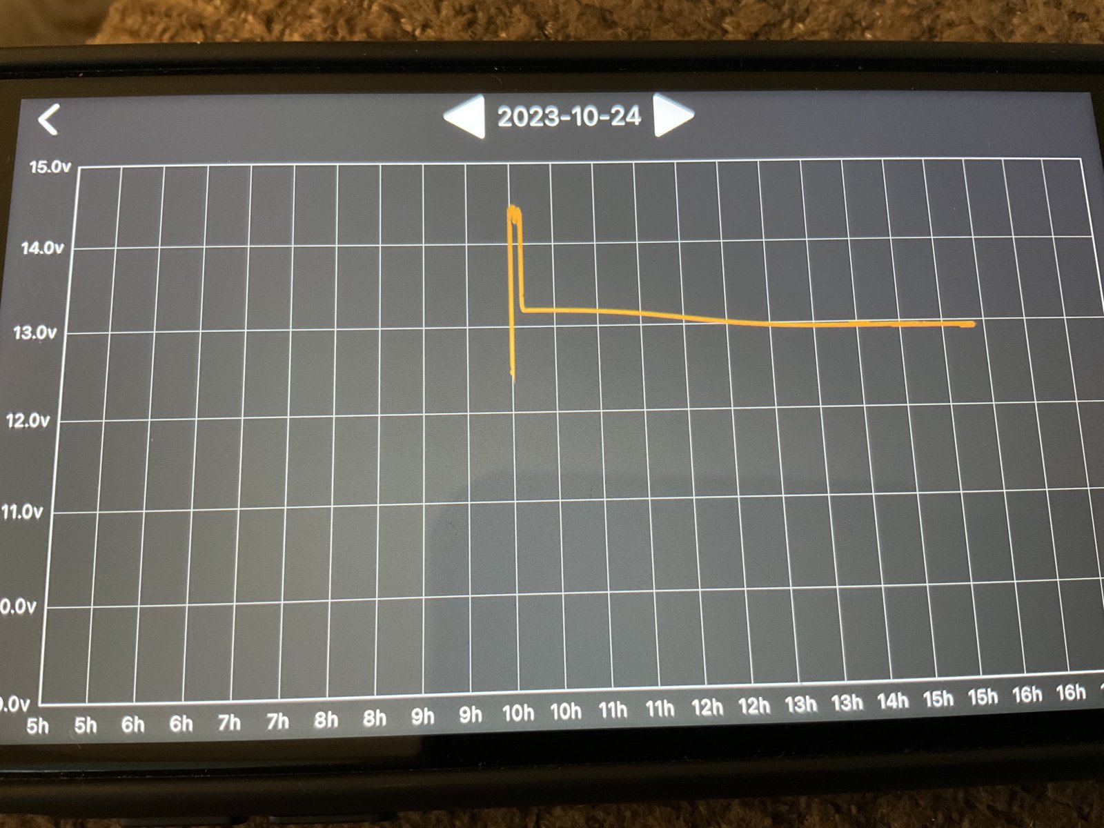

    I’ve had an AGM battery for years and have read several posts about how it needs 14.4 volts to charge and to get that you need to retune. Well, I just bought a battery monitor and installed it today and it shows that the charge rate is 14.4 volts without any modification.
