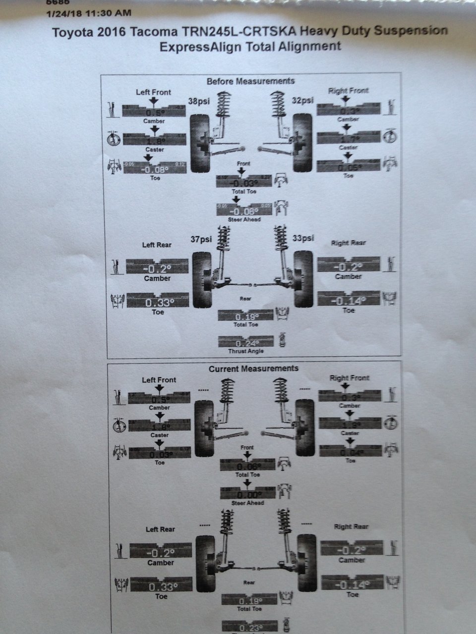

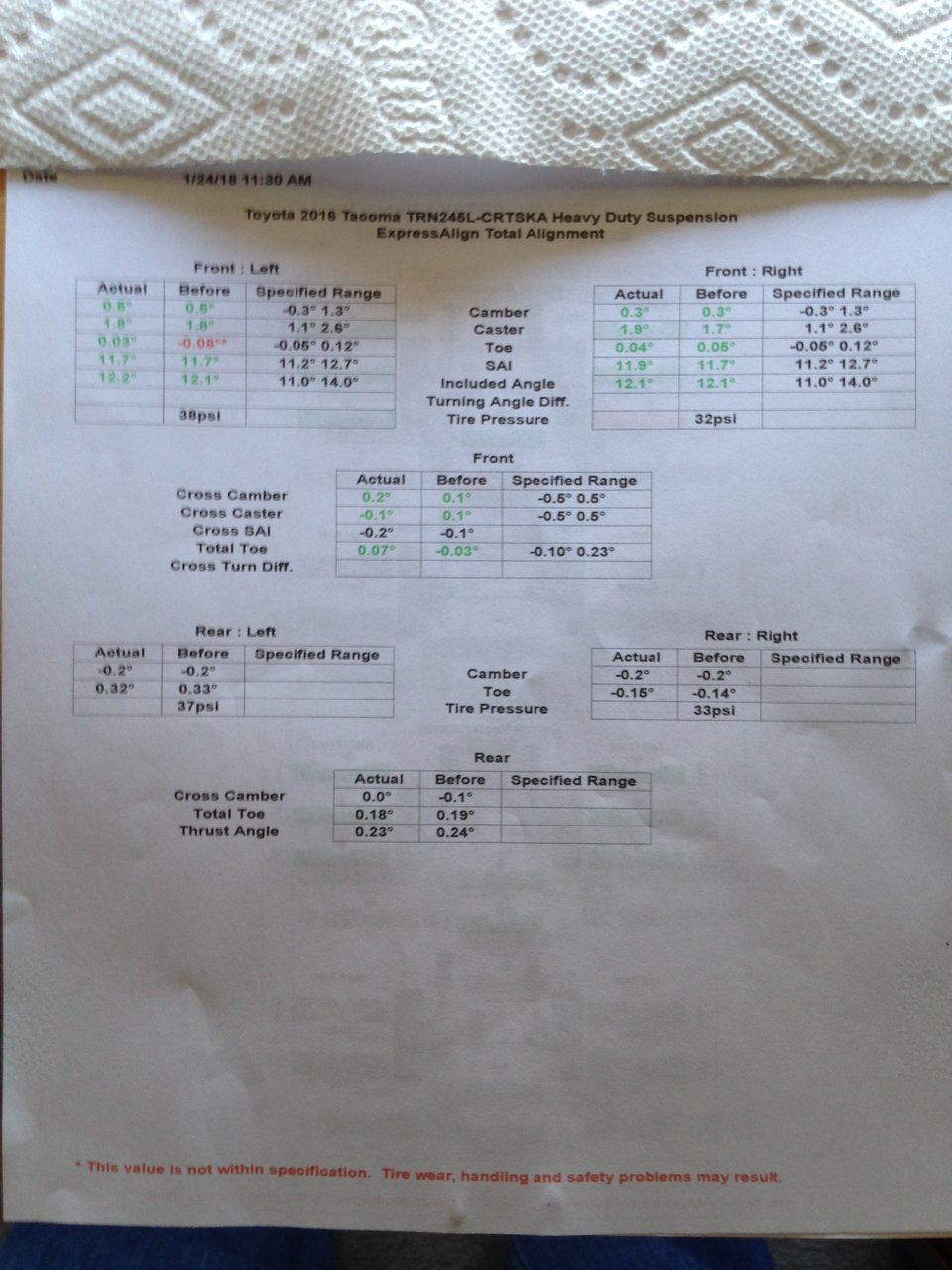

    UPDATE
    Just got home. Here's the take away print out:
    The lower black and white sheet was not going to be given to me but I insisted on getting a copy.
    Service rep spent time explaining the front end part of the alignment because the left front was out of alignment spec range. I made sure he explained the rear end part as well.
    This is probably one of those things where it's a good idea to have it done. Local prices for alignments go for about $139.
    Does seem to ride smoother. This might be due to the tire air tech over inflating my tires. The last time they read 38 psi...small detail they should get right. My understanding is that tires should be 33psi.
    I'm going to inspect the underside to see my new shock.
    Anyhoo, what do you all think?

    Why are the tire pressures of your left tires more than 5 psi over the ones in the right. Maybe that caused the misalignment?

    I wondered about that too. Would it affect alignment?

    Rear thrust angle sucks; pretty common though.
    My first and last alignment @ 3,600 miles was 0.02 thrust/0.18 total toe.
    I'm at 22,000 now; makes me wonder. Spring fatigue, taco lean, frame twist, bushing deteriation...
