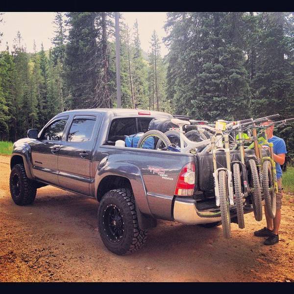

    Haha. I'm buying a snorkel once the Garage/driveway is ready. Currently I'm waiting for the curb cut. I want it in that garage for it because of me being a noob
    Here's a pic

    I have Fuel Hostage 17x9 wheels and Goodyear Duratrac 265/70/17's Love em!!! and i only rub when in reverse and full lock, just that plastic tab on the inside of the fender.

    I believe these are the specs, Fuel Hostage 17x9 6x5.5 -12 offset 108.0 Bore 4.5" backspacing. Hope this helps

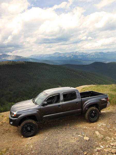

    I had 17x9 with 285's. The only bad thing I noticed is that the sidewall of the tire doesn't hang over the lip of the rim that much with a wider rim size. The down side to that was lots of rim damage from rocks. You can see the silver ring around my rim in this picture. They are different (35") tires though. On-road no problems. Just when rock crawling. The rim's edge will be more flush with the sidewall of the tire.
