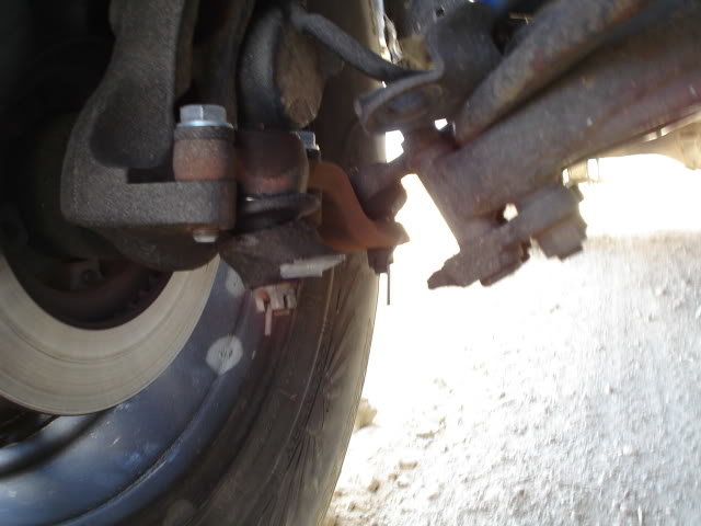

  14. Nov 30, 2012 at 6:29 PM
    Trifenix
    Trifenix Well-Known Member
    Jan 11, 2011
    #49090
    1,235
    so cal
    99 LT 5 lug Taco
    haha we all have pics of our broken lbj!

  16. Dec 1, 2012 at 11:36 AM
    #16
    Joels98taco
    Joels98taco Well-Known Member
    Mar 10, 2011
    #52782
    2,249
    joel
    chino hills
    98 5 lug tacoma
    fabtech 3" spindles, icon aal, 10" bilstein 7100 rear shocks, daystar coil spacers, AFE Pro Dry-s drop in filter, sony head unit, 2 12" pioneer subs, pioneer 6.5s all around, custom 1.25 lift shackles, custom lower ball joint brackets fabbed by me
    ^^those arent mine lol i swapped mine before they broke :D

  18. Dec 1, 2012 at 4:50 PM
    #18
    Joels98taco
    Mar 10, 2011
    #52782
    2,249
    joel
    chino hills
    98 5 lug tacoma
    not the balljoint itself but the bracket that attatches it to the lower arm
