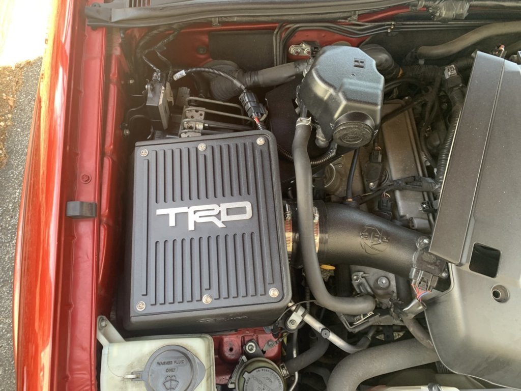

    That and some of them look pretty wicked, I think AFE does a bang up job, especially with some friendly assistance from TW magic-man Coupe:thumbsup:2D55F99D-4A2A-47DB-81CA-9827AC1E7DC9.jpg
