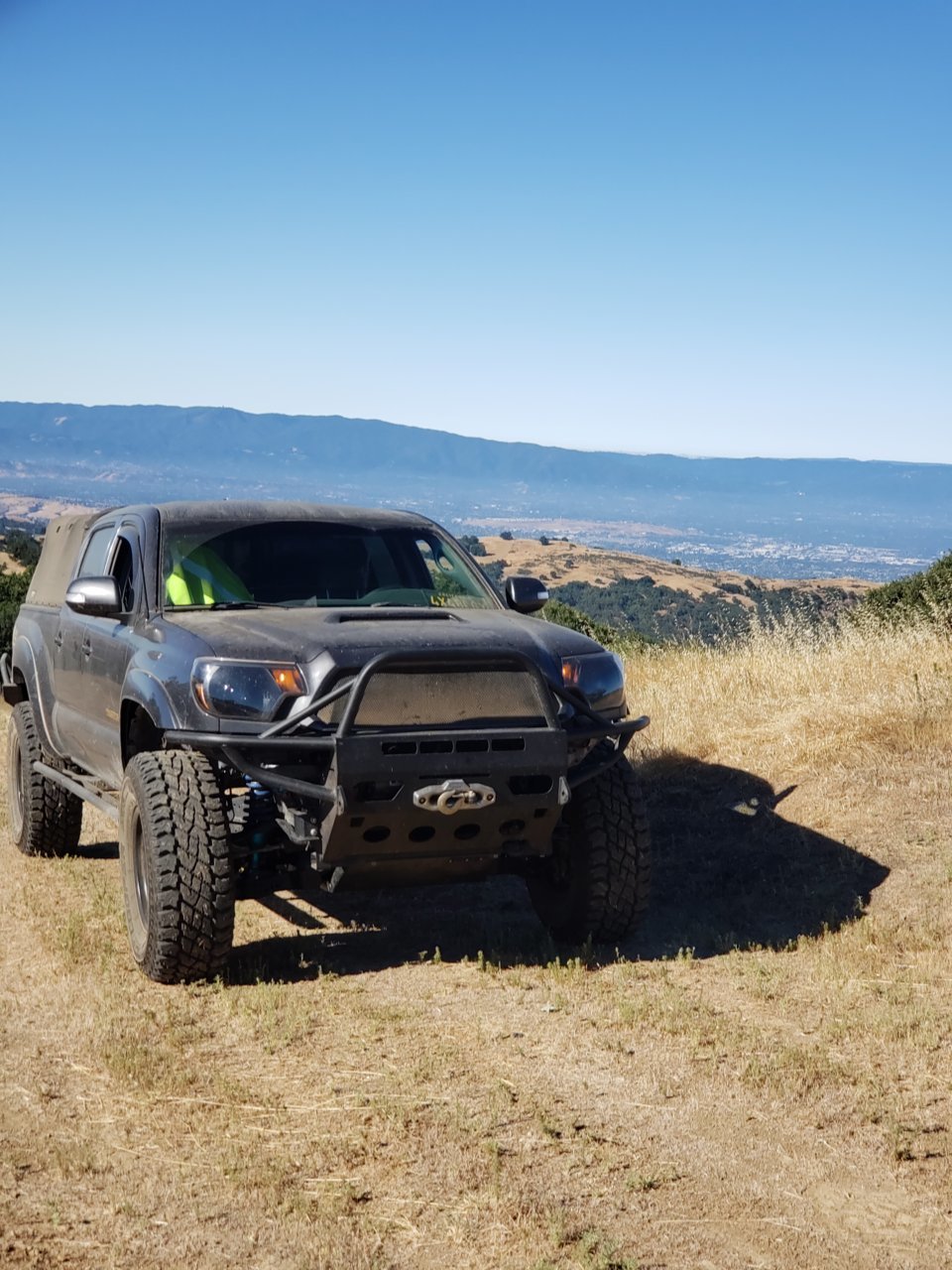

    You guys are making me second guess my decision haha. Haven't pulled the trigger yet but still. What setup are you running?

    2.5 Kings Ext Travel w/ clicker resis, Total Chaos UCAs, stock UCAs still, 35s, regeared to 4.88, arb locker in rear, deaver leafs, BAMF hangers, extended billies in rear b110s (replace with kings once money is right and do shock relocate), bruteforcefab hybrid front bumper and HC rear, BAMF sliders, and full set of BAMF skids (5 installed, 1 in garage waiting). 2 kids, 2 jobs, and this truck is my peace away from my hectic life, something just for me. Work in progress for sure.TC spindle gussets, whiteline bushings for stock LCA, and Marlin LCA brace sitting on shelf and pending installation.
