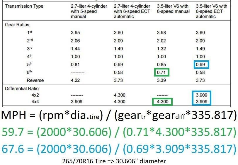

    My 2018 did the gear hunting thing, my 2020 does not. I must say cruise control takes some getting used to. Drove it 1200 miles (total) back and forth to my home state of Nebraska from IL. First time the 2020 was on a long trip. The long rolling hills of Iowa was the area that the cruise control was either quite good (helpful) or a detriment at times. Got 19 mpg, I think 2000 rpm at 80 mph. Drove extremely well but did feel a bit under powered on longer climbs, but overall was quite pleased with the driving. Seats were comfortable and suspension took bumps like a champ.

    At 80 mph my auto v6 spins more rpm than that. Thought all these v6 automatics were geared the same?

    OEM wheels, tires and diff at 80 mph, you will be at or around
    • 2000 RPMs in 6th gear
    • 2400 RPMs in 5th
    • 3400 RPMs in 4th
    • 5100 RPMs in 3rd
    • 7200 RPMs in 2nd
    Stole this from somewhere on the forum...
