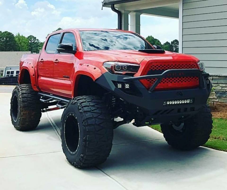

    Like @ChadsPride said, "yes", and here's proof why both are better.
