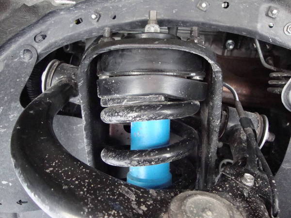

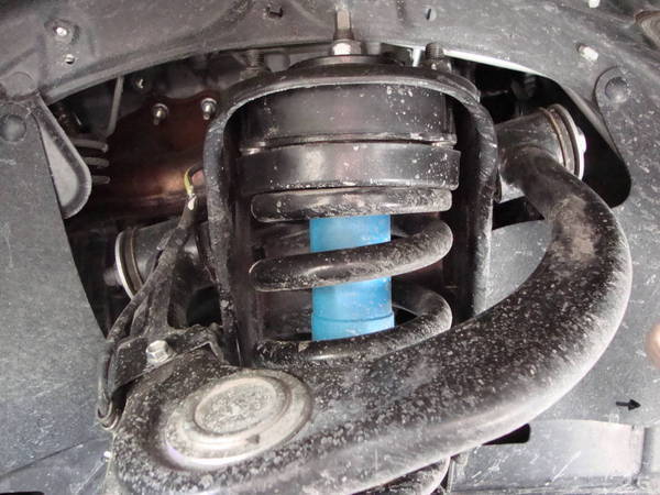

    Polyurethane is a type of plastic. Can you take a pic of this spacer for us?

    Polyurethane is a relatively soft material, commonly used as a replacement for rubber bushings in control arms. It really shouldn't be used as a coil spacer or top plate spacer. Do you have a photo of the setup?

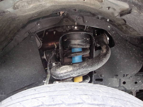

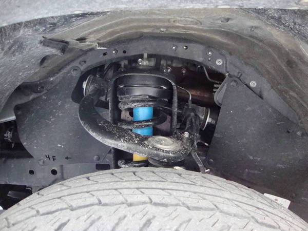

    OK, got some of the pics of the poly spacers in my profile pics, check em out

    Yeah, I'd ditch them.
