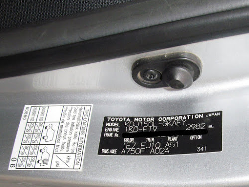

    The Taco engine is pretty strong. You can hammer it at redline all day if you wanted to. Downshifts that bring the revs up to 4000-5000 rpm won't hurt it. Meanwhile the A750F 5-speed auto is designed for more demanding applications (e.g. 4Runner V8 - 306 lb-ft, Land Cruiser Prado diesel - 295 lb-ft). In fact the 2010+ Prado has a manual (+/-) detent in lieu of the 4-3-2-L shift gate:
