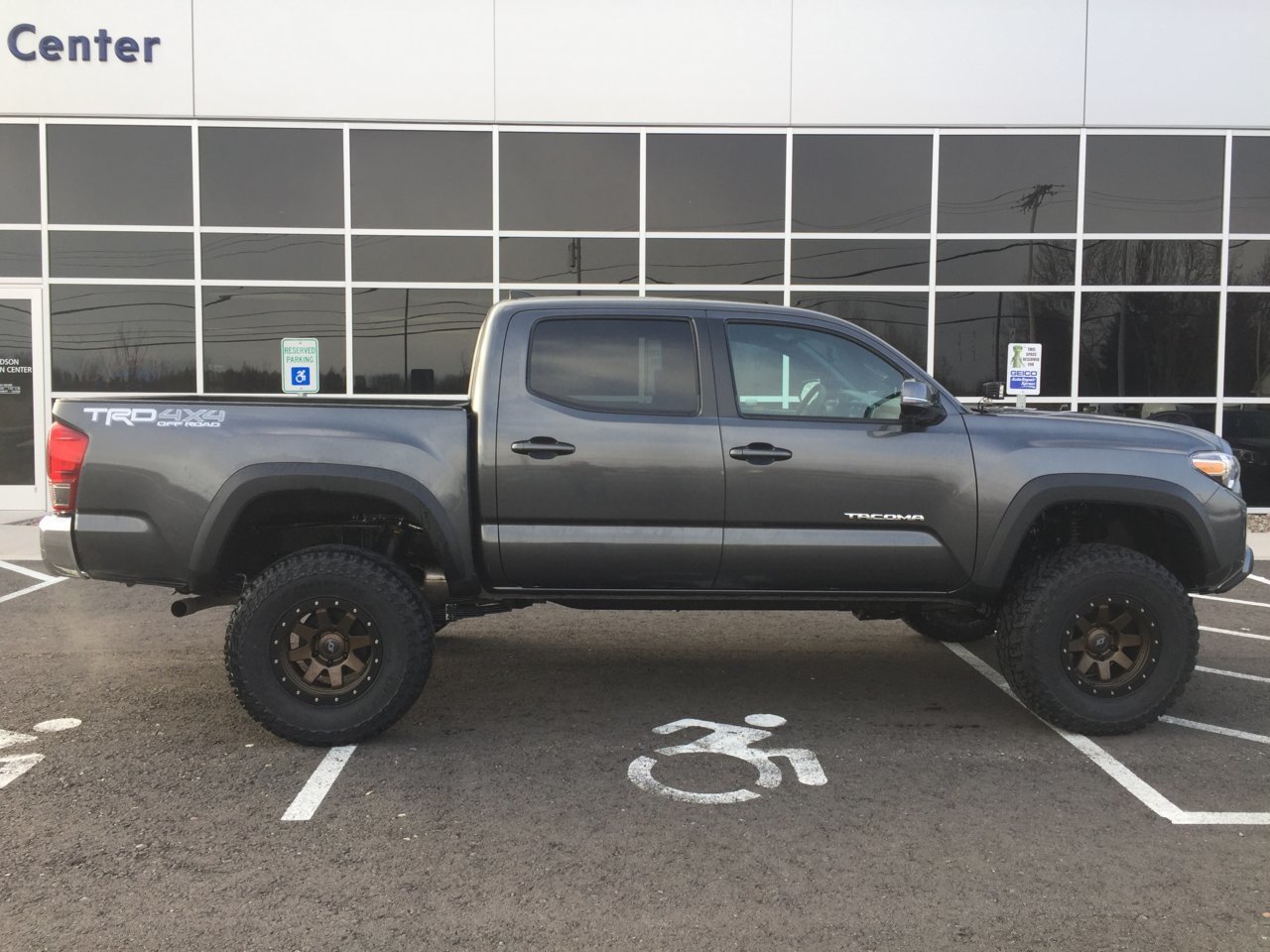

    Would this be the type of setup I need to support overlanding weight? It’s the complete OME setup from headstrong off-road.
    Coil Selection: 885X
    Strut Selection: 90021 Soft Ride Strut
    Strut Assembly: No Assembly Needed
    Upper Control Arms: No UCA's Needed
    Dakar Leaf Pack : Heavy Duty
    synaps3 likes this.

    Yes... that’s perfect. Pending your front end plans. IF you’re gonna armor up/ heavy front bumper and or winch go 886X coils. Otherwise that’s perfect. I skipped UCA’s in my Lift also from @HeadStrong Off-Road and got things into alignment with no issue.
    901127CB-6B32-419C-8BB1-7E94938A67C8.jpg 309E8F0F-EA81-4458-9353-CC3B8BAEF847.jpg 47FA7196-7F24-4591-9B1A-7F901C059F6D.jpg
    Welcome to the entrance of the rabbit hole...
    :spending:
    Before you order i would take the time to contact Marie @HeadStrong Off-Road as has been mentioned either via phone or send her a PM with your plans. She will NOT steer you wrong.

    So it’s not necessary to add the UCAs even though the 885s would give me a 3” lift up front? I don’t plan on adding a steel bumper or winch up front, at least not anytime in the foreseeable future. And your rig looks totally different in each picture. One looks level, one looks like more of a rake than I already have stock. If I’m not mistaken the kit I listed would in the end add 3” front 2” rear. Should be a little more level than stock.

    So if I don’t plan on doing a camper, or other very heavy mods in the rear, should I take out the heavy duty springs? I only plan on adding a softopper for my storage, and a roof rack. Which will be for recovery gear and camping gear.
    Edit: About the UCAs, you have had no issue without them and a 3” lift up front.

    Again talk to Marie... but no. Those Springs are designed to carry an extra 660lbs so if you are only planning on adding ~150 i wouldn’t use them. (You can always add to the leaf pack later if you want heaveir).
    Re: UCA’s i attached my alignment sheet in the previous post. Top was before bottom was after. They came in fine.

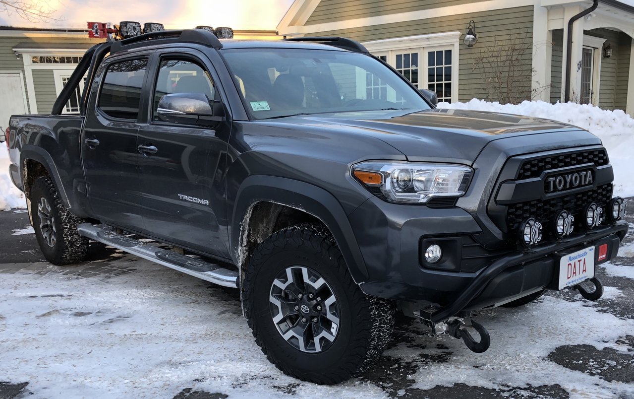

    What’s the story with that front hitch.... I’m kinda digging it, as i have a lightbar right above my bumper so that space is used) But... it looks like it costs you a lot of approach angle? Thoughts???
