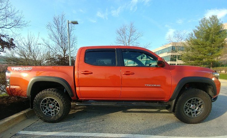

    I'm posting this just to provide you information not to sway your decision either way.
    Last Friday morning I finished installing a 2" rear, 2 ½" front lift on my '17 OR.
    I had put 33's on and was experiencing some very minor rubbing so I thought a lift was needed. After installing the lift the rubbing actually got worse. What fixed the rub issue was asking an alignment shop adjust my caster to move my tire forward about a ½". I probably could have done that before the lift and saved myself about $800 and 7 - 10 hours of work (lift cost).
    Don't get me wrong, I like how my truck looks and drives (after the alignment). Here is a not-so-good picture of my Taco post lift and the list of items that went into the tire/wheel/lift mod.
    255/80-17 COOPER DISCOVERER S/T MAXX 80R R17 TIRE LR E on Toyota FJ Cruiser 2007-2014 TRD Pro SEMA 17" MATTE GRAY Alloy Rims

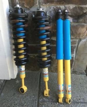

    Gen 3 Tacoma OR Suspension Components

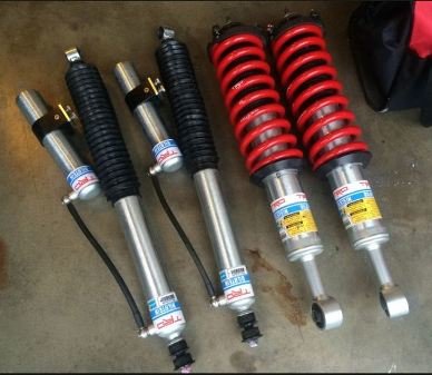

    Gen 2 TRD Pro Suspension
    Shocks are MUCH beefier, heavier springs

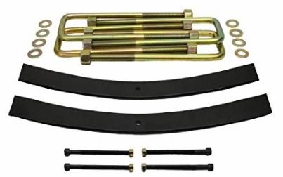

    2" Add-A-Leaf Kit for the rear
    As for the rubbing issue it's funny, some folks throw on 33's with no issues while other, like myself, have a bit of rubbing but this was fixed at an alignment shop.

    You got your pictures backwards.

    and so I do. Thanks for pointing that out.
