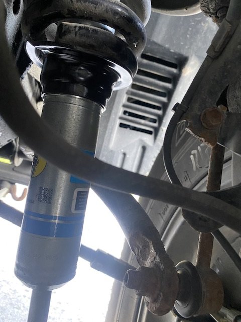

    So I just had billies installed all around. I asked for position 2, or .65” of lift for the front. I can’t tell if they used the correct slot when I look underneath.
    the passenger side looks right, but on drivers side I can’t see the grooves…
    Here are pics of drivers side, passeger side is last pic…

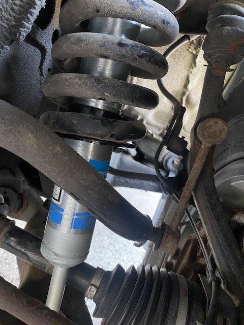

    The spring perch on the passenger side looks like it was installed incorrectly.

    Last pic has perch upside down.

    Lol they installed one perch upside down. Op get that thing back there.

    Not safe to drive. That clip is just waiting to pop off and then your suspension will drop on one side. I would not drive it like that at all.

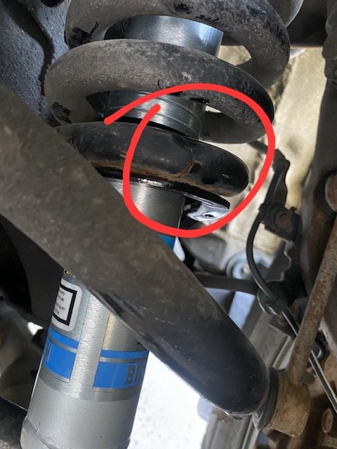

    Also, it looks like your coil spring is cracked. I would highly recommend new springs!!!

    yea.. get that thing back to the shop and DO NOT drive it it... if the circlip fails on the one upside down you'll have a really bad day
