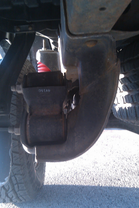

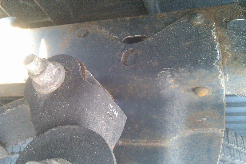

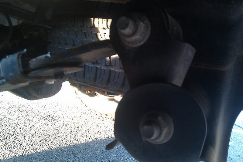

    I have been looking for awhile for a shackle flip for my 5-lug 2nd gen. Like most things 5-lug it either does not exist or is from some unproven source. I then began to expand my search for different shackles not specifically made for my tacoma. Of course nothing. When I searched here at TW i ran across ATO's shackle flip kit and noticed that it was strikingly similar to what I had been looking at on my truck. Here is what the shackle hanger looks like on 2nd gen 5-lugs

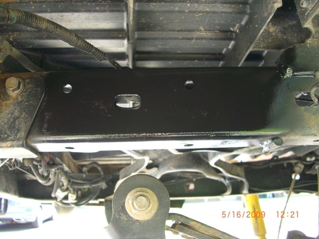

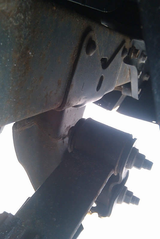

    here are the pics i could find of ATO's 6-lug shackle flip kit.
    left side is before the flip kit is installed, so it's the stock hanger.
    so tacoma world could this be one of the only suspension items on both the 5-lug and 6-lug that when modified have the same desired affect? all the rivets that need to be removed are in the same place.
    if it is then i will be open to ordering a set from ATO and giving it a try on mine...

    Kevin from ATO said "Yup they look the same to me." when I asked him to take a look at the pics. Once he has completed the redesign I plan on buying his shackle flip kit.

    Looks similar, but Im sure there is a slight difference.
    I'd be able to tell more if I could look at it in person.

    there is a chance there are subtle differences and i plan on taking a closer look when i can get a chance to peek at a 6lug.
    are there other angles that would help?

    it is. i started this thread because ATO's shackle flip adds 1/2 of lift and i am interested in buying them but didn't want to if it wouldn't work for me.
